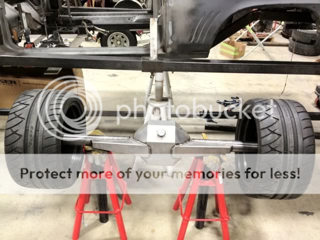

how much travel do you guys run on a pro touring 69 camaro for the rear suspension? I'm trying to set up my rear end right now
Pasquale 12-17-2011 09:53 AM
This is where I am at. I'm mocking up the rear end so I can start to build the triangulated 4 link. I just need to know a common measurement of the amount of travel a car would see on a the road.
http://i548.photobucket.com/albums/i...o/IMG_0552.jpg
http://i548.photobucket.com/albums/i...o/IMG_0554.jpg
http://i548.photobucket.com/albums/i...o/IMG_0555.jpg
http://i548.photobucket.com/albums/i...o/IMG_0573.jpg
http://i548.photobucket.com/albums/i...o/IMG_0580.jpg

In a perfect world, 6". Then you have an inch you can raise or lower the rear for ride height setting & still get by, & would still have 2" of bump or rebound. If you have bumpstops on the shocks, it uses up some bump travel. I like to see 2.5" travel clearence to the bump stop. Many coil over shocks are 5.5" stroke.

Ok then I seem to be pretty close in range. At ride height, the top of my housing is 3 inches from the frame rails. In these pictures, how does it look?
This would be at ride height...
http://i548.photobucket.com/albums/i...o/IMG_0604.jpg
http://i548.photobucket.com/albums/i...o/IMG_0605.jpg
http://i548.photobucket.com/albums/i...o/IMG_0606.jpg

those frame rails seem to be your biggest issue, not sure who's they are. They look they remove a lot of your clearance by the way they are bent. I don't think 3" is anywhere near what is normal. David said 6" ideally and I believe that was at ride height.
David Pozzi 12-18-2011 10:57 AM
I meant 6" total travel bump & rebound, so 3" of available bump travel with maybe .5" more lost to a coil over bump stop, leaving 2.5" bump travel before you hit the bump stop. With shocks behind the axle it translates into a little less travel at the axle centerline due to the motion ratios.
3" at the axle is pretty good. Be sure to check your pinion bumper & driveshaft to tunnel clearence. If your trans is angled down to the rear, it will require the pinion to be angled up the same amount to align it, this can cause the driveshaft to be higher than you might think.
Those frame rails do look like they droop to the rear.

thanks David. I've never had one that close at ride height, but the factory rails are bent completely differently than what he's using.
