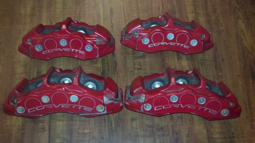

got the calipers! their in good shape but will need some powder coating.
now i need a KORE3 kit to bolt it on my 9"ford.
thanks for the help Tobin:thumbsup:
I will be giving you guys a call in a few days
http://i902.photobucket.com/albums/a...06calipers.jpg
