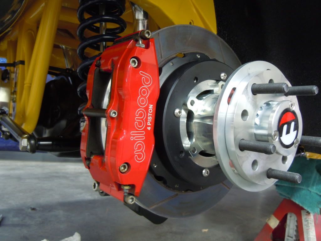

Here is what I did for a parking brake. Took my existing Wilwood hat with the intergal parking brake, machined out the center and attached it to a rotor adapter. Then machined out a bracket that is like a 9 inch flange and attached it to the floater to mount the ebrake/caliper mount.
http://i1138.photobucket.com/albums/...g/DSCN3494.jpg
http://i1138.photobucket.com/albums/.../IMG951212.jpg
http://i1138.photobucket.com/albums/.../IMG959545.jpg
http://i1138.photobucket.com/albums/...g/DSCN3507.jpg
