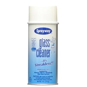

Jeff, do what John said, but then get yourself some SPRAYWAY glass cleaner and go over the whole panel. Sprayway leaves no residue and is a good cleaner in itself. Sprayway can be found at Sam's Club and ACE Hardware.
