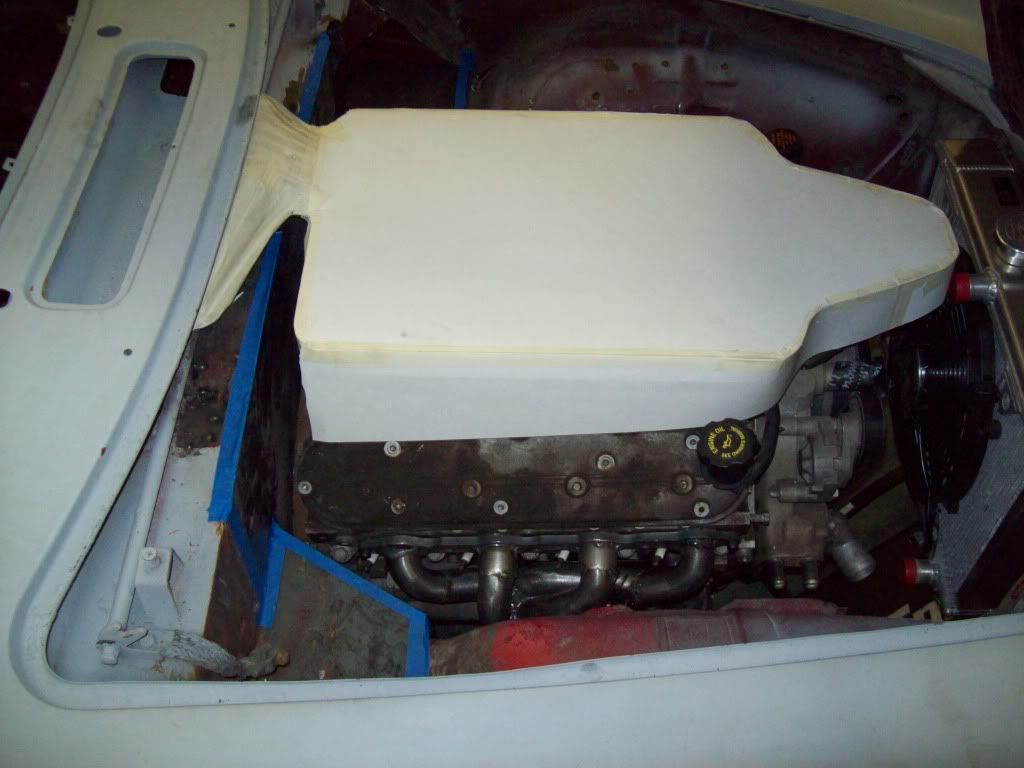

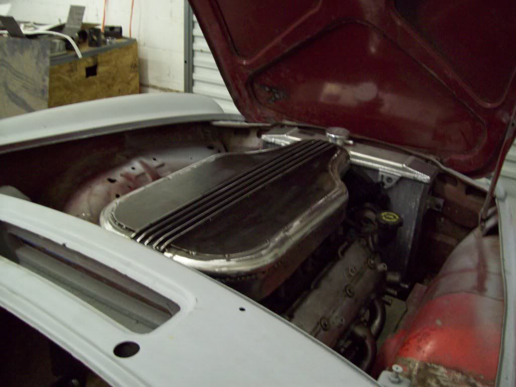

and upgrades, but will appear to factory in appearance. We are going with a 375
horsepower LS1 conversion, with a 5-speed standard transmission.

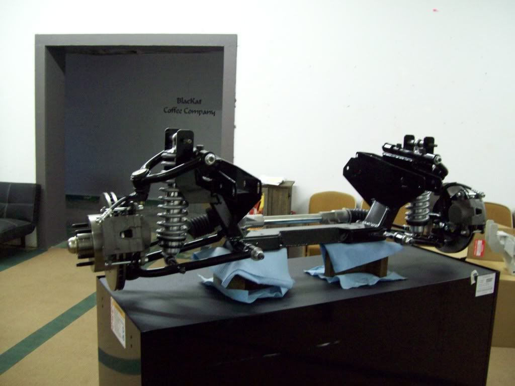

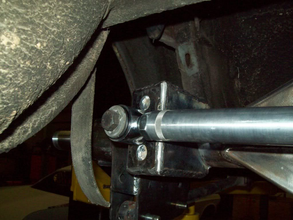

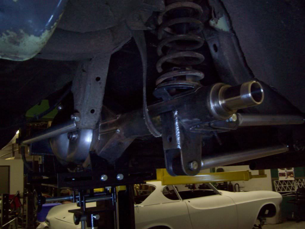

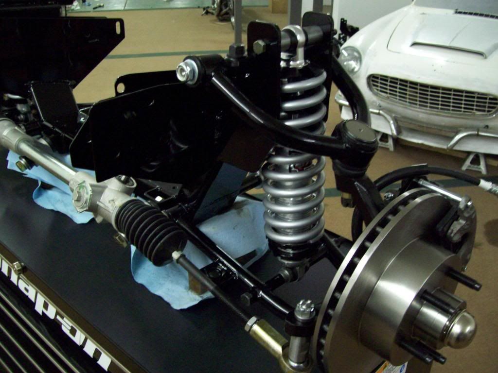

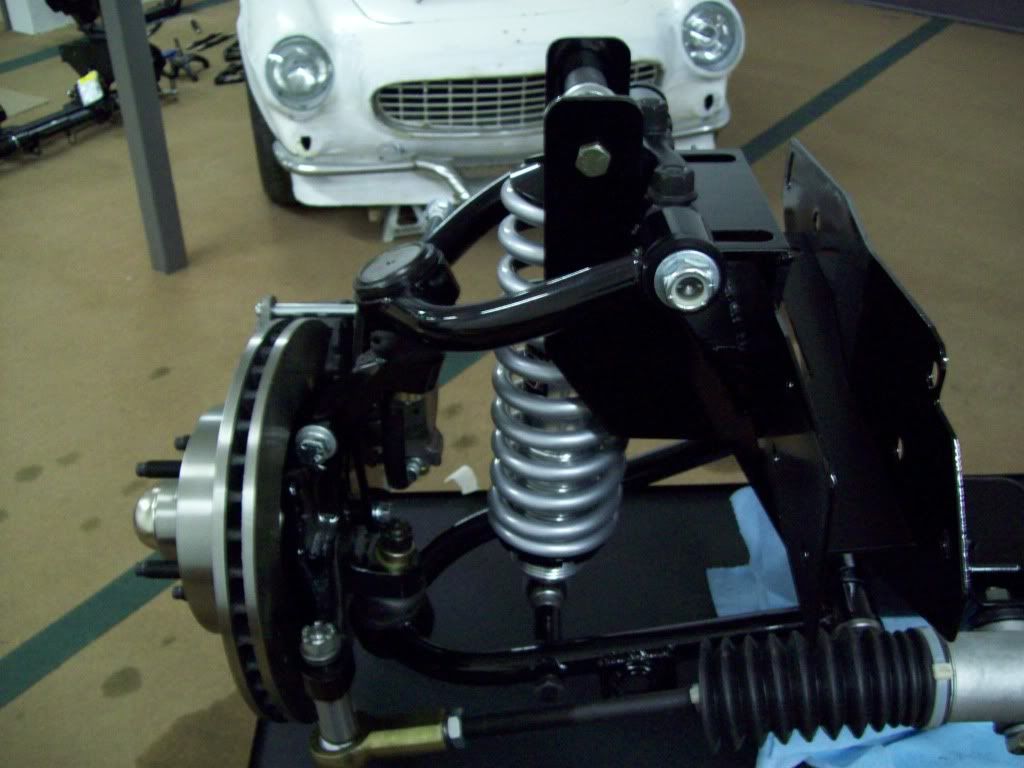

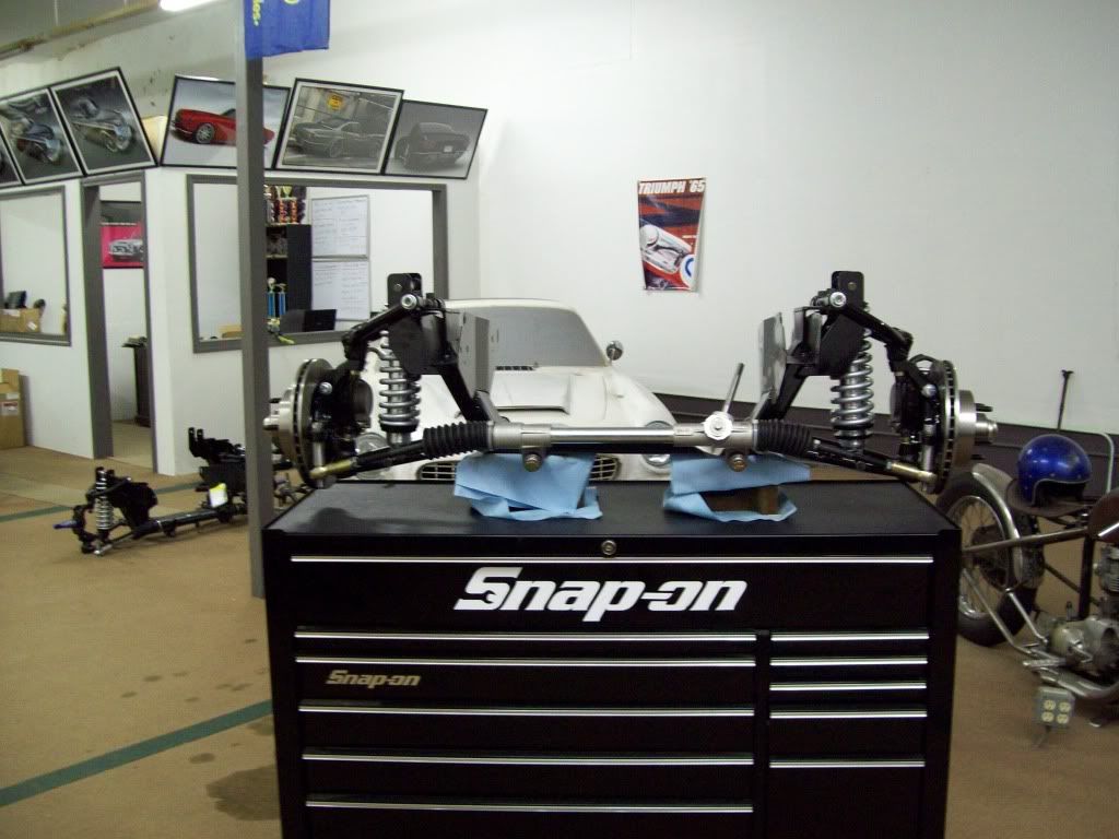

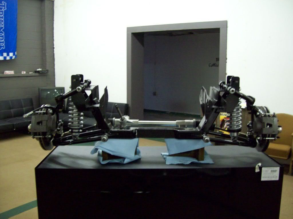

Complete New Design front crossmember/Suspension kit with upgraded brakes, rack
and pinion, adjustable ride height and quality.

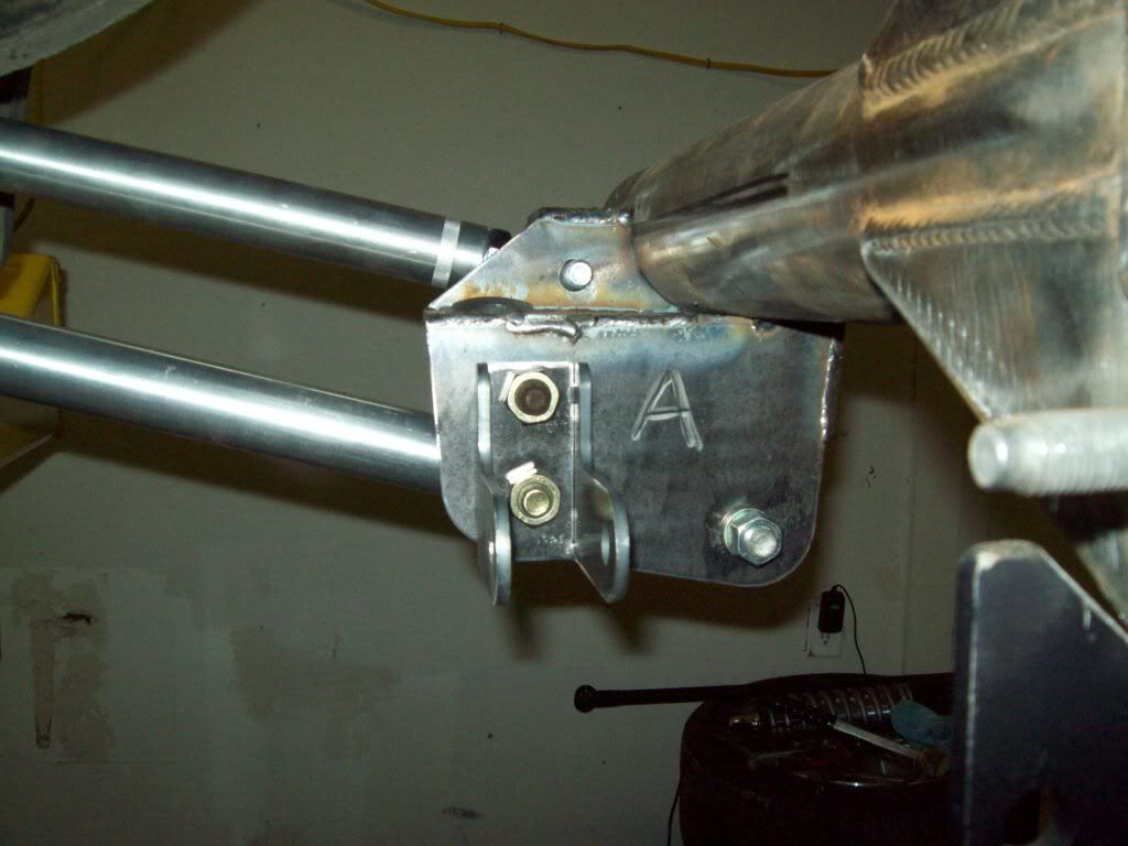

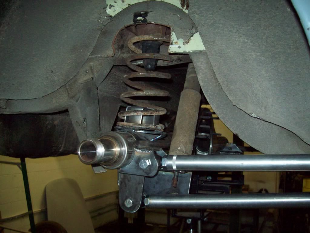

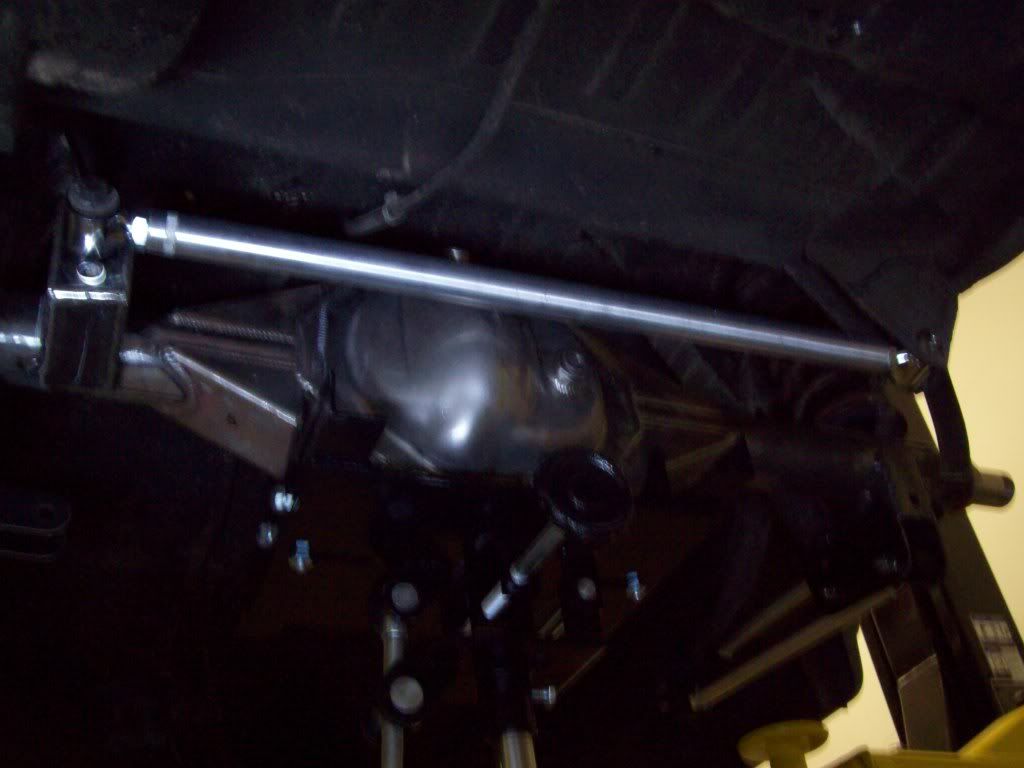

Complete New Designed Rear End Assembly, featuring a Mod-light 9in rear end,
with disc brakes and Adjustable Aluminum 4 link trailing arms and panhard bar.

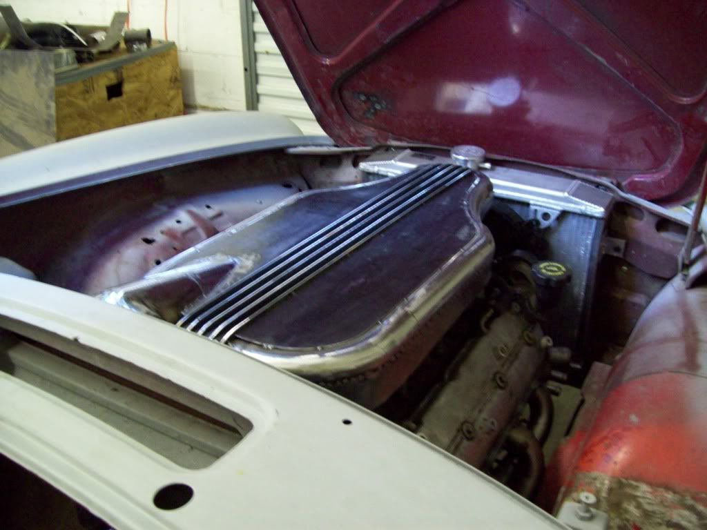

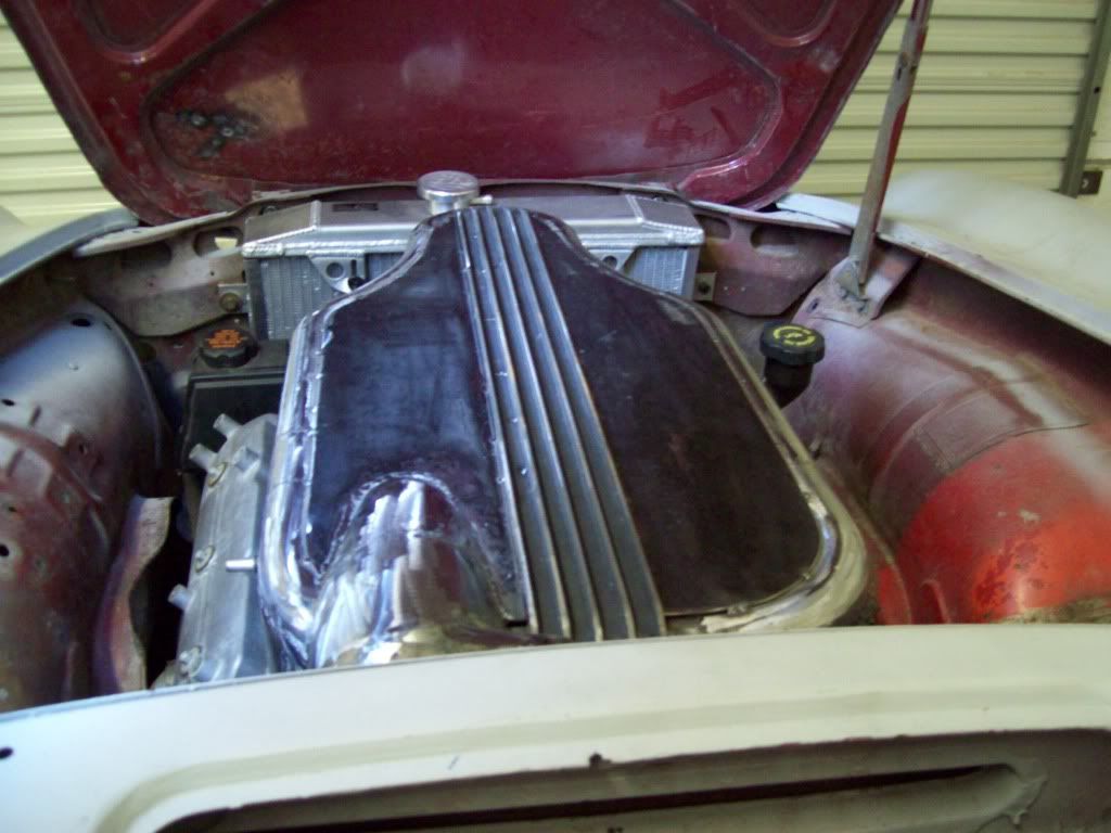

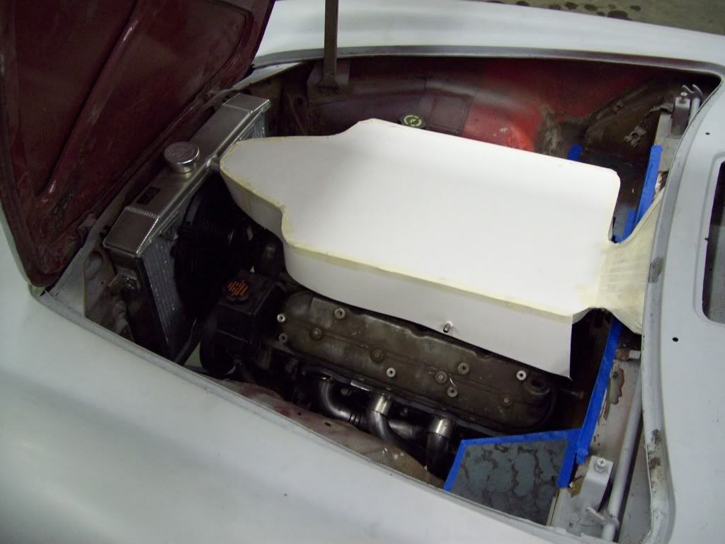

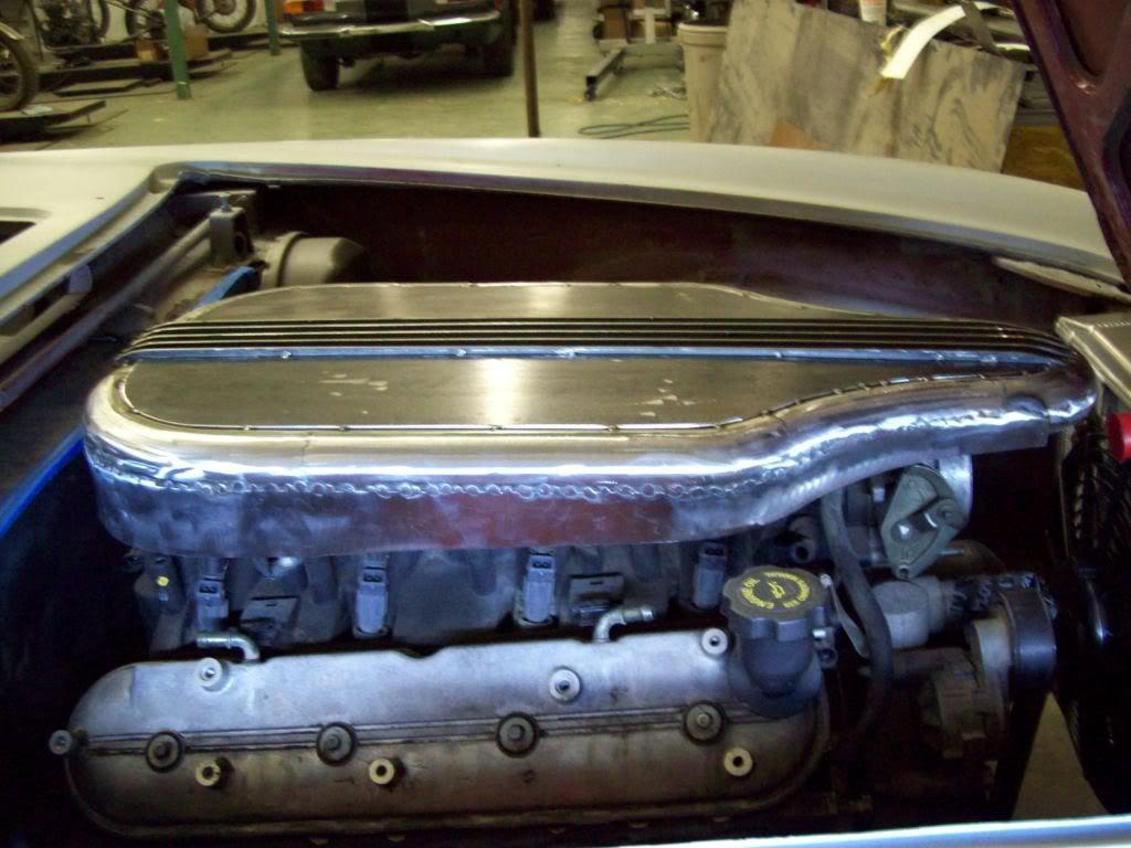

New Crate Performance 375 Horsepower General Motors LS1 featuring, Fuel
Injection, Performance Headers, higher fuel efficency, greater service support
and performance.

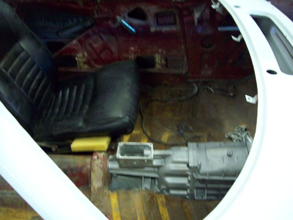

New Keisler RS600 5-speed Standard Transmission, which features a wide variety of gear
ratios, depending on driving specifications and needs of the driver.

Performance all Aluminum Cross Flow Radiator with a direct mount Electric
Cooling Fan Option.. This is being manufactured by BeCool Radiator exclusively
for the Swedish Ops Catalog, and is a direct replacemnt radiator for the
Original Powertrain, or our LS Conversions.

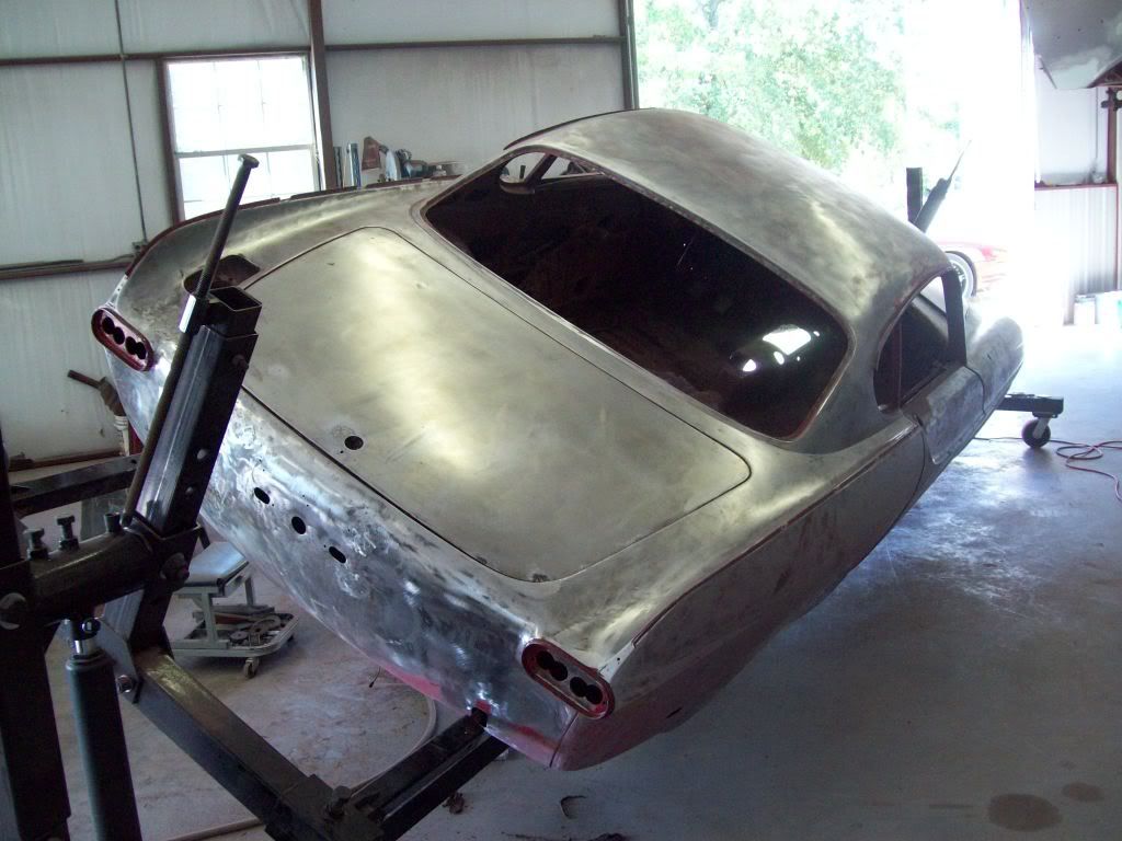

I have been asking about our Body Stipping procedures, and we have different plans of attack on that. It really depends on the car and customer preference.. Soda Blasting, Sand Blasting and Dipping all have Pro's and Cons..
Dipping, is really hard to neautralize the acids in the inner structure and crevises, so I dont do that one at all.
Soda Blasting has some of the same issues as dipping when it comes to neutralization of the soda. Vinegar and Water solution and other solutions will neutralize it, but again it is hard to get it all out.
Sand Blasting is way too harsh if your guy doesnt know what they are doing.. It can generate alot of heat and pressure, which causes warpage. We do blast the hard to get area's like the jambs and window channels.
So if we have a fairily solid car, and the materials on the car arent out of hand, we like to strip it by hand. It is alot more work, but you can avoid alot of potential problems later.. If we see areas that need a bit of extra attention, we will blast those areas for sure. All the window channels, door jambs, inner grill, etc, will be lightly blasted, we just dont like working on large panels with the blasting if it can be avoided. Would rather put a bit more effort in stripping, then cause more work and the need of more materials later.

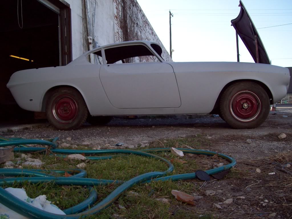

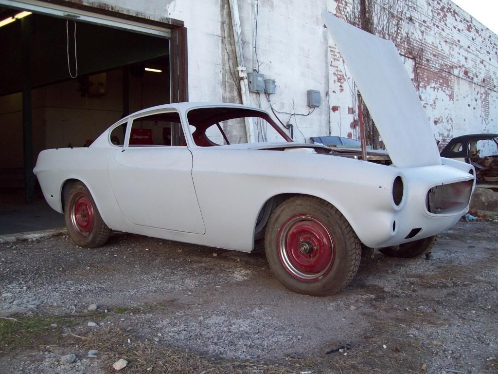

Here are some preliminary naked pics of Saint Marie. Being it is a daily driver, we are not going to completely strip the bottom of the car.. We are going to take off all that is loose, repair any issues, and re-coat the bottom with a newer modern coating..
Of course there are some issues here or there after stripping, but this car is very solid in all the right places.. We had a bit of patch work here or there, but luckily none of it was in any boxed area's, so the back side of the repairs can be sealed up also. After we get all the repair area's tacked in, we will do all the finish welding and grinding to remove any holes are pits.

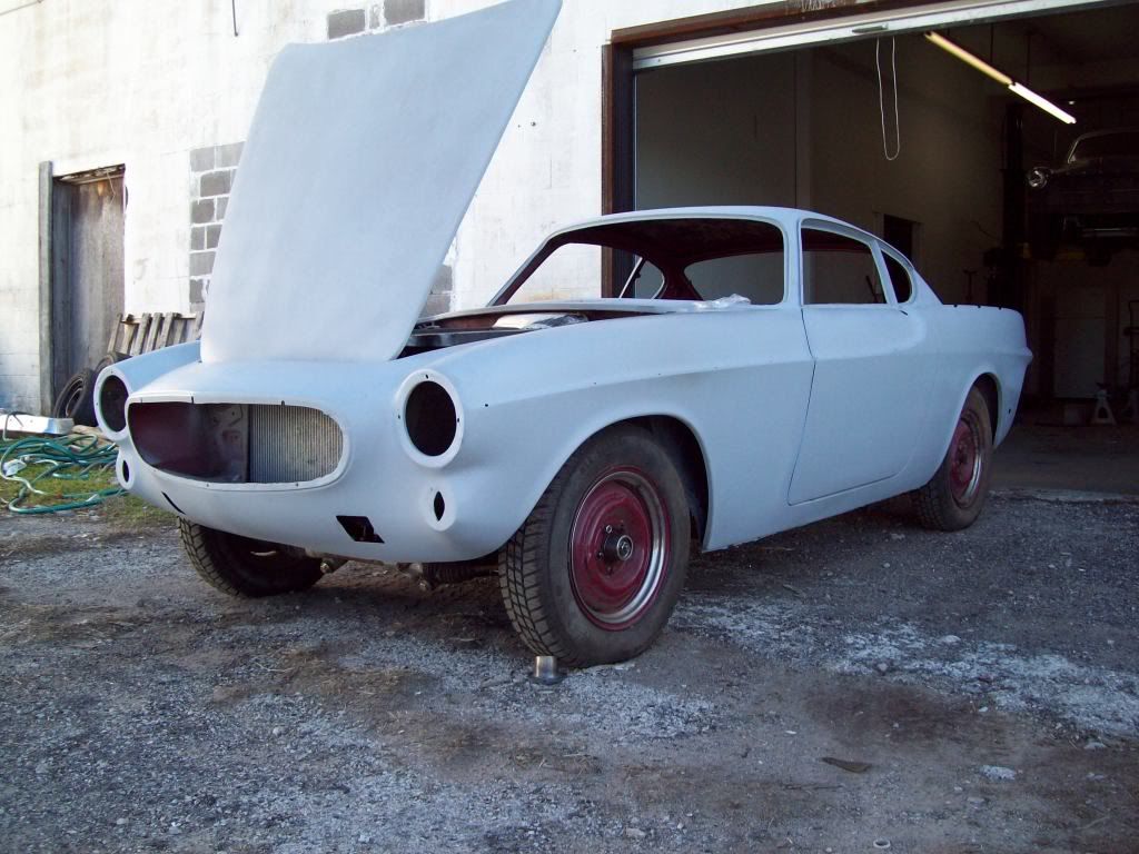

Here are some pictures after the sealer/primer stage before body work begins.. Once you strip one down, any moisture or hand oils will cause corrosion in no time.. Once this starts, it is hard to get it neutralized after it starts, so it is best to get it sealed up as fast as possible.. Sure we will removing some of it as the necessary welding and body work is getting done, but it will quickly be re-sealed..
http://i290.photobucket.com/albums/l...0Marie/018.jpg
http://i290.photobucket.com/albums/l...arie/017-1.jpg
http://i290.photobucket.com/albums/l...arie/016-1.jpg
http://i290.photobucket.com/albums/l...0Marie/021.jpg

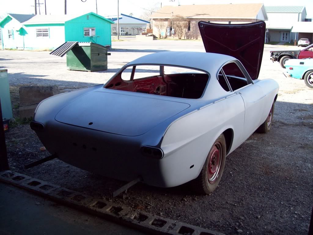

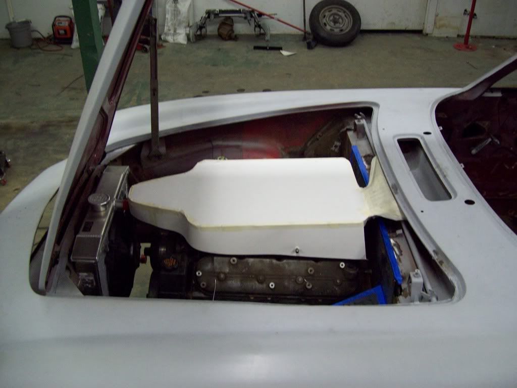

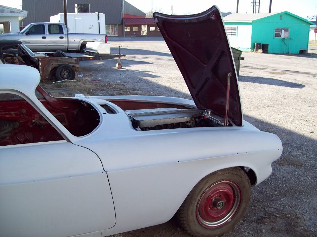

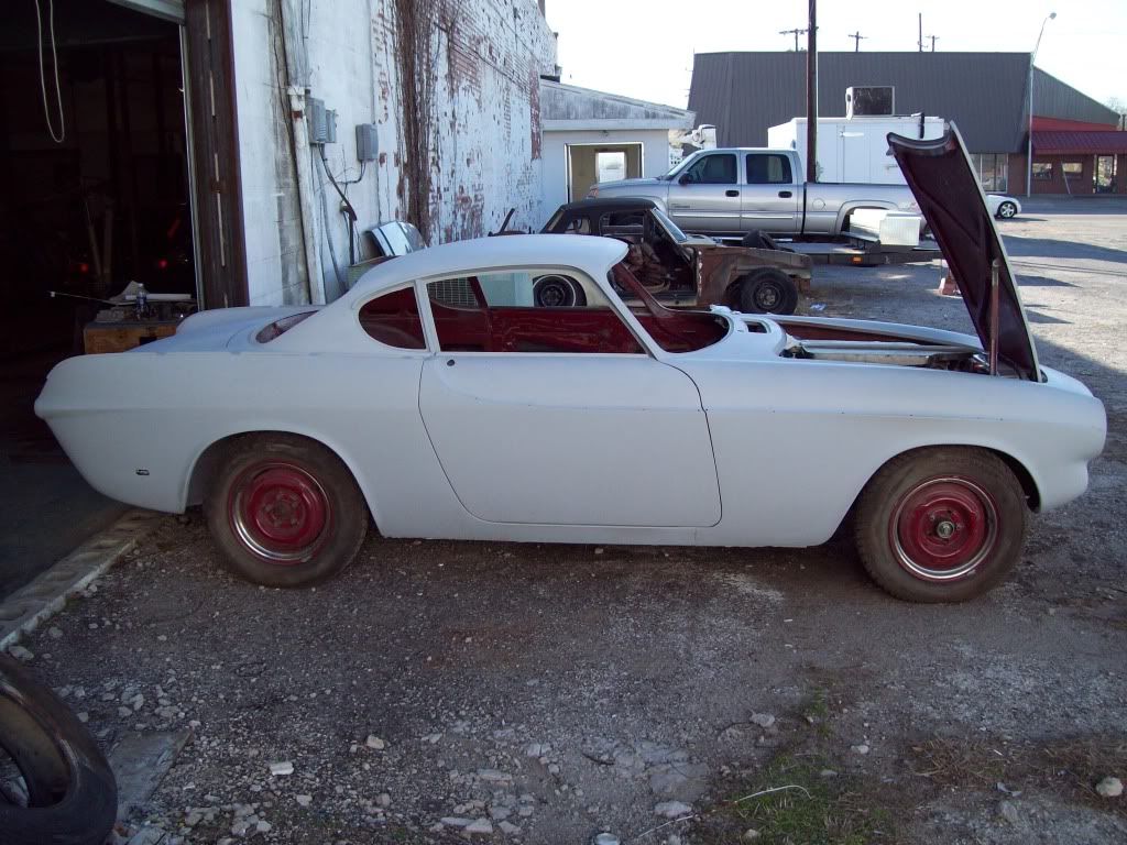

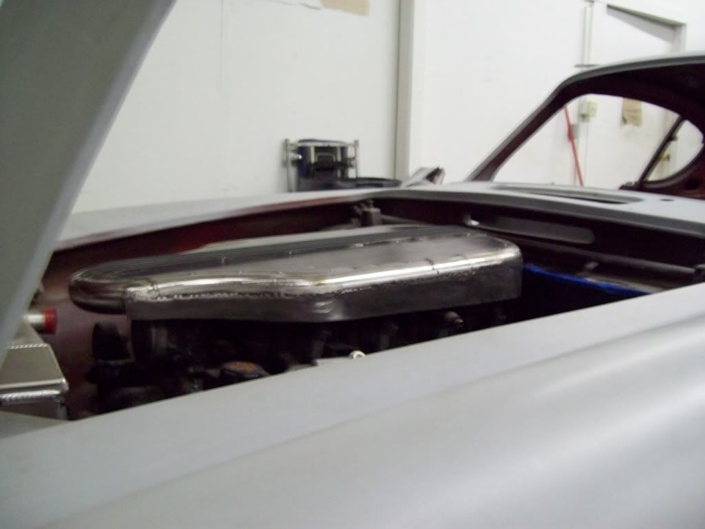

Here is an update on Project Saint Maries body work.. I will have the car back
at my shop for suspension, motor, and trans fitment in the next couple of weeks.
I like to get restorations up to atleast the second parts alignment and blocking
stage before I get to heavy into the other work.. By doing this, you allow time
for the primers, glazes, and sealers to cure out properly while you are doing
other work necessary.. Alot of builders will get all the fab stuff done first,
and get the car running, before they start on the body work.. Then once they are
to that body work stage, they get it done with out necessarily think about cure
time and material shrinkage.
There was alot of hammering and pulling to the body here or there, but it is
much better to get all the low areaa you can get out, rather increase the filler
thickness.. There is really nothing wrong with larger blending patches, versus
thicker smaller patches.. Larger thinner patches will actually flex with the
body and cause no issue.. It isnt until the filler gets past a certain thickness
it loses its flexibility property's and will potential problems.
As you can see in some of the pics, guide coating is very very important. We
will guide coat and prime several times before final blocking, just to ensure
the body lines and panels line up and blend properly. The even during final
blocking, we will guide coat a few more time.. It really helps to find any low
areas, warpage, or imperfections you cant see due to the dull finish of the
primers.. So many times the body work looks great in the primer stage, but once
you add the gloss paint to it, all the imperfections stand at attention.
We will be addressing the bottom of the car and engine bay, once the car has had
all the suspension and drivetrain components fitted. After that is done, the car
goes back to the body shop for final blocking and paint work. Then it will come
back to the shop for final assembly.. Alot of People dont realize, you will
actually build and disassemble the car several times over during the process..
The car will be painted in peices to ensure coverage of all areas..

Iamtheonlyreal1 01-15-2012 08:59 PM
Well, Saint Marie made it the 7 miles back to our shop.. She is really in the 2nd blocking stage right now, but that is the perfect time to do Suspension, Rear End, Drivetriain fitment, along with the rest of the parts fitment like the trim and accessories, etc... While we are doing all of that, the first stages of bodywork and sealers have time to cure out before we add more sealers and primers to be blocked out. The final paint stage will lock in harmful reactions and shrinkage, if you dont give enough breathing time, so it is best to space everything out in the proper order...
We will also be installing the door and trunk weatherstrip, to insure there are no issues with sealing or not letting parts like the trunk fully close for a flush fit.. I am sure we have all seen the cars that had nice body work, but once the weatherstrip is installed, it has panels like the trunk held up too high. I like a true and flush fit, so it worth the time to work with these items before paint... After we sort that out a bit, the door/trunk/hood gaps will be evened out via welding or grinding. I dont think I have seen any of these cars with uniform gaps, but this car will have them, along with flush shutting doors/trunk/hood. There is a bit of work to be done on the lower doors to Rocker Panel gap, but again, we have to wait till the car is on the ground and weatherstrip is in.
http://i290.photobucket.com/albums/l...arie/010-1.jpg

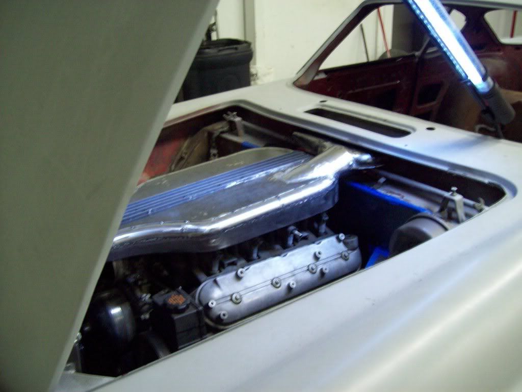

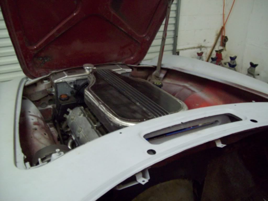

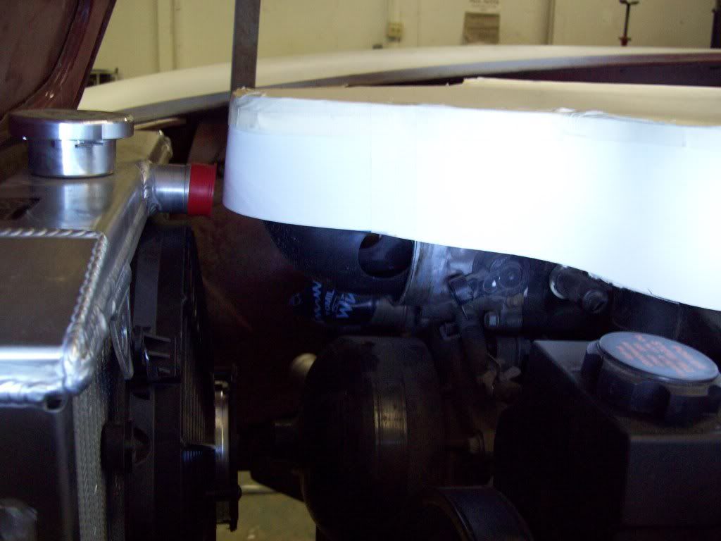

Iamtheonlyreal1 01-15-2012 09:00 PM

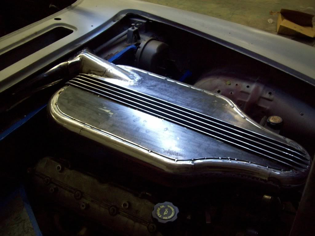

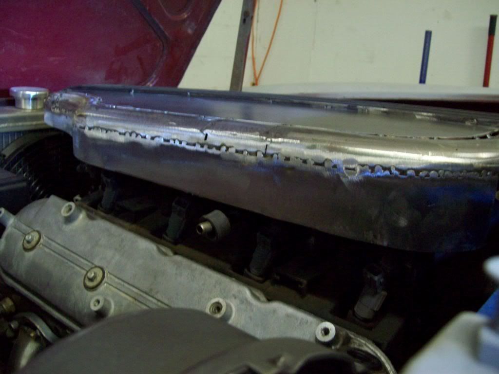

Been a fairly busy day today, I got the Mock Up Ls1 and Keisler Rallye Sport 5-speed in the car today. And made sure we are going to have clearance for the Dual Core Aluminum Radiator and Puller Electric Fans. The motor sits nice and low to ensure the center of gravity wouldnt be affected, but not affect ground clearance. The oil pan actually still sits above the rocker panels, so we should be able to run these things at what ever ride postion we desire.. The transmission also sits nice and tight to the body, so ground clearance there will not be an issue at all. The Motor is also in a position where the performance and handling should be great, and just to be sure, I will have the weight distribution measured before hard weld everything. A half inch here or there can make a difference, and now is the time.
Swedish Ops is working on a pre-fabbed or some sort of easy firewall mod kit for these applications, but I am not sure if we will make them available on the market. We should have them in stock for our Special Builds Department cars, incase someone wants to possible get one.. This would be strictly on a case by case basis...
I still have to set the Drivetrain running angle before I build the LS engine mounts and transmission crossmember. With the drive train in it current position, all the engine service is easy, and you can replace the starter and oil filter with no issues at all. Altenator and the Ac Compressor will drop out the bottom with ease also, so I dont think it is going to get much better than that.. I still have a couple of things to sort out, but all and all, it looks like it is going to come together and service nicely.
Please keep in mind, these are the preliminary rough in pictures, nothing is finished out or dialed in.. Yes, I know the radiator is too high, I put it there to ensure I have electric fan to water pump clearance no matter the engine position.
Also, this is not the actual motor being used, we have a New Crate LS1 for the build, but I like to keep them clean for final assembly, that is why we use a fully accesssorized take out motor for mock up. Just wait until you guys see the engine and engine department covers Swedish Ops (Special Builds Division) will be using to clean and updated everything under the hood.

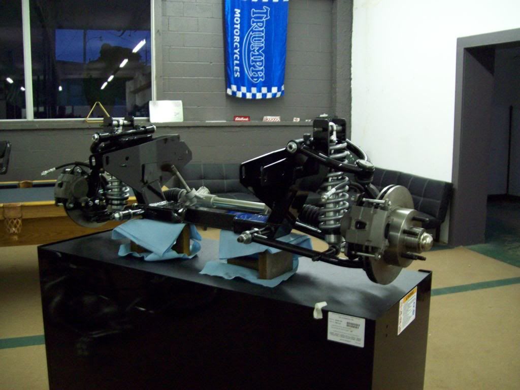

Here is a version of the Swedish Ops Front End Kit that this build will be getting, I will have Paul finalize the color combination after set up is completed.. This is a base kit with the standard 11 inch brakes and powder coating option. The Powder Coating option has alot of colors and combinations possible, so there really isnt a limit to your custom application This kit comes fully assembled as pictured above, so the guess work is gone. We have alot of options with brake upgrades up to the 14 inch Wilwood pictured above, along with coil over options, steering options (Power, Non Power, LHD or RHD), etc.. The Adustable Bumpster is standard on all of our kits, which offers specific dial ins if desired.
We have gone through the trouble to make our own custom washers and hardware, because I didnt want the bargain bin washers that dont fit properly. I like things to be proportional, and other kits I have ordered supplied generic washers that were not proportional to the bushings or application..

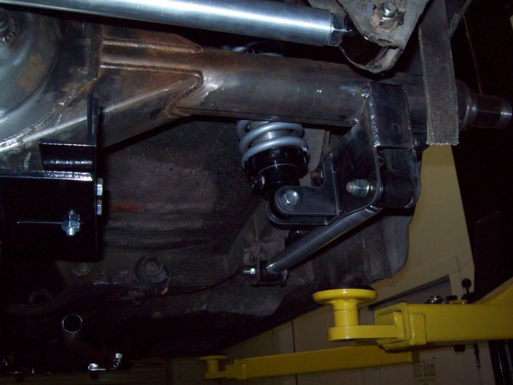

Iamtheonlyreal1 01-15-2012 09:02 PM

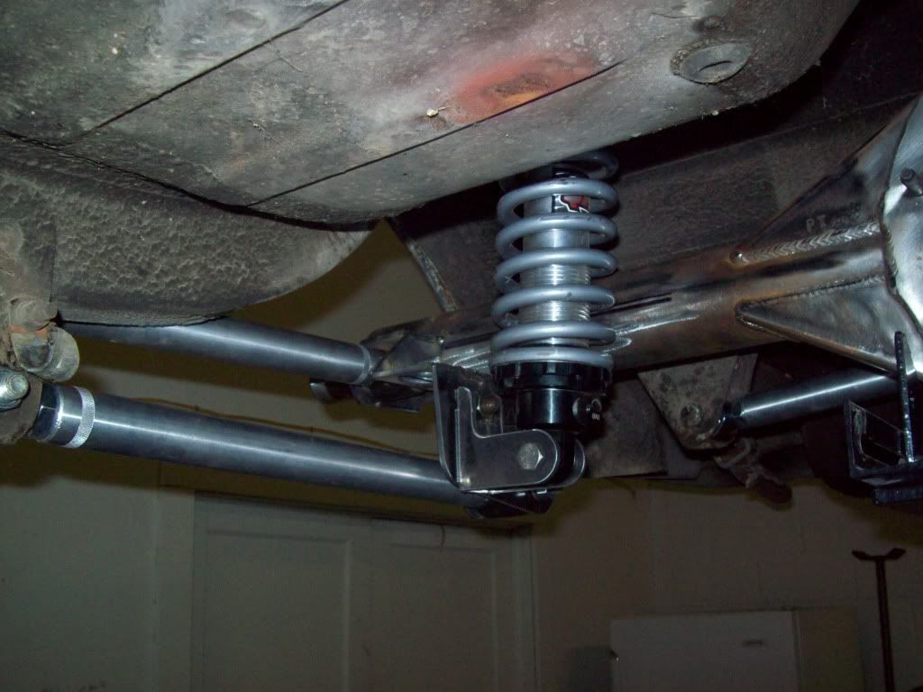

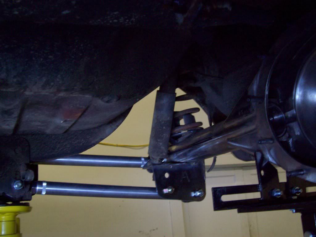

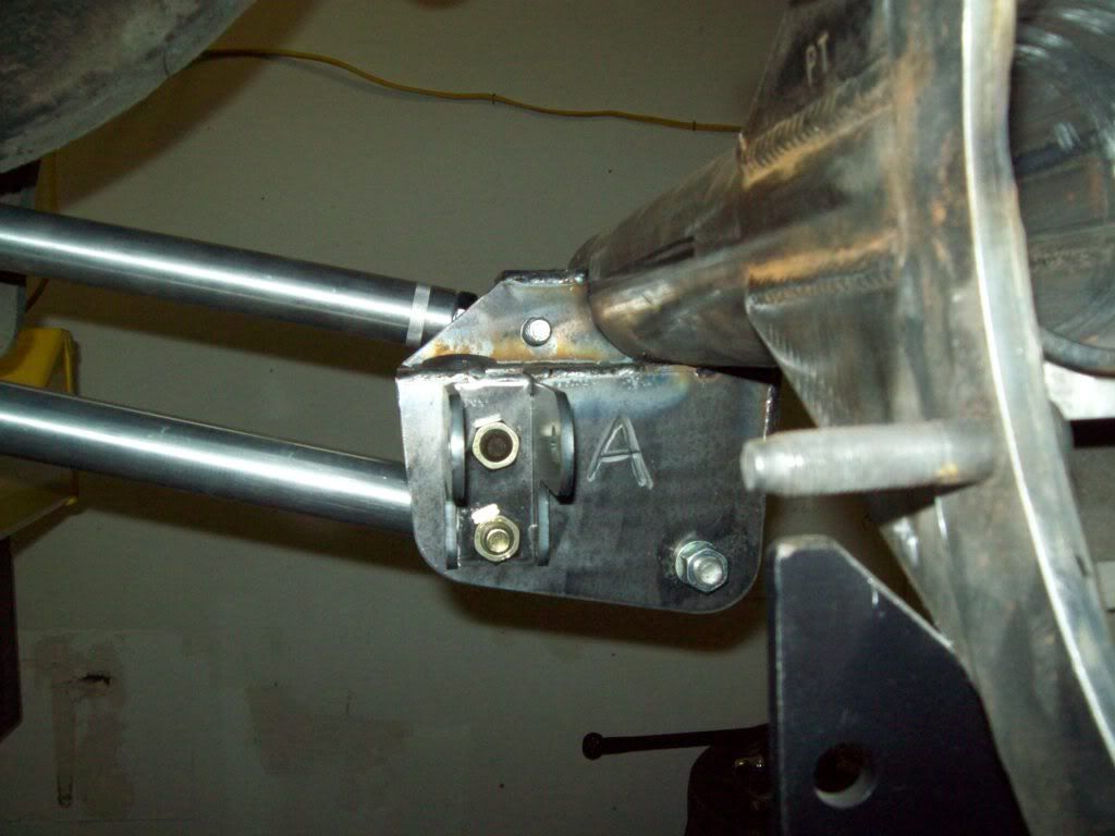

Here are a few pictures of the Swedish Ops universal rear end assemblies.. These rear ends will bolt directly to your Early or Late P1800/Amazon with no body mods or cutting. You also have the widest range of gear ratio and traction options possible, along with 11 inch rear disc brakes which is upgradable to a 12.19 inch, 13 inch, and 14 inch option.
It is fully capable of using your factory coil spring, along with the factory style shocks, but has a rear coil over conversion option for a wider range of adjustment.. With the coil over conversion option, you have a wide range of Spring Rate Options and Coil Over Ride Dampening and Rebound Control settings for precision set up to your preferences.. Also with the coil over conversion option, you have multiple Quick Adjust Ride Hieght Positions from stock to 5 inch drop capability, while allowing the rear axle to sit in the proper alignment position at any range. This constant axle postion is possible due to the Aluminum Adjustable Rear Trailing Arms/Panhard Bar, because it allows a quick turnbuckle style adjustment to set the rear ends postion from right to left, front to rear, along with pinion angle.
The rear coil over conversion kit is made to work with the factory Volvo rear axle assemblies also..It is all a direct bolt on with no cutting. The previous owner cut the spring pockets on the outside, so that is not necessary at all.. In order to get the full adjustablility of the rear end, and proper alignment for lowered car, you have to use the Adjustable Aluminum Trailing Arms/Panhard Bar.
If you look at the pictures also, you will see that 3 different possible mounting position for the Panhard bar on the rear axle, this allows you to keep the optimum bar postion in all the ride height positions.

Here are some pics of some of the quick adjustability features this axle assembly comes standard with. 3 different mount postions for the Rear Panhard Bar, and 2 rear axle drop for the Coil Over option.. There is another 3 inch of adjustment for the rear ride hieght built onto the Coil Over Mounting cross bar that give you a range of adjustment from stock to a 5 inch drop at 1 inch increments.

Iamtheonlyreal1 01-15-2012 09:03 PM
Here are some preliminary pics of the Swedish Ops rear coil over conversion kit we will be using on this build and others we have going on also.. We are adding a Punch Hole finish plate to the bottom opening near the spring pockets, and few other asthetic features, along with finish grinding and full powder coating. This is a bolt in bar that transfers ALL the LOAD back to the original spring pockets.. It is self centering, and will bolt in with out removing the rear axle. We have the Bolt On adapter brackets to convert your original Volvo rear end coil over to accept the coil over mounting..
This bar give your P1800/Amazon up to 5 inches of incremental ride height settings, from stock to an extreme lowered position. You also have quick adjust ride sensitivity and stiffness settings, with a twist of a knob. We have about unlimited spring load and rate options, so no more settling on what you are looking for in ride height or ride quality. You have the same ride potential at any ride height you choose.
The rear end pictured, is the Swedish Ops Universal Direct Bolt In rear end. It comes with all the gear ratio and traction options you can ever need, along with a disc brake range of 11in to 14 inch rotors and up to 6 piston Calipers. The aluminum adjustable trailing arms/panhard bar allows you to keep your proper rear end alignment and and pinion angles, no matter the ride height setting.. Another unique feature to this rear end is, it comes in a 54in, 55in, and 56in track width, which will allow you to use a wider variety of common wheels and offsets with out spacers.

Here are a few pics with the unit out of the car, you should be able to see how it works.
