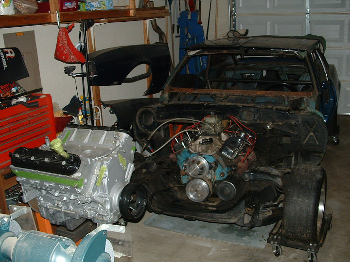

That's the goal...here's where we are today...
https://lh5.googleusercontent.com/-l...%252520004.jpg
https://lh3.googleusercontent.com/-F...0/DSC00051.JPG
https://lh5.googleusercontent.com/-v...0/DSC00053.JPG
https://lh5.googleusercontent.com/-w...%252520007.jpg
The plan is:
SpeedTech Upper and Lowers, QA1's, and 1 1/8 hollow Sway Bar
Willwood 12.19 CD/SL 4-pistons all the way around
Keep the stock steering...maybe considering a Lee box...Opinions???
Brushed 17x8 and 17x10 or 11 Lateral G's or Rushforth Livewires...Havent really decided yet...even still considering 18's but just not sure if the size is worth the extra cost. 10 or 11 decision is mainly on whether or not I want to mini-tub the car. I feel like I almost have to in order to get the 305 or 315 "tucked" look that I want.
The engine on the stand is an LQ9 out of an '02 Escalade. I also have a fresh 4L60 ready to go. Eventually, I'd love to put some dishes in it, slap some twins on it and really go nuts, but for right now I just plan to put the TSP 233/239 Cam kit in the engine and leave everything else stock. From what I have seen and what TSP tells me, I should be able to get around 400 rwhp and 380-400 rwtq with a good tune. I have the factory computer that has already been "universalized". I have read a lot about the stock LQ9 intake not fitting under our hoods...but the measurements I have taken show that it should fit under a 3.5" cowl hood. Obviously, I wont know for sure until I can mock it up, but I cant see how it wont fit. I totally get that the LS6 intake looks a million times cooler and cleaner, but I cant justify spending the money for an intake, rails, TB, Injectors, plus all the accessory relocation stuff when the stock intake makes more power than all but the LSX-R.
