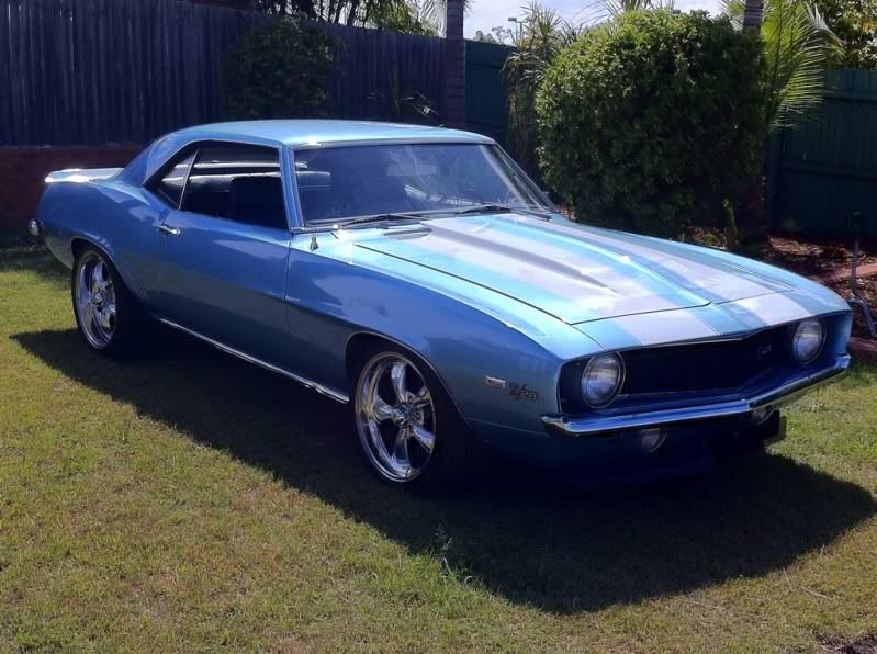

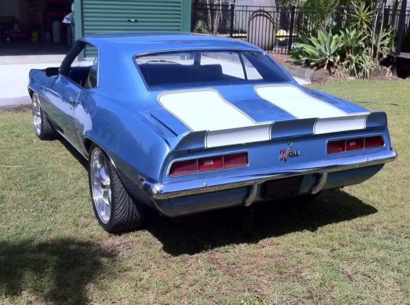

After getting my new acquisition, 69 Camaro, on the road I have noted that the tyre is rubbing on the inner wheel well when under side loading, specifically the inside rear wheel.

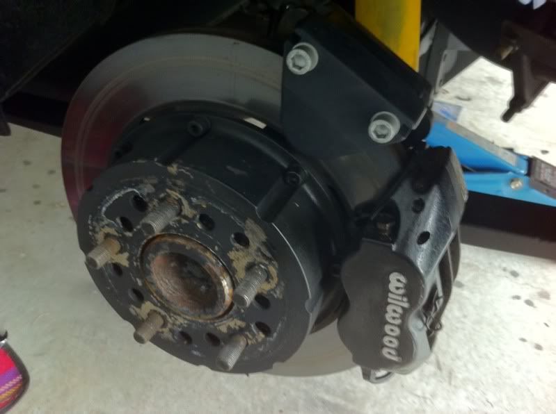

The rear set up consists of what I believe is a standard width diff, Wilwood rear disk brakes, AR Torq thrust 20x8 (zero offset) 4.5" back space with 255/35/20. The track measures up at approximately (tape measure) 61 inches. not sure if the disk brake change on the rear has changed the track width significantly?
There is no visible sign of rubbing on the tyre however, there is some "polishing"of the inner wheel well. It sounds more of a short squeak than a heavy impact or lock up.

OZ Duster 02-21-2012 02:01 AM
Offset maximum on 69 camaro
After a number of checks to the rear suspension I believe the rubbing issues are the Wilwood disk brakes. The rear track has been increased by one inch over stock to 61" and has resulted in the rubbing on the guard lip. I can get a wheel I like in 17 x 8 with an ET of +15mm which will allow me to tuck the wheel up in the rear (compensating for the increased track). The Same wheel on the front will result in a ~ 5" back space, the current 18x8 ET 0 (4.5" backspace) appears to have ample clearance all round. Is this acceptable on a 1969 camaro with Wilwood disks?
