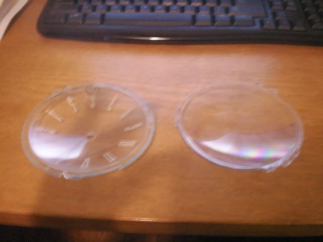

novanutcase 01-28-2012 07:08 PM
Depending on the shape, it's fairly easy to make lenses. I made one for an old T-Bird I had.
I used a bowling ball as a form:
http://i56.photobucket.com/albums/g1...PICT0003-7.jpg
