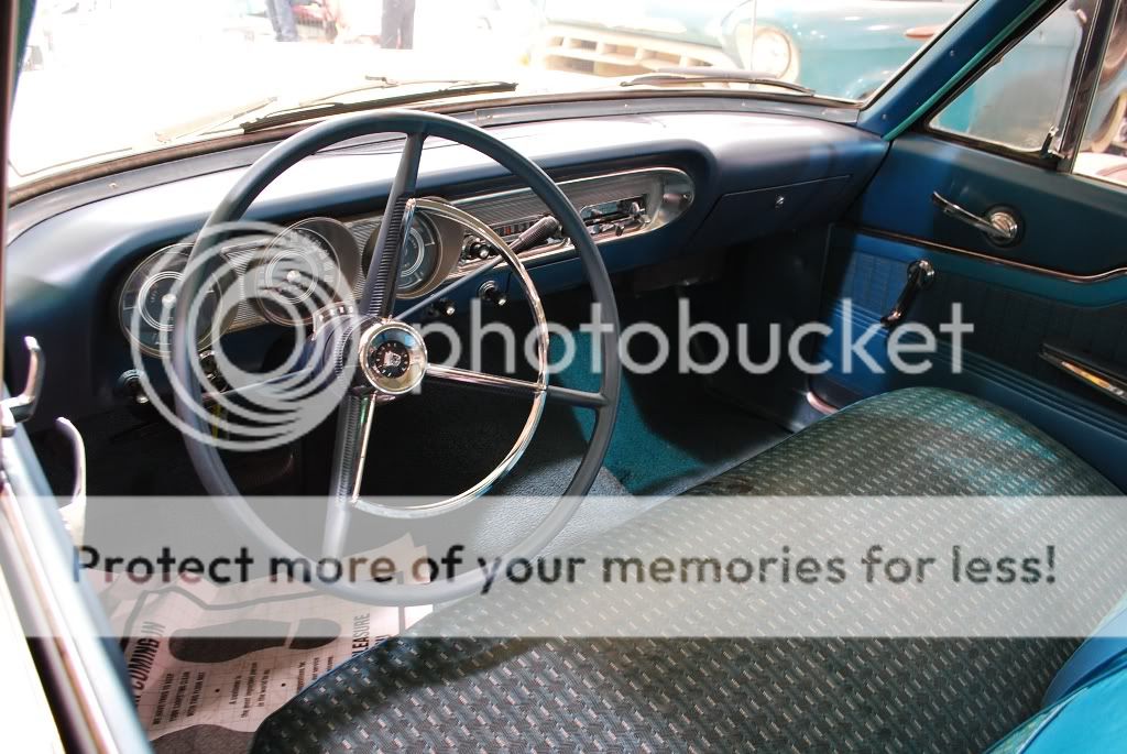

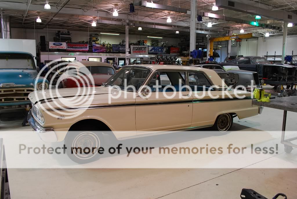

As the car showed up:
http://i563.photobucket.com/albums/s...ture219811.jpg
http://i563.photobucket.com/albums/s...ture219820.jpg

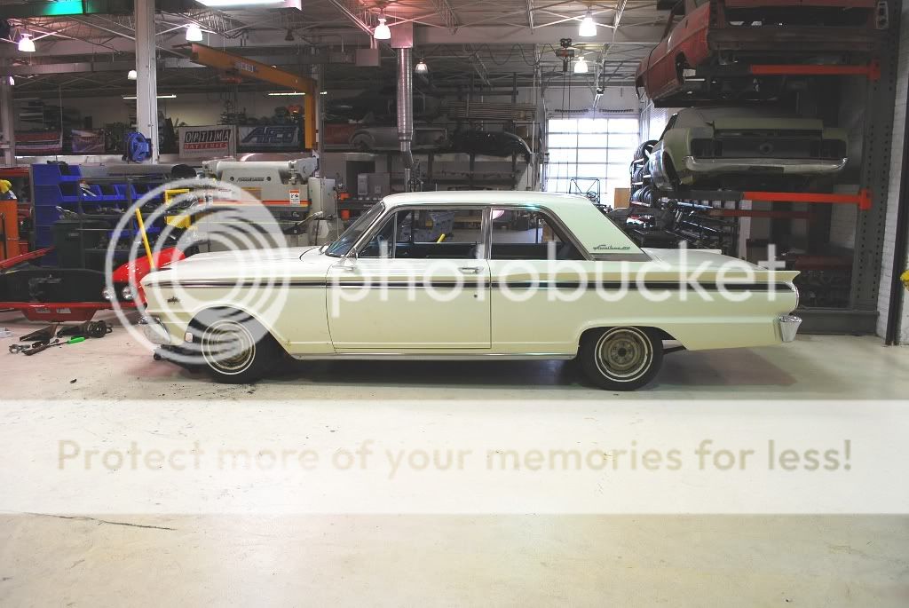

After removing the coils we played with a lot of ride heights until we got one that the owner was happy with. (the version that we were happy with was abut 4 inches lower! As the owner put it, "if it was up to you young guys every car would be so low you couldn't drive it")
http://i563.photobucket.com/albums/s...ideHeight2.jpg

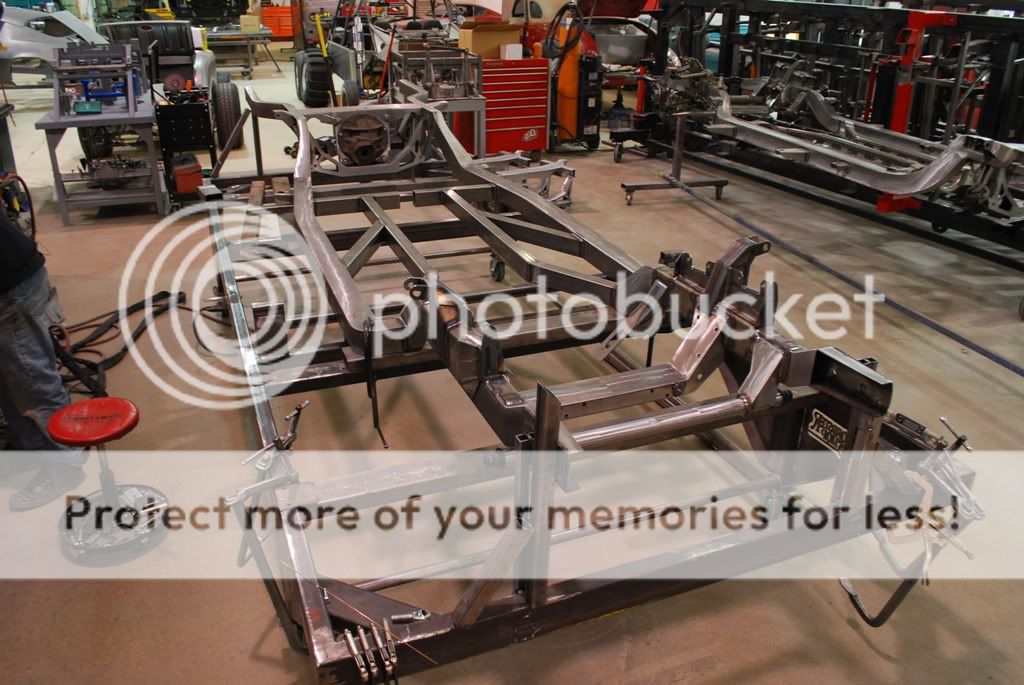

The car was disassembled and the chassis was designed and built for the car with our Fast Track IFS and IRS
http://i563.photobucket.com/albums/s...ture220548.jpg

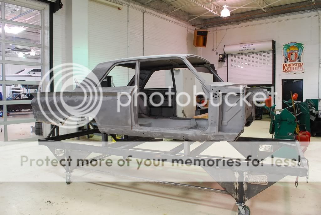

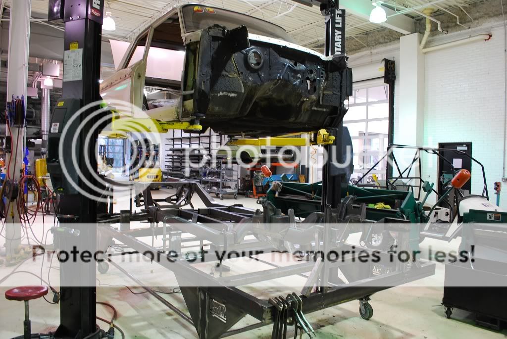

Test fitting the body on the chassis before it gets sent out to be media blasted.
http://i563.photobucket.com/albums/s...ture220498.jpg

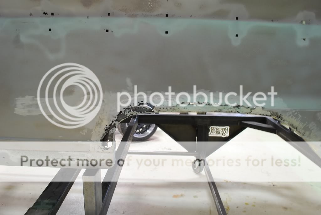

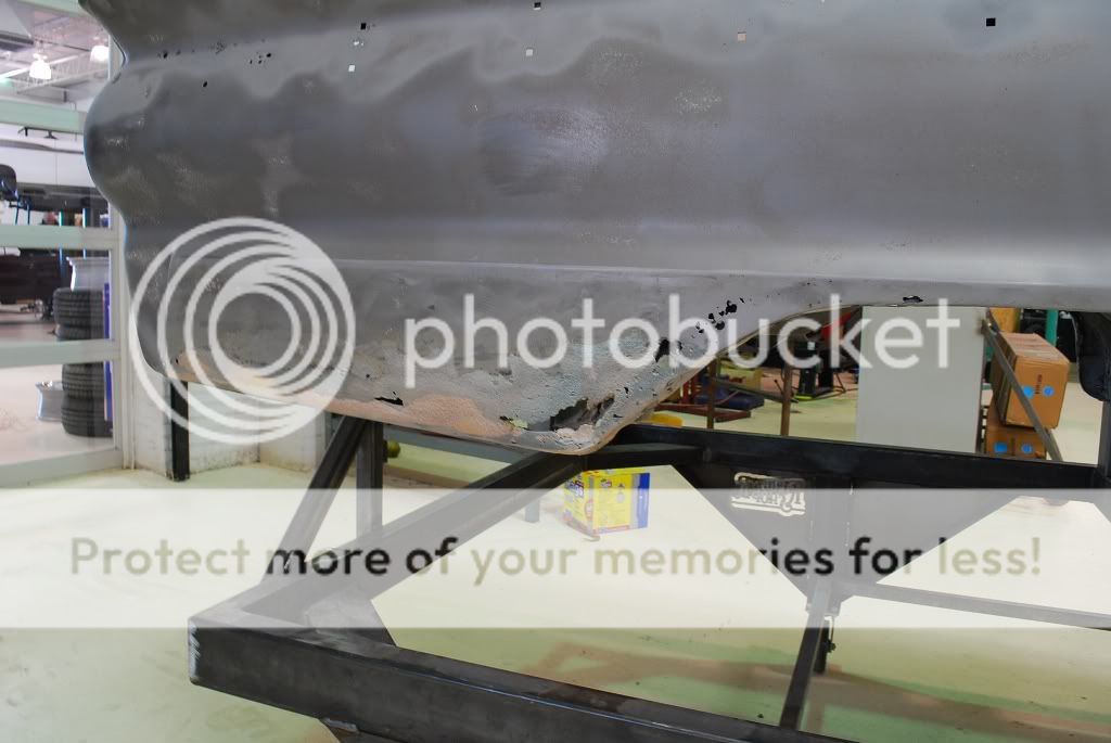

The body came back from media blaster with all kinds of surprises!
http://i563.photobucket.com/albums/s...ture221208.jpg
http://i563.photobucket.com/albums/s...ture221210.jpg
http://i563.photobucket.com/albums/s...ture221214.jpg

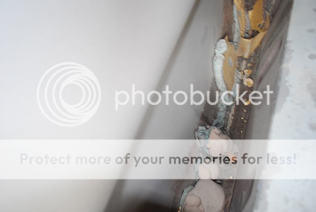

A shot down into the bottom of the quarter revealed some real "custom" work. A true "specialist" must have been the one to originally restore this car. The bottom of the quarter was "constructed" from cardboard, spray foam, wire mesh, and a whole lot of bondo!
http://i563.photobucket.com/albums/s...ture221177.jpg

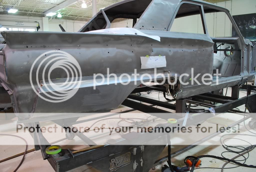

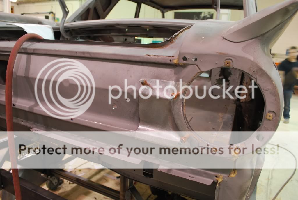

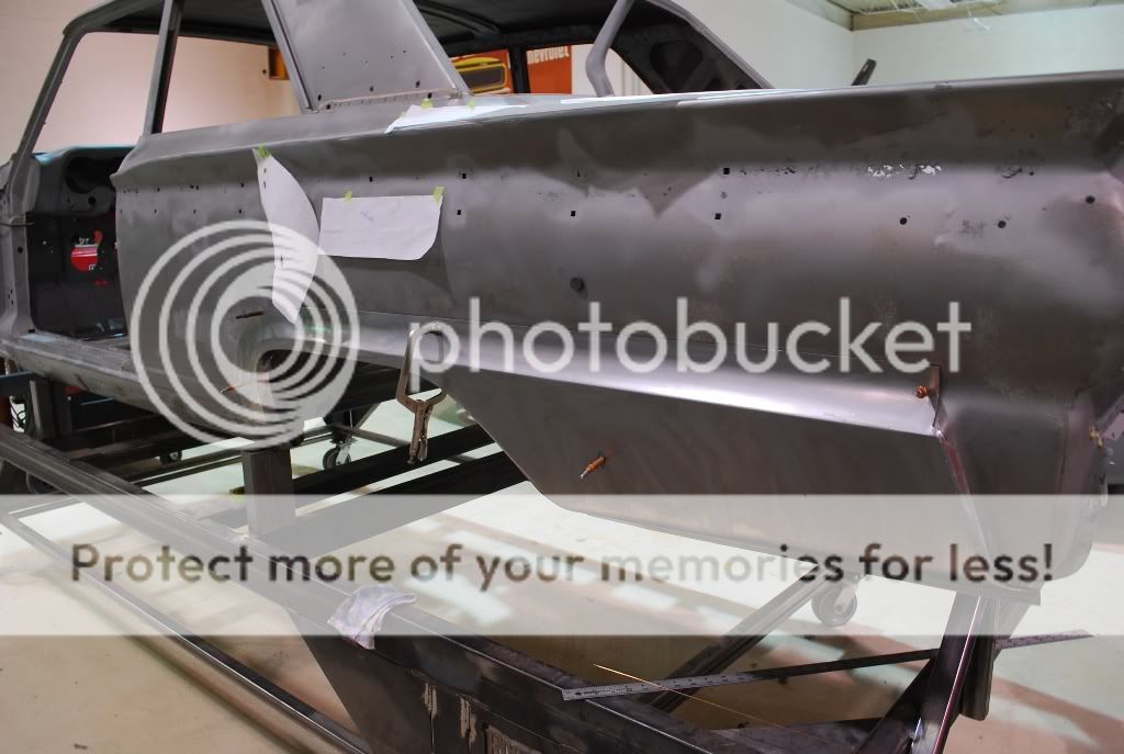

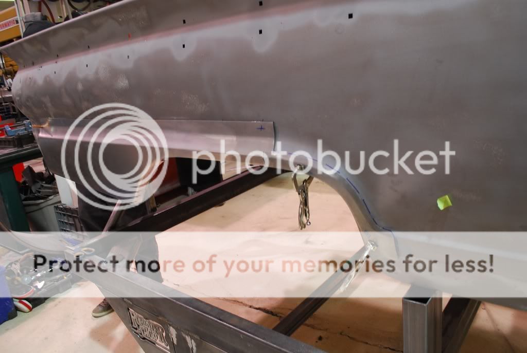

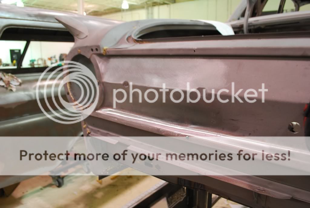

Beginning of the sheetmetal work. Since Fairlanes aren't all that popular, there literally isn't a single sheet metal replacement panel available. So everything had to be fabbed from scratch.
http://i563.photobucket.com/albums/s...ture221300.jpg
http://i563.photobucket.com/albums/s...ture221329.jpg
http://i563.photobucket.com/albums/s...ture221330.jpg
http://i563.photobucket.com/albums/s...ture221361.jpg
http://i563.photobucket.com/albums/s...ture221362.jpg

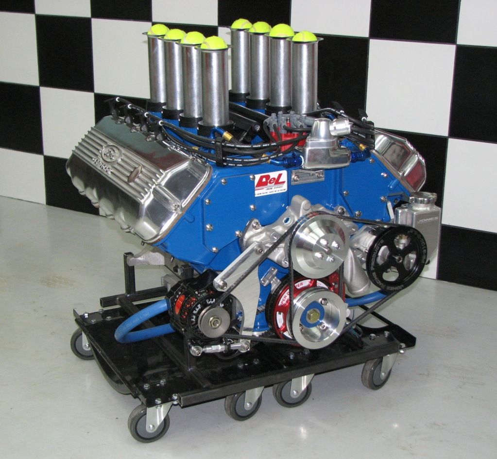

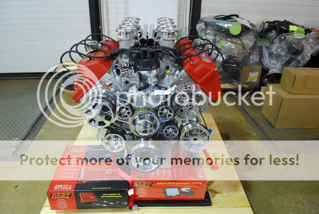

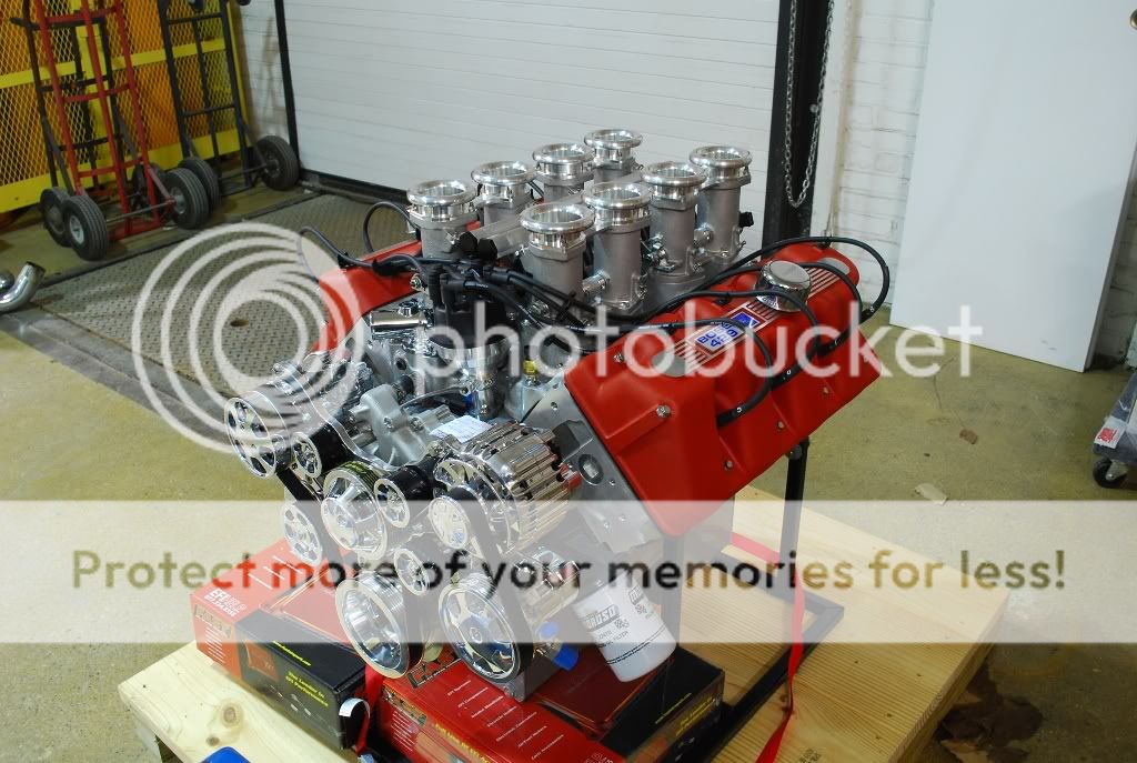

And then this showed up....
http://i563.photobucket.com/albums/s...ture221381.jpg
http://i563.photobucket.com/albums/s...ture221383.jpg
