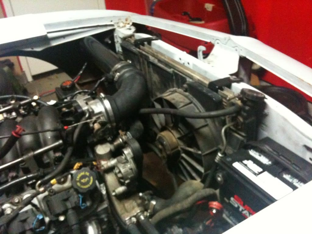

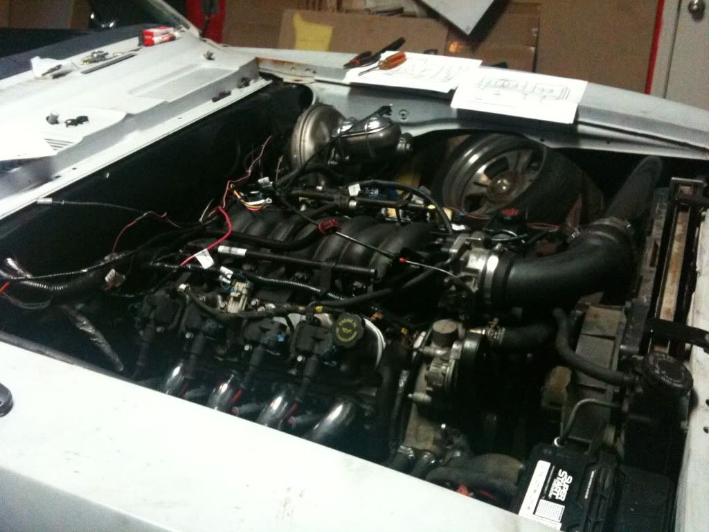

geberhard 07-03-2012 08:38 AM
Let me know if this helps (in progress shots)
http://i122.photobucket.com/albums/o.../cars003-6.jpg
http://i122.photobucket.com/albums/o...maroengine.jpg
http://i122.photobucket.com/albums/o...ndradiator.jpg
