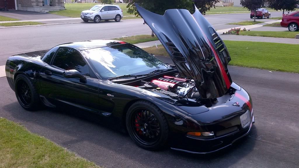

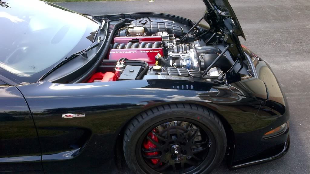

Wish us luck. We are leaving early tomorrow morning, driving about 300 miles one way to have my friends c5 blown z06 corvette dyno tuned and then driving it back home (fingers crossed). Last time it made around 780hp to the wheels but the fuel pumps couldn't keep up. This time he's shooting for over 800. Thought some of you guys may like to take a peek at his car.

I recognize that car......

403ci A&A Corvettes Forged and Stroked Aluminum Block LS2 Motor
4.005" bore 4.00 stroke
Solid Stainless Valves made by “SI”
-14cc Dish Forged Manley Pistons
Forged Eagle Crank
Skat Forged 6.125 rods
Hellfire Rings
ARP Main Studs
Clevite Bearings
Ported Oil Pump
Patriot Dual Springs
Comp Cams Cromolly Hardened Pushrods
RPM Motors Inc CHE Modified Rockers
Custom ground blower Comp Cams 214-226/259-269-115 LSA
Roll Master Double Timing Chain & Gears
9.6:1 Compression
Edelbrock Aluminum 215cc CNC milled by West Coast Racing Cylinder Heads 74cc
Innovators West Custom 8” Balancer SFI SPEC 18.1
A&A Billet Aluminum MAF Scattershield
all fed by a Vortech YSI @ 17lbs of boost :)

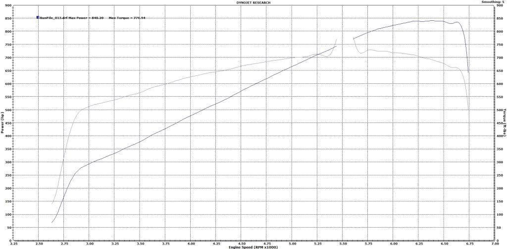

yes to the flip drive :) 840rwhp 777rwtq through catalytic converters @17lbs of boost

http://i998.photobucket.com/albums/a...wDynoGraph.jpg
