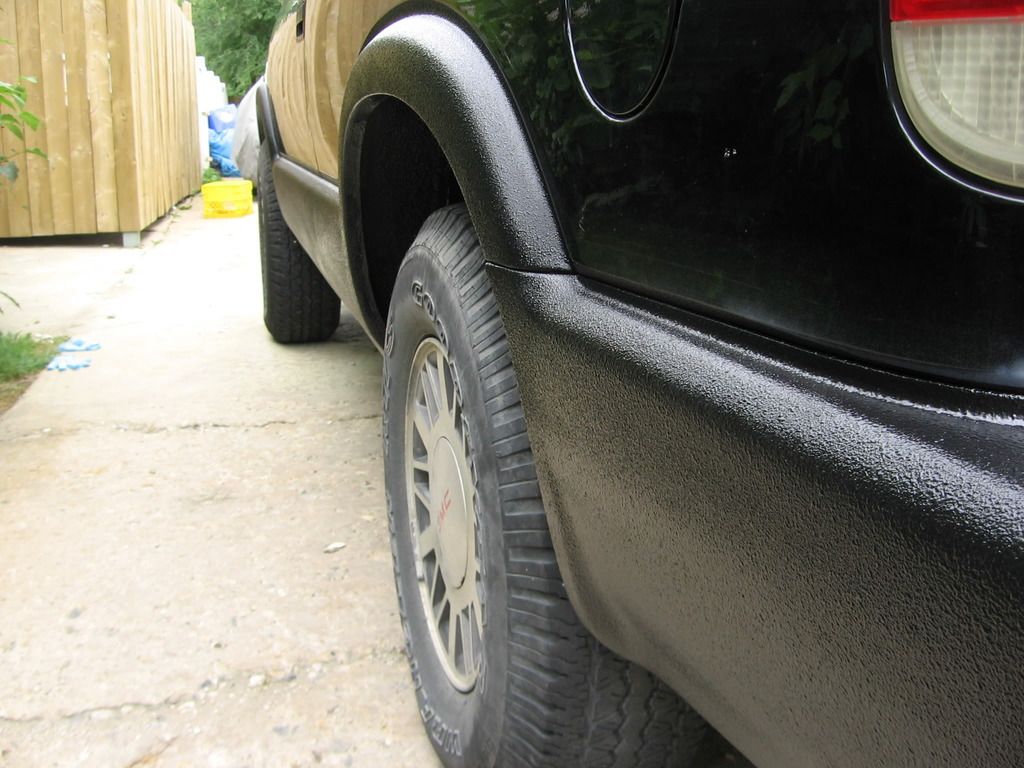

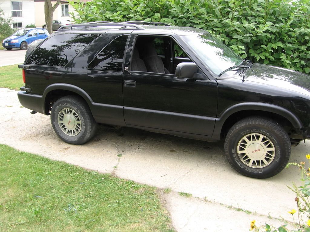

badmatt 04-21-2012 08:56 PM
Originally Posted by The WidowMaker (Post 409292)
just sprayed 2 truck beds with upol raptor. scuffed and shot both. the stuff is tough as nails.
X2 and looks great! Did it on my previous DD. I had some surface rust so I blasted from the body line down, hit it with a good etching primer than sprayed took all winter up here (-40C +all the salt) with no issues. Ill be doing it to my new DD when i get around to replacing the cab corners. And the whole underside , fire wall, back of the cab and front of the bed on NERA.
http://img.photobucket.com/albums/v3...IMG_0153-1.jpg
http://img.photobucket.com/albums/v3...IMG_0156-1.jpg
Matt
