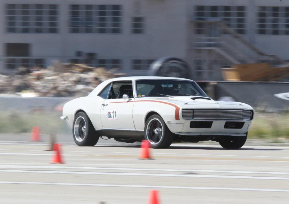

Rod P 04-21-2012 09:21 PM
go with the tru trac I drive the hell outta mine works great!! as a daily driver car and at the track
heres my car at RTTC
http://i752.photobucket.com/albums/x...96796888_n.jpg
FETorino 04-21-2012 10:45 PM
heres may car at RTTC
That is motivating......... :hail: Sweet car.:thumbsup:
