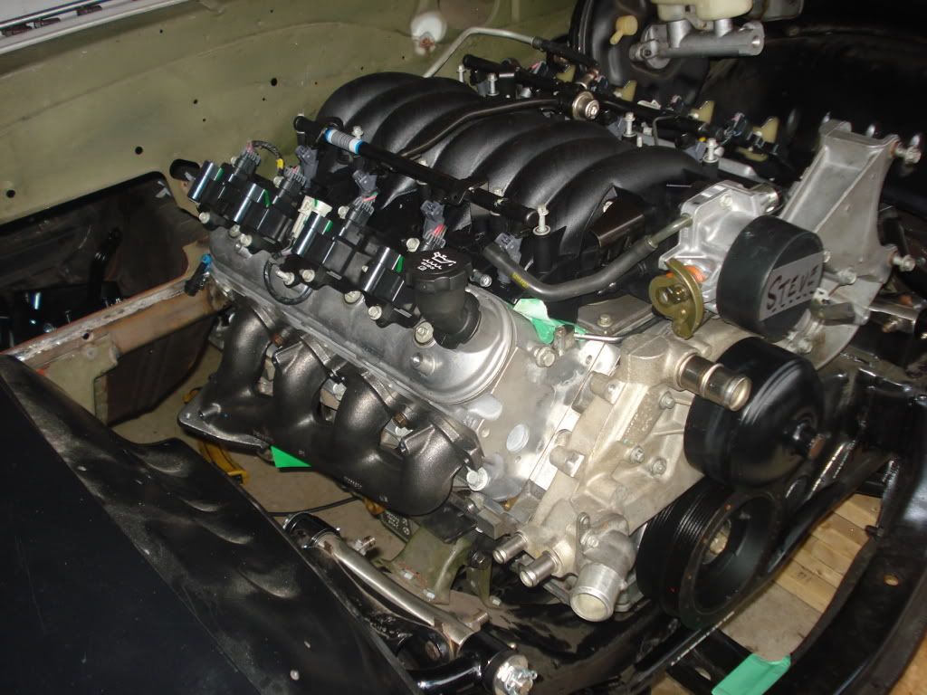

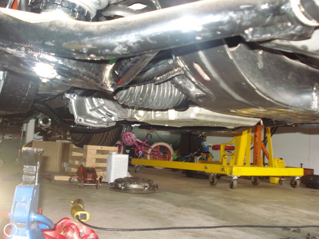

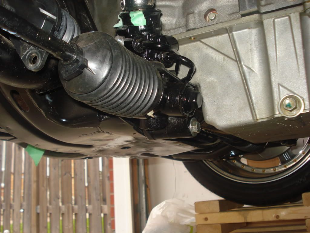

im running an LS in my 69 camaro with a unisteer rack with a stock F body oil pan and stock subframe. I used 1" set back motor mount plates with stock small block frame pedestals but Im running manifolds from an 08 colorado. Dont know if this helps you. I will post a pic for you.:thumbsup:
aany001 05-05-2012 06:35 PM
:cheers: I hope this helps you out.Let me know If you have any questions.
Originally Posted by aany001 (Post 301205)
Well after around 8 hours and a few beers with a buddy the drivetrain is in place with a stock F body oil pan with no mods to it.Fits like a glove.....man Im tired but a huge step forward.Enjoy the pics.
