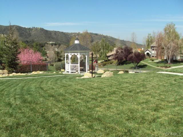

Thanks Gaetano :thumbsup: So assuming a 500 sq ft also sounds like around $30K as mentioned above. The lot is a 1/2 acre and the house is around 3000 sq ft so I think that might be fine as the home next door is 5600 sq ft single story on the same size lot. However that is good to know and I would suspect it would be more as the land kind of slopes towards the rear of where the garage would end. I know it is hard to tell from this picture but I would assume a lot could be made up with concrete or would you back fill with dirt?
http://i186.photobucket.com/albums/x.../getmedia1.jpg
