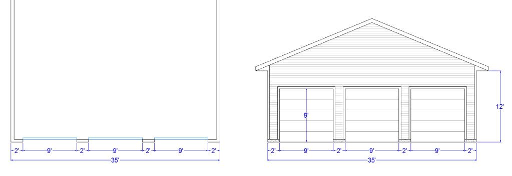

I am finally moving back to my home state of Nebraska and will be building a house with an attached garage. I have 3/4 acre of land so I am trying to do it right the first and only time. My plan is to have 35 wide by 40 foot deep attached garage. I will have a 4 foot set back on each end (Enough room to open doors and not hit walls). I will have three 7 foot wide by 9 foot tall garage doors (I have a lifted chevy truck). There will be 3 feet between the garage doors. My question is in what stall should I put an autolift? I am thinking the middle stall? This is not a commercial garage, just a garage I can mess around in. Any more suggestions? Please respond, I only want to do this once and not say S**T I forgot about that or I wish I would have done that. I will also be putting in a drain with hot water to wash the salt of the vehicles in the winter. Thanks!

Is 7' wide enough on the OH doors? I drive a 2011 3/4 ton chevy and the extended mirrors make it a tight fit through my 9' wide doors. It's doable but you have to pay attention. I measured mirror to mirror and it's 99". Just something to consider.
For a 9' tall door and a lift you'll want a 12' ceiling so 9x9 doors may not look too bad...

You need at least a 12 foot ceiling to give you enough headroom for a four post lift. I agree, you need a minimum of 9' wide doors.
CornHusker4Life 05-22-2012 08:59 AM
I am definately going with a 12 foot ceiling and 9x9 doors. Also going to put in heated floors. Thanks for the suggestions. Keep them coming:thumbsup:

Unless you really have your heart set on doing those three small doors for aesthetic reasons or something....My advice is, don't do it.
Go with a single 16' wide door, preferably with a 9 foot clearance.
Those small doors are going to greatly limit what you will be able to get into/out of the shop. Who knows what the future may bring.
Also you lose that whole available wall, to doors.
Have you considered building with Scissor trusses, so that you can achieve a high (vaulted) ceiling at the center (so that you can accommodate a lift)?
