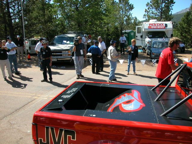

I really like how Shaun Palmer pulled his pikes peak SY off..
http://img.photobucket.com/albums/v342/badmatt/pp8.jpg

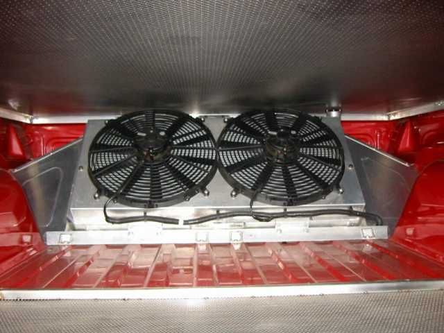

Lingenfelter did it also with their AWD sonoma, Only problem with this... my fuel cell, dry sump, take up that real-estate and my exhaust exits out the side of the bed right under all that stuff.
http://img.photobucket.com/albums/v3...ooling_006.jpg
Im just wondering does any body have any insight or experience with a rear mounted rad.

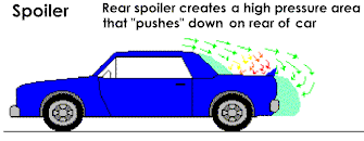

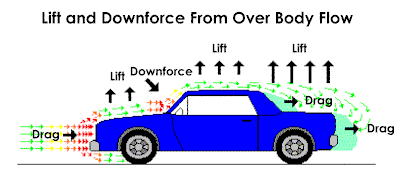

I'm guessing a key point is the flat panel on top of the radiator and it's slightly elevated front portion.
My only thought is the big flat spot of the bed is an area of detached air flow and you might not get as much flow into the radiator as you would think. Either the small scoop effect of the top at the back of his bed or a small spoiler might create the high pressure area you want. Maybe some real aero guys would know.
