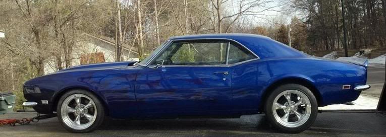

My 68 Camaro, “Someday”.

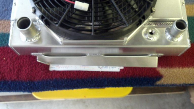

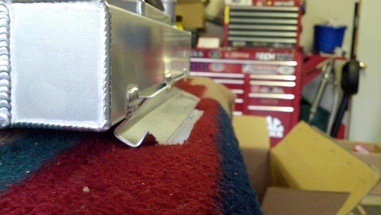

Cooling: 9/8/12 Edit: PRC dual fan, dual pass LS style assembly like Payback has. Purchased via PT.com from PSV. Thank you Paul.
Formerly OE style radiator and fixed blade flexalyte. It is hard to make that sound adequate or impressive any way you state it. That said, it didn't let me down even in a '97 parade at 100*+
I've been looking at / talked to PRC(Musclerodz and Prodigy), Ryan @ Universal and Sparky @ R&D Fab.

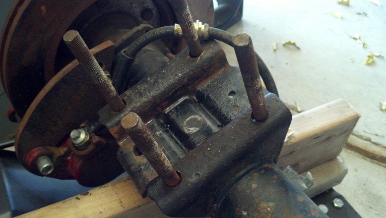

Rear Differential:
Swapping my original 8.2”10 bolt 3.08 one wheel wonder for another with Richmond 3.73, Eaton Posi, Strange Axles and disc brakes. Not all the kids can be cool enough to have a 12 bolt or a 9” even if we’d like to. Maybe “Someday” I can get one.

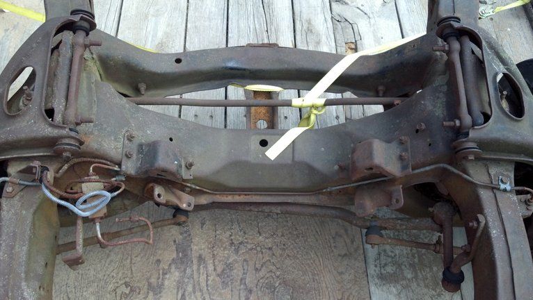

OE subframe... “sigh”. Pending frame shop diagnosis, currently seeking an alternate stock sub to give some TLC and swap in.
Competition Engineering bolt-in subframe connectors. (Hey, there weren’t many choices in ‘92!)

Regarding the SPC's - While I was measuring my spare subframe last night and realizing the upper left control arm mount appears to be pulled outward the value of SPC's adjustability crossed my mind.

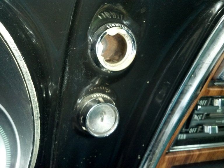

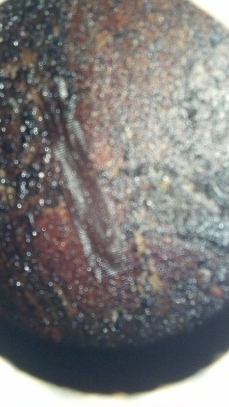

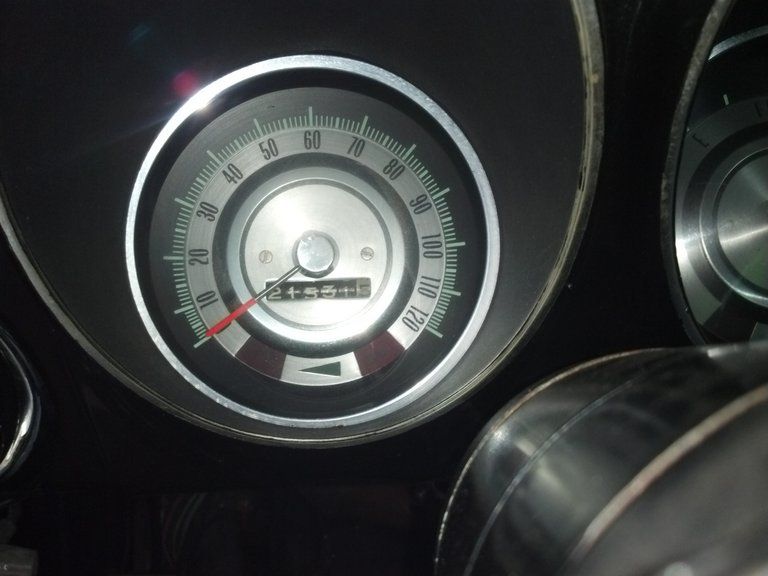

Not that everybody here cares about odometers since most cars are heavily modded and thoroughly gone through... but Someday has 121,531 actual. Motor was done around 117k as I recall but I have it written down somewhere.
http://i40.photobucket.com/albums/e2...8509247409.jpg
If you read the intro you might have caught the comment about Someday being something of a draw for fires... more on that later. Here is evidence of another close call I had almost forgotten. No fuse blew, the repro cig lighter I had just bought melted so I tossed it out the window. It was not a good test but I learned why the original was probably nonfunctioning.http://i40.photobucket.com/albums/e2...8509240335.jpg.
I bet your eye went to that rockin' downtown Kenwood pullout!! :unibrow:
Did you even notice the factory AC? That little bit you see below the off and de-ice is a special limited edition vibration dampening anti-annoyance device made entirely of compressed wood fiber. It originally came with a small collection of incendiaries from an adult drinking establishment back in the day.

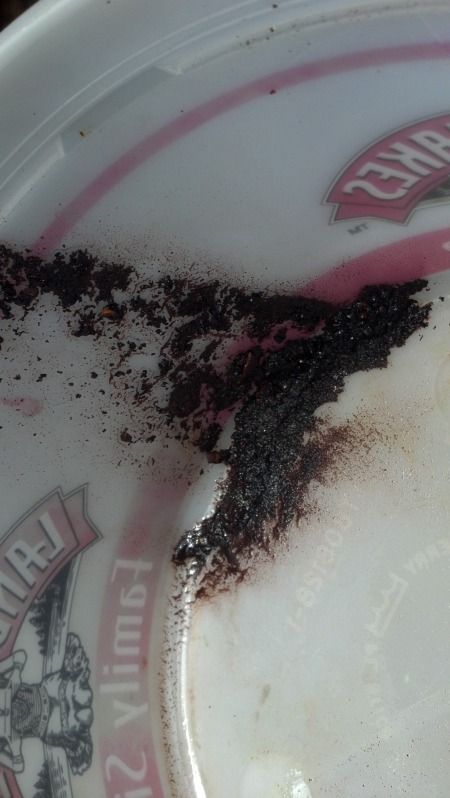

Here is another sign of Somedays history with fire. That is a heap of buffing compound sitting on smoke residue that has not been cleaned off the hinges yet. It has been 5 years and I still find that crap lurking in places.http://i40.photobucket.com/albums/e2...8509237953.jpg

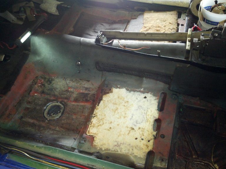

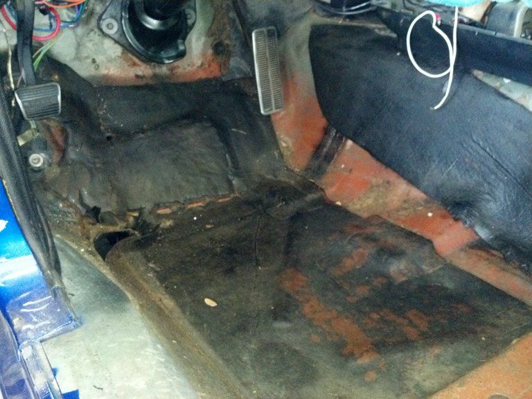

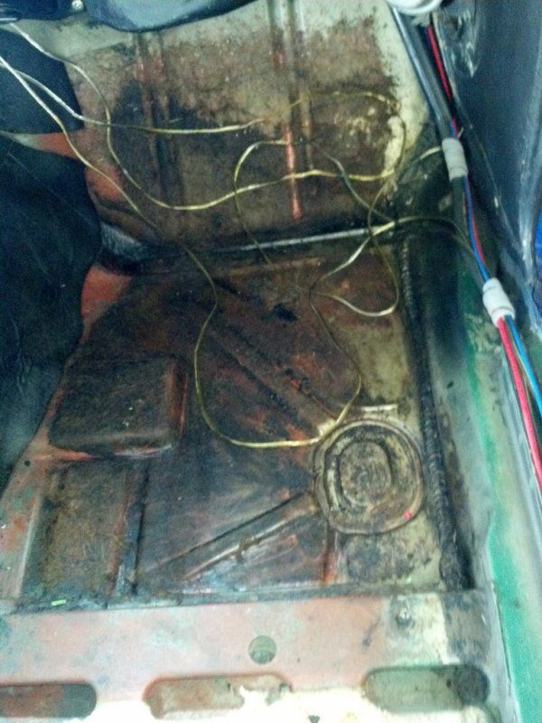

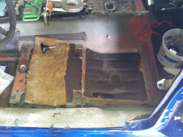

Tonight I removed the carpet and console. I have to say I am pleased with my floor. I had seen the passenger side last year when I was wiring and ran cables to the trunk. The drivers side was equally rewarding. The silver lining to having a mechanical oil pressure gauge leak inside the cab? The passenger floor boards are rust proofed!:rolleyes: That is all oil stain, there is no rust to be found... unless you look at the trunk pan that is.
Somebody has some cleaning to do on Someday before Thermocoustic barrier goes in.:_paranoid
