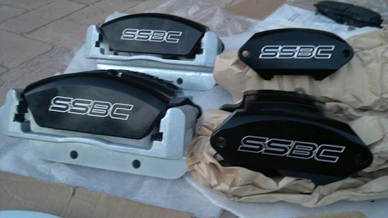

The SSBC Tri Power big brake kit is already on the way to Hungary.
