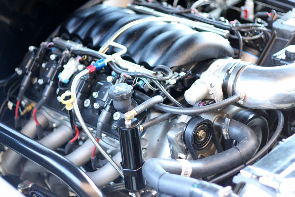

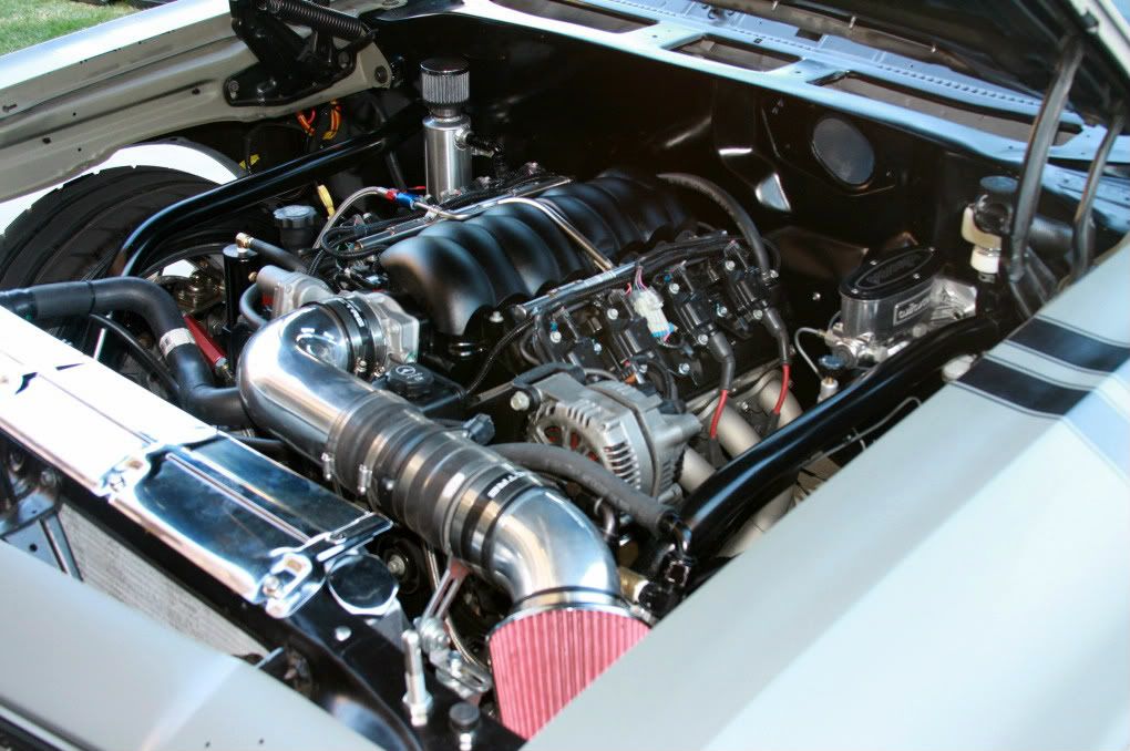

I don't know the answer but I just left mine blocked off as you have it. Subscribing to see opinions. I just drilled a hole in my Spectre elbow. I know it is not that clean but it seems to work.
http://i186.photobucket.com/albums/x...f/IMG_4611.jpg

Thanks for the picture. What size and type fitting did you use? I was thinking about trying something like that on the underside of the tube, but was wondering about how to seal a flat fitting against a curved surface.
By the way, is that a Norris catch can?

Mike, I used a 5/16" (might have been a 1/4" don't remember)Hose barb fitting along with a thin retaining nut on inside.
Looks like this:http://images.drillspot.com/pimages/7277/727788_300.jpg
A welded fitting might look nicer. That is also a Norris catch can. Not sure if needed but I also have a catch can hooked up to driver side rear valve cover that runs to pass side.
http://i186.photobucket.com/albums/x...IMG_4647-1.jpg

Nice job tom, very clean...I hope you used lock tight on that nut.
You could weld a NPT bung to the underside of the tube.
