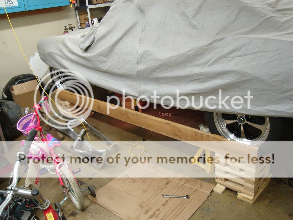

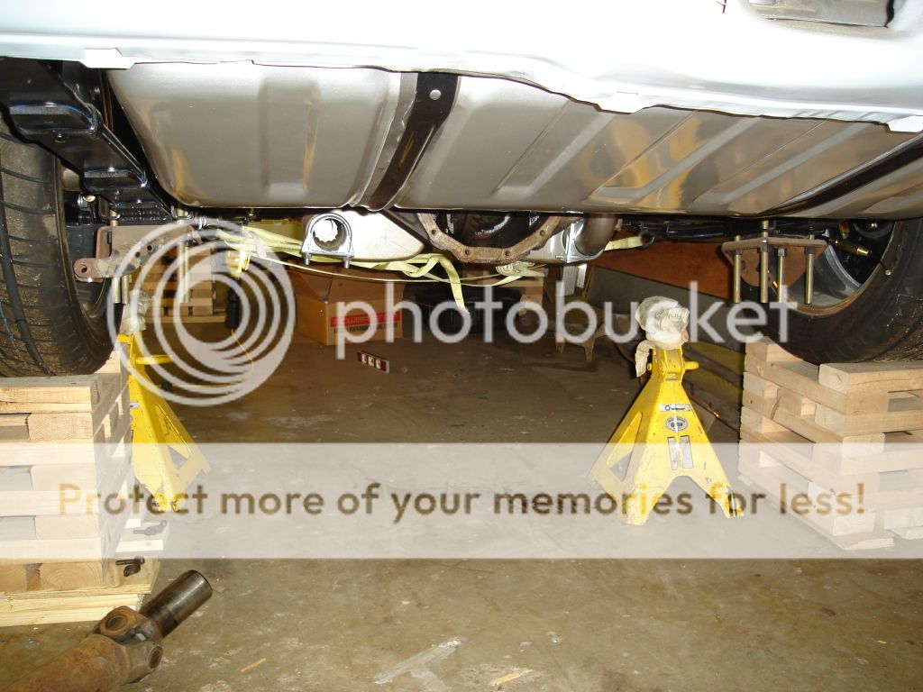

I first started with leveling the car the best that I could. My garage floor is horrible.
http://i319.photobucket.com/albums/m...y/DSC07428.jpg
http://i319.photobucket.com/albums/m...y/DSC07429.jpg
