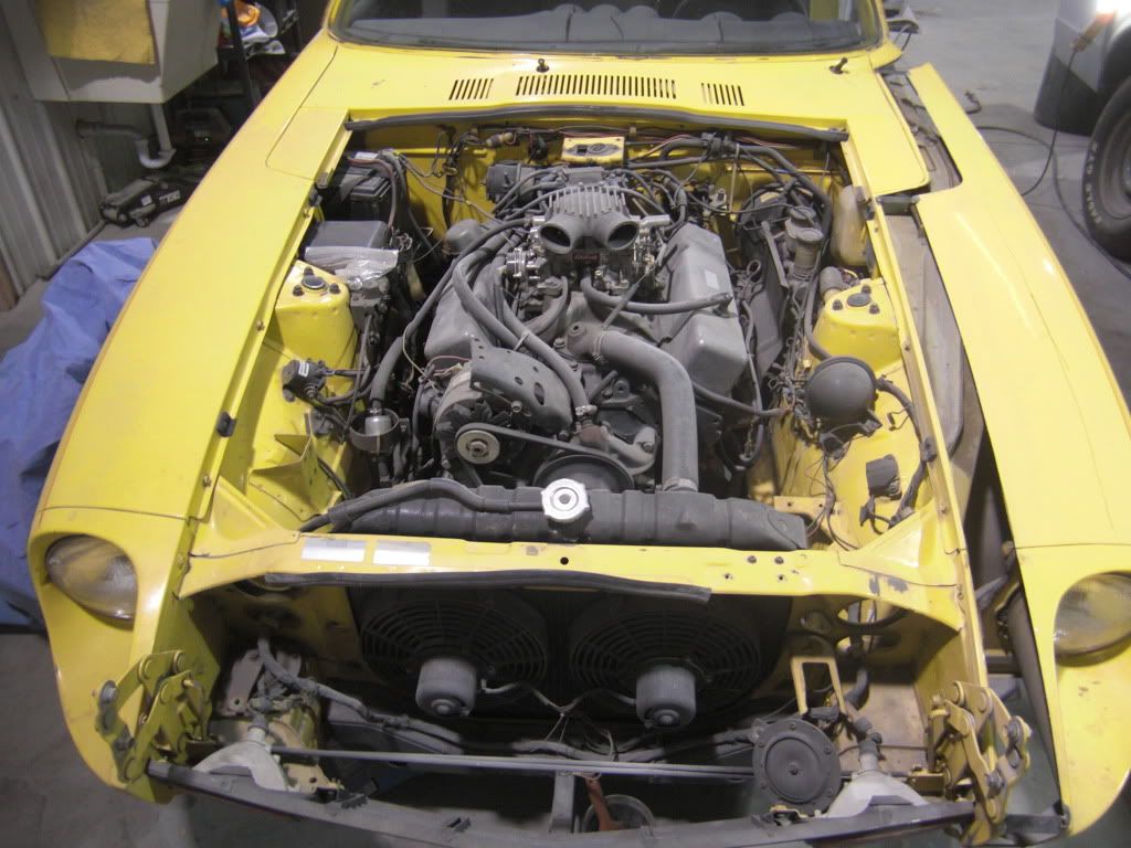

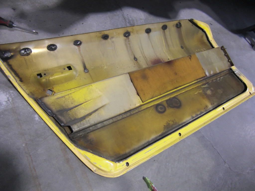

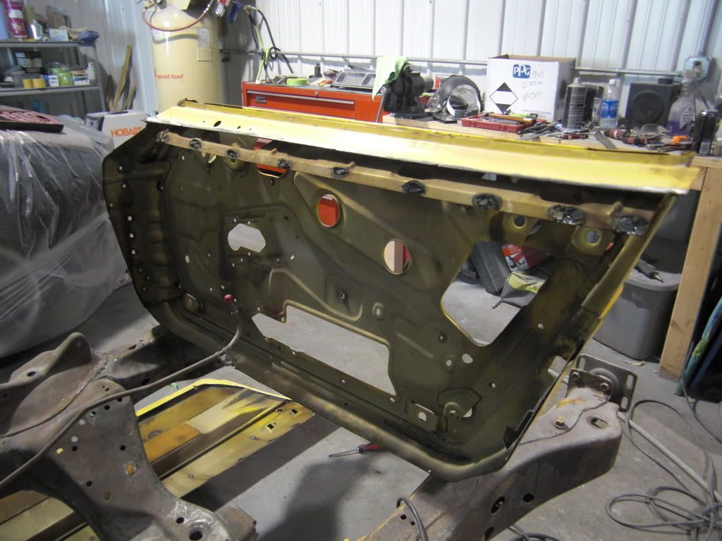

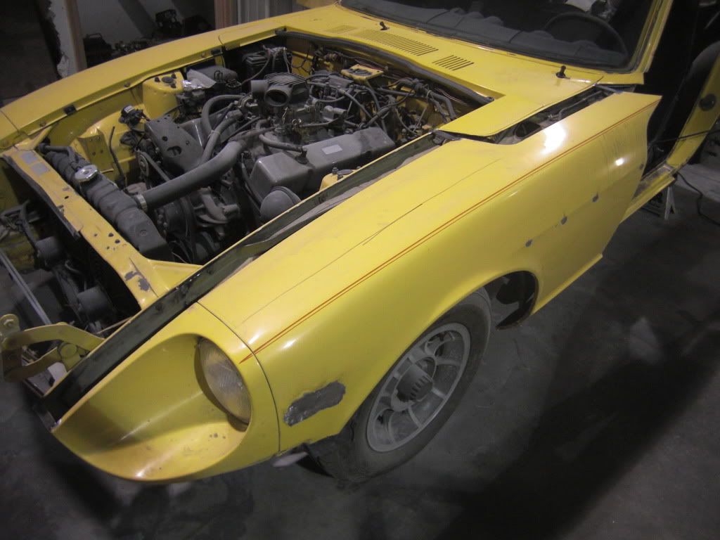

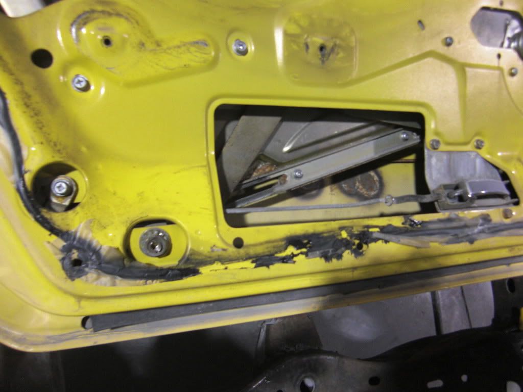

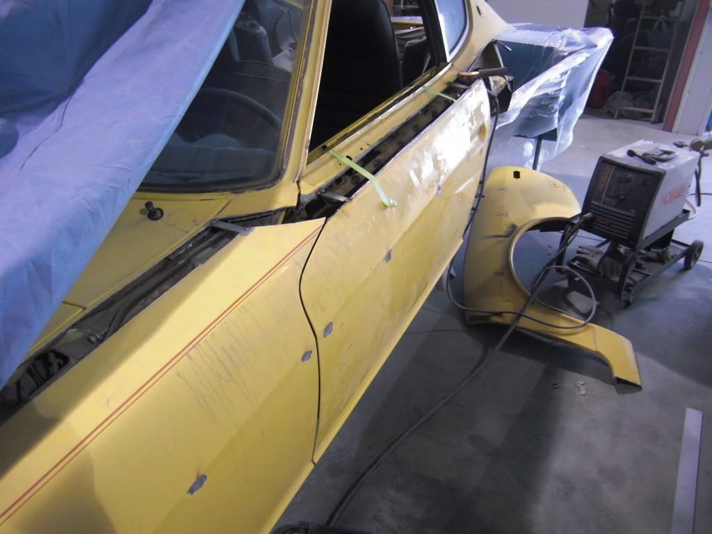

This is a project we have going on the side currently, it is going to be a completely custom car. It is a 77 280 z datsun that plans are, getting the whole body widened 5 inches, flush mounted glass, custom quarter glass made, delete bumpers, extend tail pain, make our own body lines in the tail pan, custom rear lights, custom cowl hood, corvette style door handles, and im sure more
the start of the cutting and widening each side out 2.5 inches.
http://i953.photobucket.com/albums/a.../kodak0025.jpg
http://i953.photobucket.com/albums/a.../kodak0024.jpg
http://i953.photobucket.com/albums/a.../kodak0023.jpg
http://i953.photobucket.com/albums/a...Z/CIMG3318.jpg
http://i953.photobucket.com/albums/a...Z/CIMG3319.jpg
http://i953.photobucket.com/albums/a...Z/CIMG3320.jpg
http://i953.photobucket.com/albums/a...Z/CIMG3321.jpg
http://i953.photobucket.com/albums/a...Z/CIMG3322.jpg
http://i953.photobucket.com/albums/a...Z/CIMG3323.jpg
this is to give us an idea where/how everything will sit so we can start adjusting the panels and do more cutting and moving

You may need to relocate the door hinges outward the same amount that you widened the doors. The arc that the door needs to swing (if you don't move the hinges) might be too great for the door-to-fender clearance. Let us know how it works out!
Looks like a fun project. Keep the pic coming!
--Eric
tones2SS 06-20-2012 05:00 PM
This should be a great build. Do you have a rendering that you are going to follow?
Royalworks 06-20-2012 06:00 PM
As far as the hinges go I won't need to move them. I just cut the door shell before the hinges. It does go in father since the distance is greater for the skin to swing in. The only part it hits is the fender brace that also acts as the dust shield. Cut that out and make a new one. Problem solved. Widening a car this way also makes the car longer. I have a lot of different ideas I want. I showed them to Ben Hermance a while ago. When I get the body closer I'll have a rendering done with all the details. I've worked with Ben quite a bit. I have also worked with Sean Smith once.
