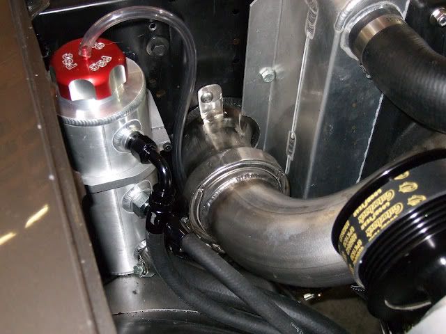

Flash68 06-28-2012 11:31 PM
I had the PSC unit on my previous 68 mounted here. Kinda tight but yes it's a big piece.
http://i236.photobucket.com/albums/f...DSCF2456-1.jpg

hmm by the radiator would work but my washer box and radiator overflow res is there.
what type of hoses and fittings did you use on yours? Are those the push on style?
slenning 06-29-2012 08:55 AM
I've got mine mounted in the exact same spot as Flash's pic
Lenie 06-29-2012 10:34 AM
^^same here.
