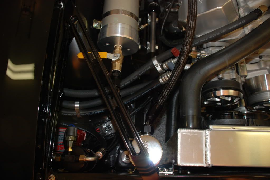

I put mine in the gap between the inner fender and radiator support. My thought was the breze on the outside of the headlight would cool it. I used delphi connectors as I considered wiring up a spare box for events and it make it more serviceable. The more I work on things, the less I like to hide stuff. I ran my wires down and tethered them to the engine block, by the starter, and up around to the distributor.
http://i200.photobucket.com/albums/a...toShoot019.jpg
