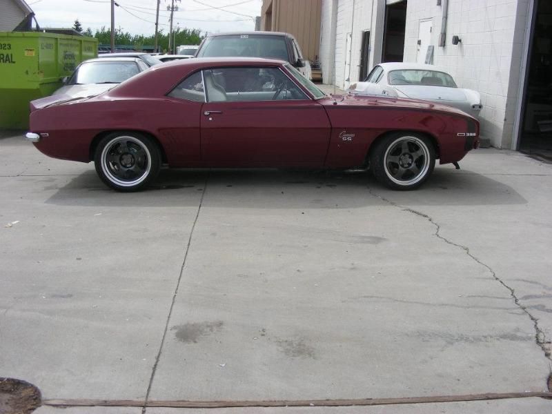

I have never taken apart a multi piece wheel before, but I was thinking of making a color change to the center section of my rims. I have tried to get in touch with Fikse but had no luck with anyone calling me back. Any advice or input on doing this? Thanks.

I hope its some other form of black because those look great as they are.
