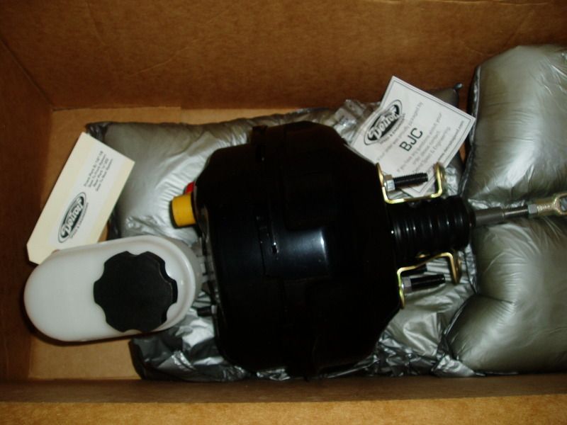

Does anyone out there have a DSE m/c & booster combo.
I need the actual part numbers cast into the pieces.
One from the master cylinder and one from the booster. The reason behind this is that DSE tells me that this mc & booster combo is an old design and no longer available.
I want to use the screw on cap type of reservoir as used on their test Camaro's.
http://i99.photobucket.com/albums/l312/okki63/017.jpg

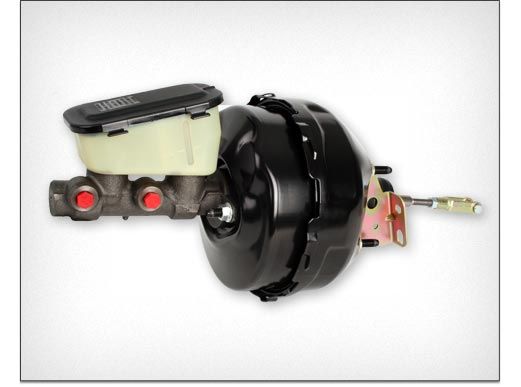

I don't like the snap on top of the new DSE design.
http://i99.photobucket.com/albums/l3...50101-main.jpg
Any help would be appreciated.

aps63 07-29-2012 08:16 PM
Thanks for the input Jay.
The reservoir is an AC delco unit(DSE told me that).
I just want to find out which one it is. They say they have no records of which reservoir they used but it's on both of their test Camaro's and they sold it to the public. I'm not trying to steal company secrets I just like the unit that they used and would like to use it on my car. I would even buy it from them. I have bought several other things from them in the past and was very happy.
Thanks again.
