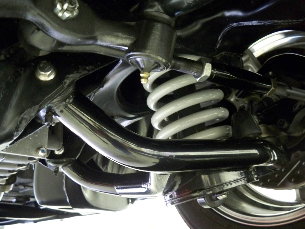

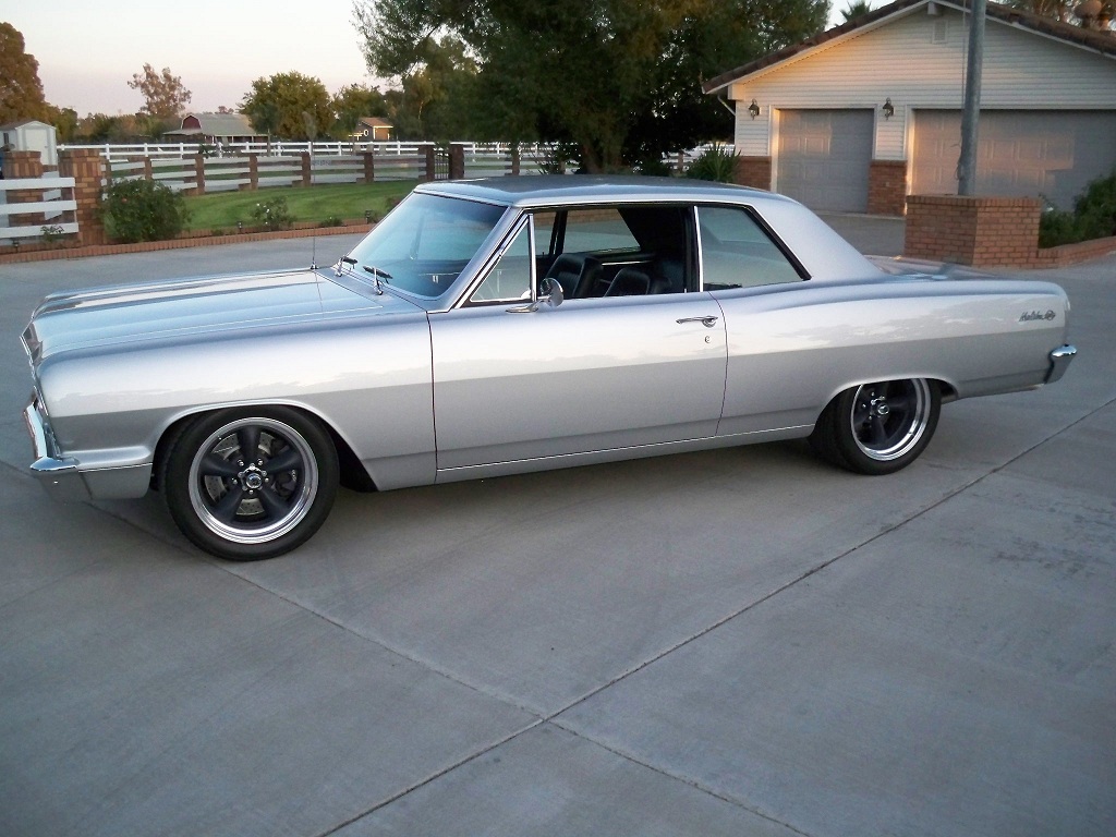

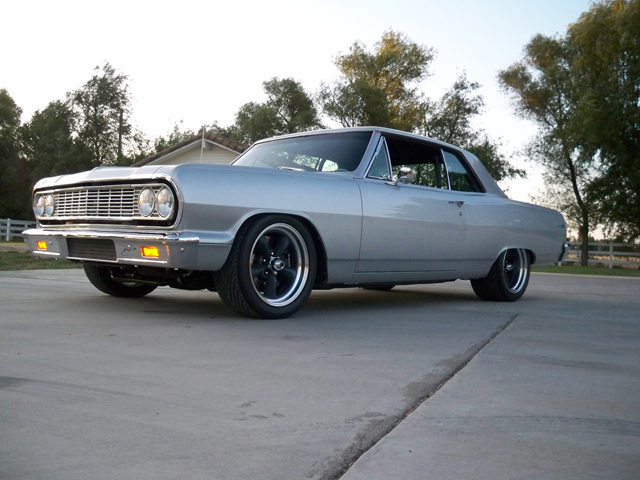

I had Hotchkis springs, LCA's, and sway bars front and rear on my 64, nicest riding musclecar I've ever had. Handled great but without the stiff ride.
http://camcojb.com/temp/100_0770r.jpg
http://camcojb.com/temp/100_0793r.jpg
http://camcojb.com/temp/100_0822r.jpg
