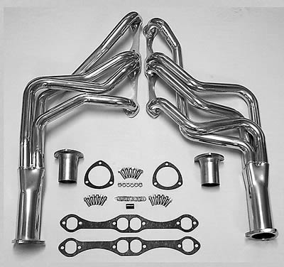

Sieg 09-11-2012 01:54 PM
Anyone have experience with Doug's 368 model with Saginaw 700 box?
They work with the D-port but the 1 -3/4" tube layout is different than my current set-up:
http://sieg.smugmug.com/Cars/69-Cama...IMAG1983-L.jpg
Doug's 368
http://static.summitracing.com/globa...dou-d368_w.jpg
Doug's 308
http://static.summitracing.com/globa...dou-d308_w.jpg
This looks like it should clear the box but the oval 1-5/8" tube doesn't match up ideally to the D-port creating a curb in the lower corners.
Help!

Sieg 10-29-2012 08:07 PM
I ended up with the Doug's 368's and they fit great. The only nit-picks are had to trim the drivers upper control arm cross-shaft bolt to clear the #1 tube, the MSD plug boot is tight against #5 tube, and I can't get my Snap On swivel socket on plugs #5 & 7, short box end wrench is no problem though.
