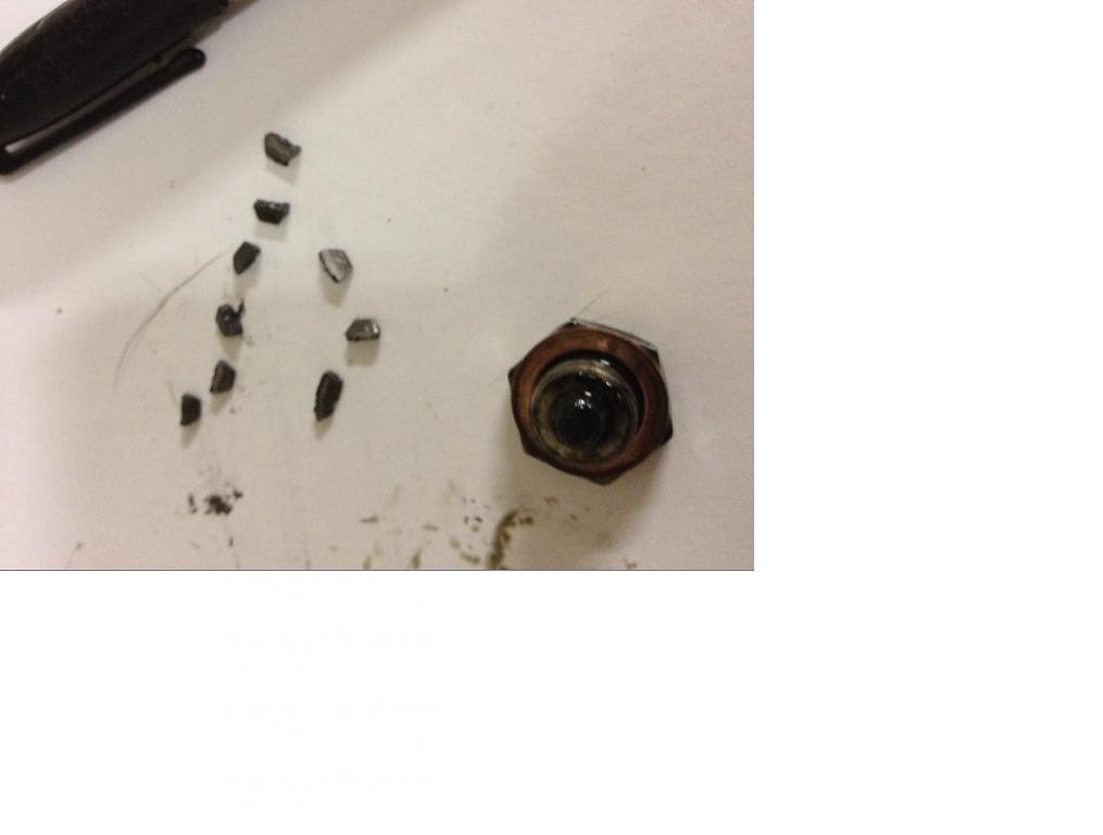

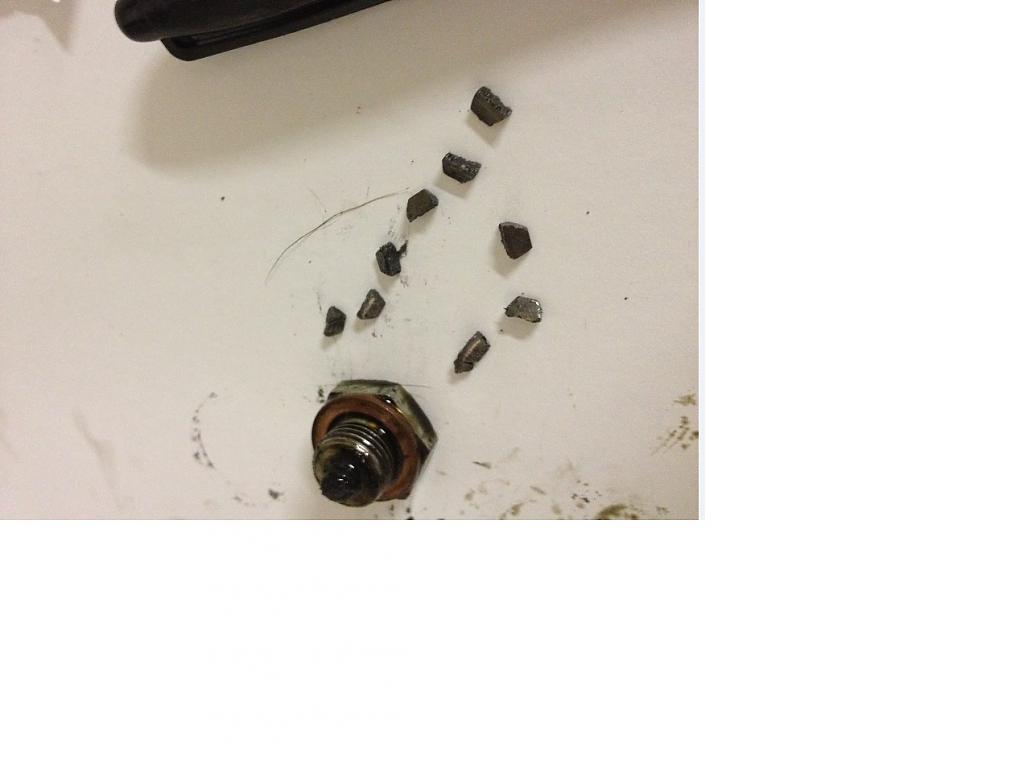

Changing my oil tonight to prep for a track day tomorrow I was lucky enough to find a nice surprise on the magnet. Pics are below.
Can anyone help me figure it out before I pull the engine and tear it down? Engine is a SBC 377 with 400 4 bolt block, forged eagle crank with 400 mains, 6" Scat rods, JE flatops, 195cc Trick flow heads with springs to handle up to 600" lift. It has roller rockers and stud girdles. Cam is a Comp solid with net lift ~530" and lifters with the oil holes in them (forget what they are called). Timing chain is a double roller without a cam button.
I'm thinking it has to be teeth from the disti gear or cam gear but I pulled the dist and it looks ok. I looked down the disti hole at the cam and tapped the motor over. I don't see any teeth that look damaged.
Attachment 36983
Attachment 36984
camcojb 09-20-2012 09:01 PM
looks like the timing gear to me, either the cam gear or the crank gear. A quick pull of the timing cover will tell you for sure.
Edit: just read that you have a double roller, not sure with that. Those looked like the teeth of a single roller with iron teeth, but it's hard to tell from the pics.
gerno 09-20-2012 09:19 PM
I agree with you but they seem to be too small for timing gear teeth. It may be the ends of them. The only teeth I can think of are the timing gear, disti gear and cam gear. Guess I'll pull the timining cover this weekend and take a look.

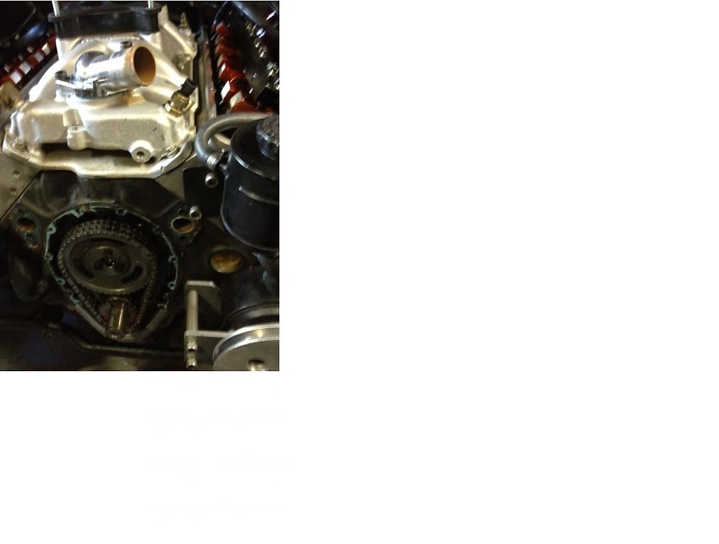

gerno 09-21-2012 11:23 AM
3 Attachment(s)
Cam gear was the issue. Since I'll be pulling the engine out I suppose it's time for some upgrades...
Darker area in the chain is where some teet are missing.

camcojb 09-21-2012 01:12 PM
relatively cheap fix compared to what it could have been. :thumbsup:
gerno 09-21-2012 02:12 PM
In theory it is cheap but not for me.... I'm going to pull the engine to check all the bearings and while I have it out I found pistons to drop from 10.8 to 8.8. They are only 4 grams different so no need to rebalance so I "have to" do it. I also figure I should go ahead and swap to a solid roller am with a different profile since its apart. All this being in prep for either a T-trim or D1SC addition......
