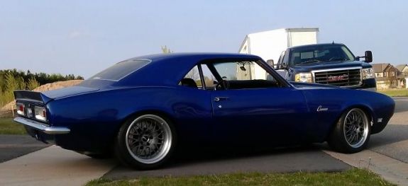

My car is a '69 with everything from DSE and sits relatively low.
http://i366.photobucket.com/albums/o...A/DSC_0761.jpg
To get it to not hit the fenders we had to modify the inner fenders for more clearance and roll the fender lips between 10 and 2 o'clock. Around town, and under hard driving there is zero rubbing, however, I do occasionally hit the tire against the frame, but just barely. This is only at full lock with 275s on a 9" rim. With the '67 and '68 I think it would be very difficult to pull of the stance you want with any normal amount of steering. The only '67-'68s I know of that are low and have 275s have very limited steering, and still occasionally rub, although aftermarket/highly modified frames, not DSE frames.
Matt
