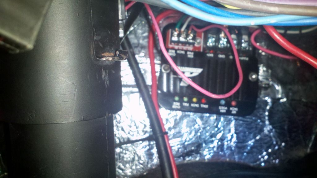

Hey guys - I'm an EFI noob and could use a little guidance. We're getting a little closer to having our project ready to go to a chassis dyno for final tuning of the FAST-XFI system, but we seem to be having a problem with the Aeromotive FPSC. We're running a Rick's Stainless Stealth tank with a 18668 A1000 Stealth pump. Pump ran at full speed with no issues before I found out we needed the 16306 Fuel Pump Speed Controller to keep our FAST-injected 565 and the A1000 pump happy (and cool?). We installed the FPSC pictured below under the dash and wired it per the instructions. Yes - I realize now that it is supposed to be wired close to the pump, so we may need to relocate it to the trunk. Only thing we didn't do at this point was wire in an override switch.
The issue we're having is that the pump fires up to full speed with the ignition and the engine fires up just fine, but after a few minutes the FPSC cuts off power to the pump and the engine dies. Sometimes it does this after 2 minutes of running the engine, sometimes after 15 minutes. If I turn off the ignition completely and restart, the engine fires right back up like nothing happened, no matter how long it ran before shutting off. Didn't have this issue without the FPSC; only started with the FPSC installed. Any ideas/pointers?
http://i1216.photobucket.com/albums/...-46-51_172.jpg
http://i1216.photobucket.com/albums/...-46-39_724.jpg
http://i1216.photobucket.com/albums/...6-32-09_80.jpg
Thanks for the help!
Rob
GregWeld 10-01-2012 05:43 PM
Move the controller.
Make absolutely certain that your wiring is the correct gauge to carry the amperage.
And put some proper terminals on those wires....
ShadowGrayGuy 10-02-2012 04:03 AM
Thanks, Greg - I figured relocating it to the rear would be recommendation numero uno (since it IS stated in the instructions - D'oh!).
As it needs to be seen to observe the lights to verify its functioning properly (based on what I read), I assume it should be mounted in the trunk somewhere?
Any pics /descriptions of how others have mounted theirs? On a bracket on the trunk deck below the package tray?
