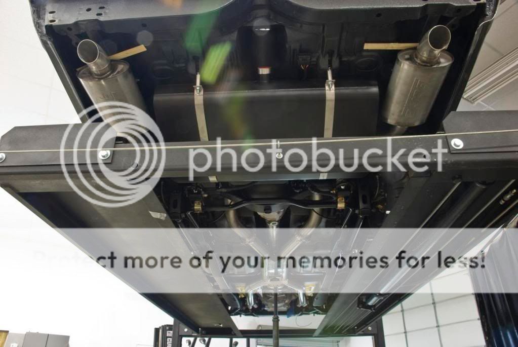

Im looking for experienced opinions on muffler placement. Id like to know if there is a reduced interior cabin sound if mufflers are placed behind the axle rather than in the stock locations under the rear seats. I like the way my car sounds but its terrible when cruising. I like it being loud but would like to hear the stereo (and my own thought) when cruising down the highway. Im running Flowmaster Super 40's with turn downs just before the bumper. I know what I was getting into when I bought them but thought that with enough interior insulation I could tame them. I considering going with a bullet style mufflers placed on either side of the fuel tank like this:

I think I would just replace the flowmasters with magnaflows or something instead of trying to work around them...just my 02

I have 2 layers of Fatmat, 1/2" Jute, then molded carpet. The trunk is completely sealed off with rear bulkhead insulated the same way. Side panes also sealed off with Fatmat. There is no Fatmat in the trunk. Just foam backed carpet.
Something else that may make a difference. I have no X-pipe or H-pipe. I've been told this will help to mellow out the sound some.
Tony_SS 10-19-2012 01:26 PM
An X-pipe will make a huge difference.. I know mine did. I have an X-pipe and Magnaflows and am really happy with how it sounds... no drone, no rasp or blumpy idle... just clean, smooth sound until you open it up.
