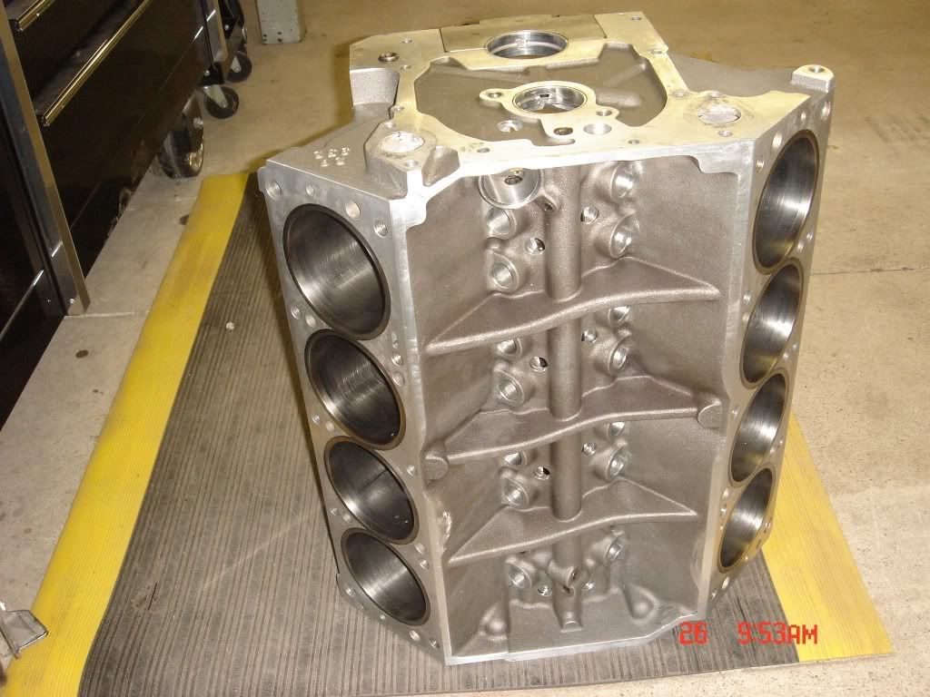

One of two Original Ford intakes a 2x4 with a pair of 750s or a single 1050 dominator (I'm running both on the dyno)
Pond Al sideoiler block
Crower forged crank 4.375 stroke with my bore it puts me at 496ci
Crower 6.7 rods
Custom CP pistons to put me @ 11 to 1
Crower bushed style solid roller lifters and a BP cam targeting peak power around 6200rpm.
T&D rocker set
Smith Bros pushrods
Dailey engineering 4 stage dry sump
Locked out MSD dist with MSD digital II CDI with programable ignition curve.
Electric water pump
http://i291.photobucket.com/albums/l...block005-1.jpg
http://i291.photobucket.com/albums/l...inca/ports.jpg
http://i291.photobucket.com/albums/l...inca/2x4tp.jpg
http://i291.photobucket.com/albums/l...ca/dailey3.jpg
