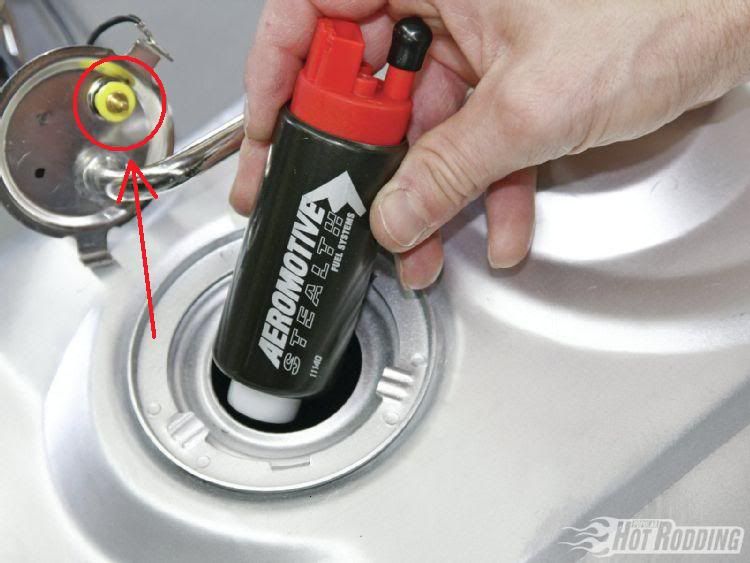

Hey guys, Im doing an in tank fuel pump for an LSx swap and Iam having a hard time finding these small electrical bulkhead connectors. I need to pass the two wired through the sending unit for power to the pump but I cant seem to find anywhere that has these ( red circle in pic below )
Any help would be greatly appreciated.

Look for a 2 or 4 wire amphenol conector they are usually hard anodized and weather tight so the connections are sealed
SuperB70 10-26-2012 11:56 AM
I have been taken those insulator things from old alternators. They just used normal nut & bolt. Works great.
