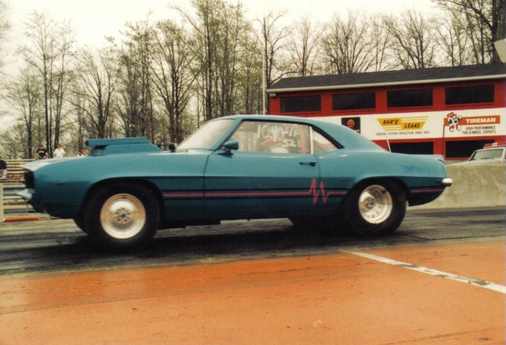

Along came the era of prostreet and mullets… I already had the hair and I seized the opportunity when an ex-drag car became available, a 69 Camaro with a narrowed Dana 60 (5.57 gears), full cage and lots of fiberglass. Spent a couple months converting back to a ‘street’ car…needed everything; interior, wiring, etc. I built a roller cam 350 with nitrous (that’s when ‘Mighty Mouse’ started), and kept the powerglide (big mistake...car needed more gear out of the hole).
http://i221.photobucket.com/albums/d...atthetrack.jpg
http://i221.photobucket.com/albums/d...usewithNOS.jpg

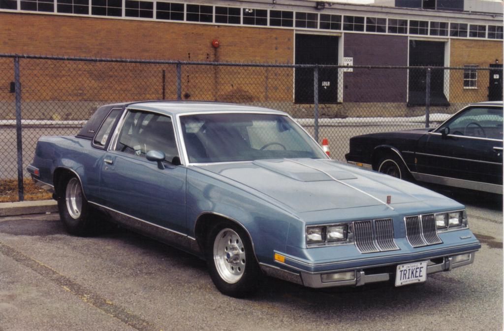

Well I had the 69 for a couple years, until I got hired by Toronto Police and moved up to the big city. The Camaro was a bit much to be driving around in Toronto traffic, so I traded with a friend for his prostreet 82 Cutlass Supreme. It was mild and very streetable, but I lived in an apartment and needed to rent storage space to keep, so it too didn’t last long in my possession.
http://i221.photobucket.com/albums/d.../82Cutlass.jpg

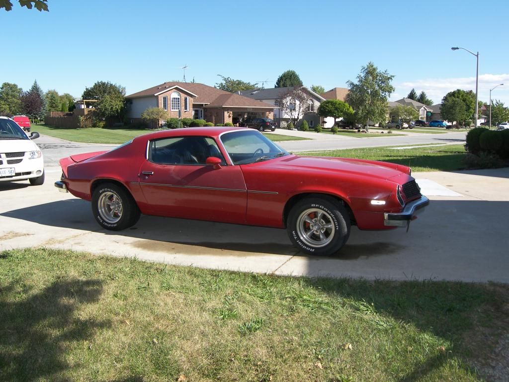

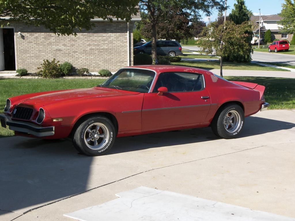

A few weeks ago I came across a 74 Camaro on one of the local lots. I knew it was going to need a lot of work, but I thought this would be the perfect learning experience for him. I made an offer (too much in hindsight) and took it home.

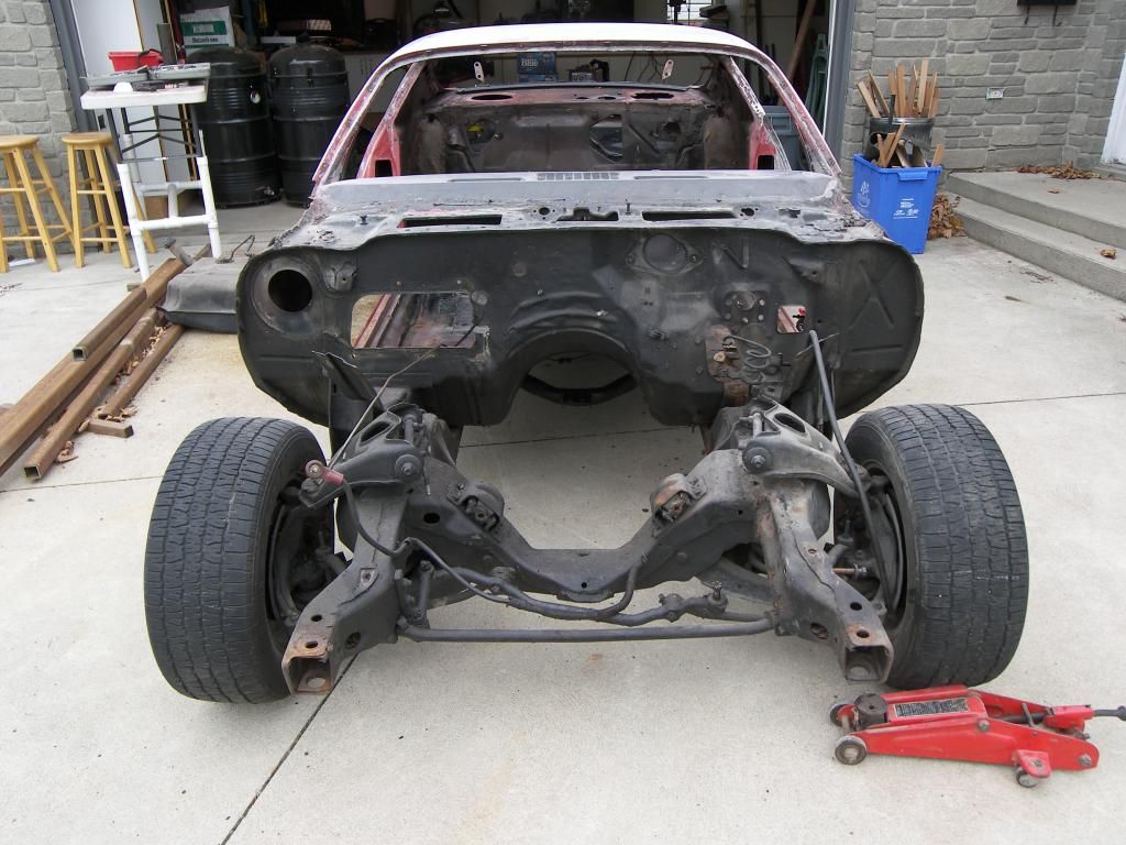

It hasn’t taken us long to strip her down and find all the ‘ugly’ buried beneath. This going to be a very budget build…my first wife is still on my ‘payroll’.

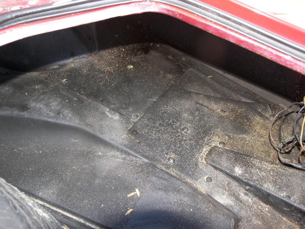

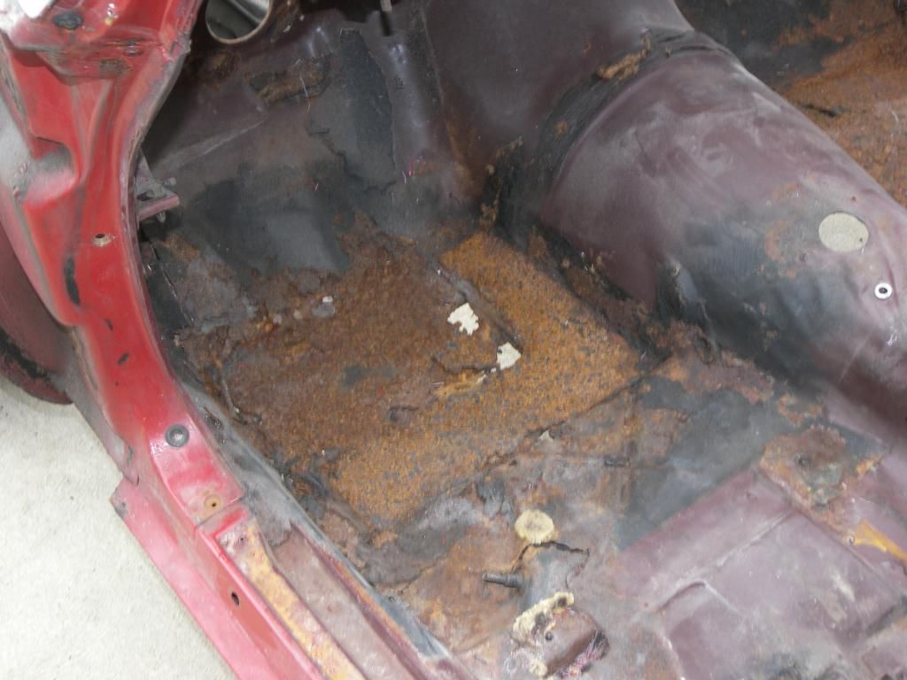

Floor pans are shot. Previous owners tried to patch them at some point... had expandable foam covering the holes this time.
http://i221.photobucket.com/albums/d...7/100_1260.jpg

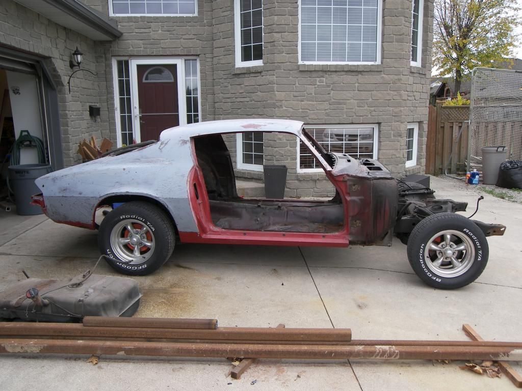

Stripped down waiting for the rotisserie (metal laying on the ground). My son has scraped most the paint off...hoping to cut the cost of media blast down.
http://i221.photobucket.com/albums/d...7/100_1256.jpg

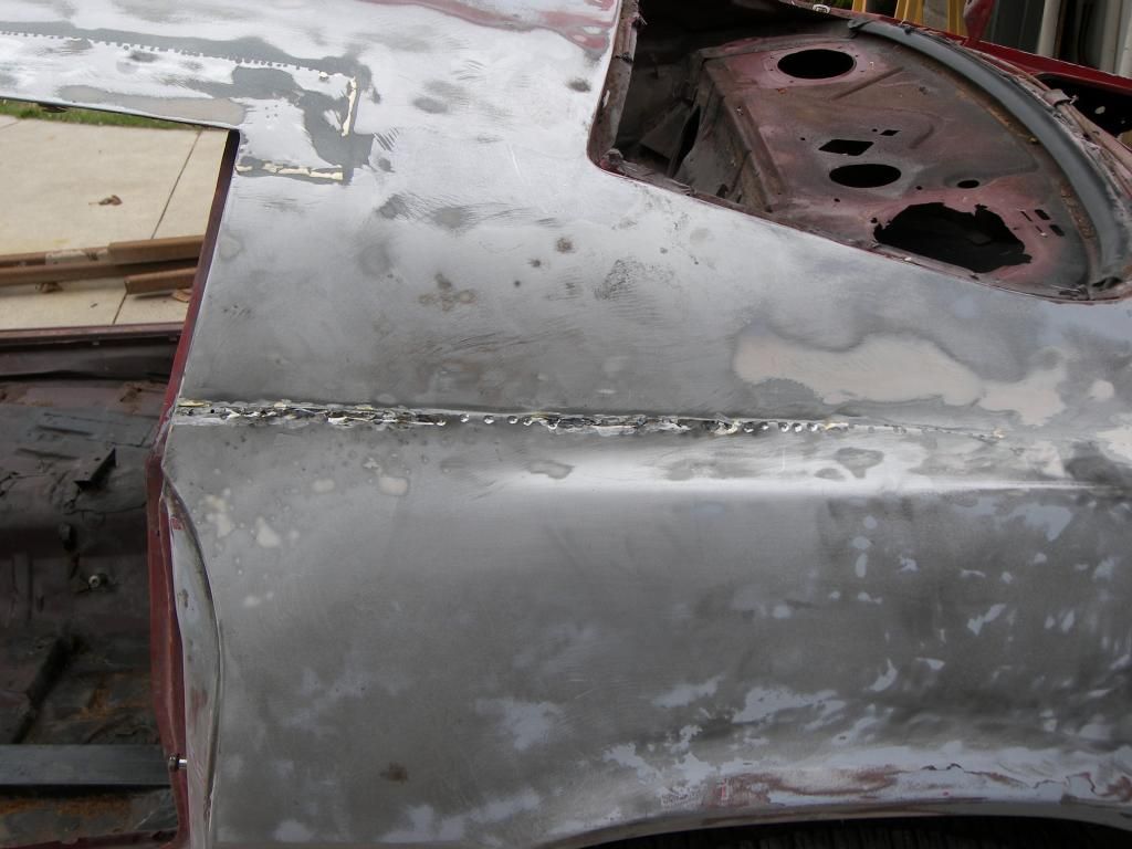

Previous applied quarter skin. It had lots of bondo covering the seam. I started messing around to see if I could pop it off so I could butt weld a new skin on, but I think I will go with converting the full 73 quarters.
http://i221.photobucket.com/albums/d...7/100_1261.jpg

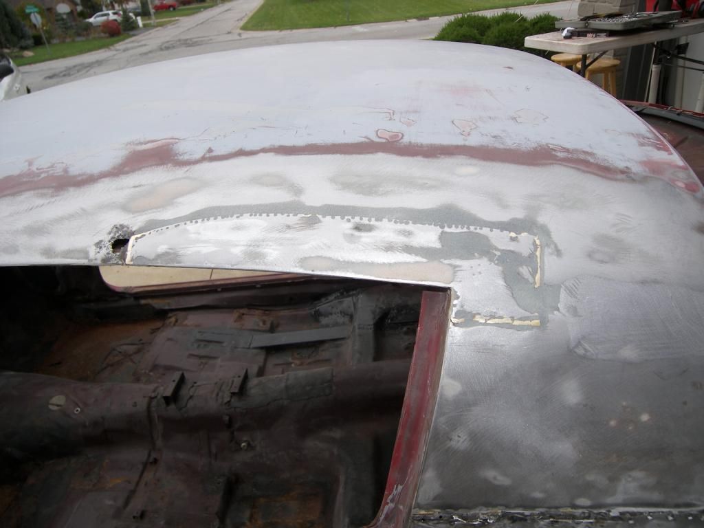

The roof has a couple patches; one on each side. I'm not sure what I'm going to do here. May need to go with new roof skin.
http://i221.photobucket.com/albums/d...7/100_1262.jpg

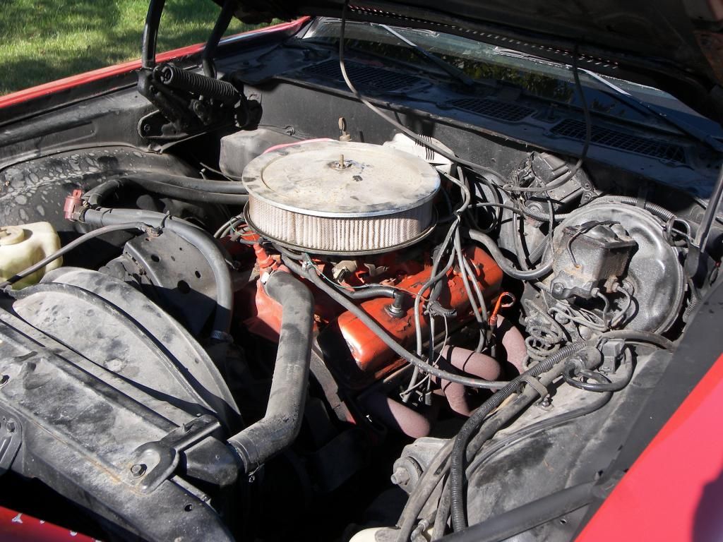

Had the original 350 (was a two barrel, now has a Q-Jet) in it. It's sitting in the garage on a stand.
http://i221.photobucket.com/albums/d...7/100_1259.jpg
