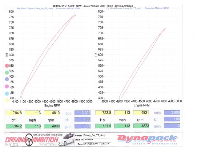

Easy to make big power with a forced induction LS engine. The TT 402 in my last car made well over that with a 4L80E and 9", and the boost level was at 14 psi. At that boost level you do not need the extra head bolts. Never got a full pull due to it shutting the dyno down around 4800 rpm due to excessive torque, but I'm confident in saying it was over 700 rwhp. :yes:
http://www.camcojb.com/temp/malitude%20772.jpg
