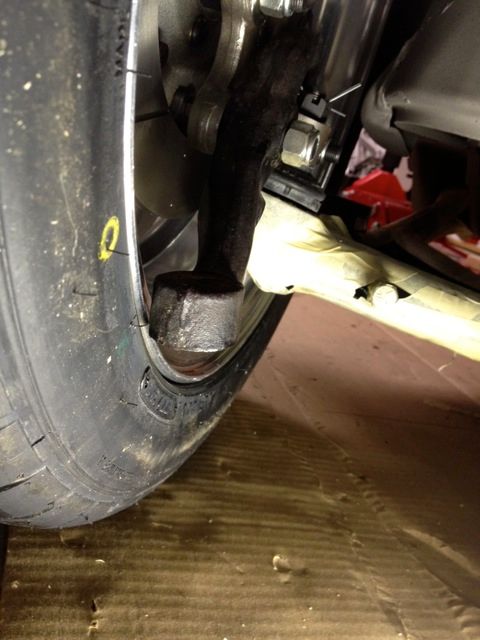

So problem #1 is the steering arm is entirely too close to the rim/tire as seen below. Too close to even get a tie-rod on. Thoughts? Ideas?

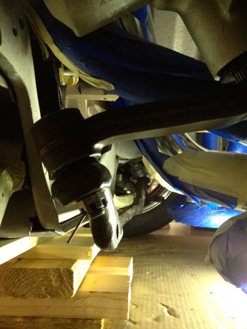

However... I'm not sure the Tru Turn drag link attachment will clear the headers. I believe the driver's side will clear based on this pic.
http://i33.photobucket.com/albums/d6...inkDrivers.jpg
The passenger's side I don't think so...

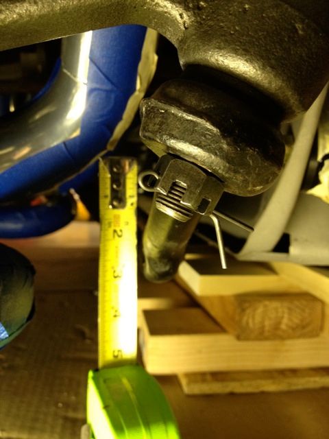

http://i33.photobucket.com/albums/d6...aglinkPass.jpg
Anybody got any specs on the Tru Turn that might help me confirm if it will clear? I'm not sure I could bring myself to cut up that tube on these Lemons headers...

I slept on it last night and came up with the following...
Space the steering arm out away from the spindle. About 3/16" would yield me a total of 1/4" clearance which is probably enough. If the tie-rod still doesn't fit I could swap to a rod end style, e.g. Baer Tracker style end which I think will yield more clearance.
If I do the bump steer kit then I wouldn't need to worry about the TruTurn center link or the potential header clearance issue. I like the TruTurn setup better though.
I also think I have the longest steering arms available. May try the shorter version and see what that does.
Smoker03 11-12-2012 01:48 PM

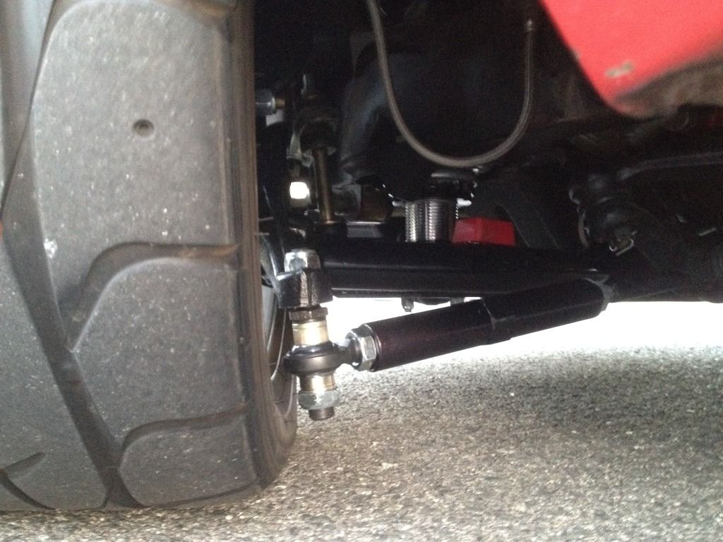

The short z28 arms will yield you some, but probably not enough. The max backspacing is usually 4.5" with 17's and short z28 arms using the ridetech spindle. The bumpsteer kit will be tough to get on since the bolt hangs down further than a stock tie rod. I would seriously look at the Tru turn as that will solve your issues. You may come close on the headers as it seems most of the fitmet was done with LS motors. Another option is to use a stock spindle and do the Guldstrand mod. Below is a pic with ridetech spindles a 17x8 with z28 arms and 4.5" backspacing and the baer tracker kit.

Vince@Meanstreets 11-16-2012 12:19 AM
Based on the pictures you posted they will not clear the truturn system.
darren@ridetech 11-16-2012 06:52 AM
The TruTurn will definitly cure your wheel clearance issue, it will also correct the bumpsteer, but does look like it will be tight w/ the headers. If you decide to try the TruTurn and it will not clear you headers, I'll take it back. Just try not to beat it up too bad.... :)
