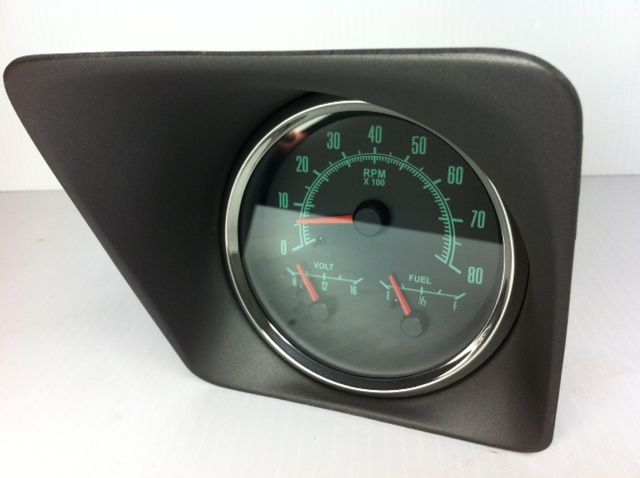

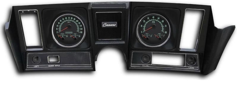

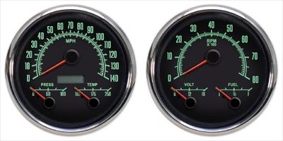

TheShopLLC.com 11-29-2012 12:02 PM
69 Camaro Gauge Inserts
http://i281.photobucket.com/albums/k...INTAGE2012.jpg
http://i281.photobucket.com/albums/k...nlit400_01.jpg
http://i281.photobucket.com/albums/k...ps4eb43fd1.jpg
camcojb 11-29-2012 12:18 PM
that's a clean setup for a guy wants the OEM look but more modern gauges. :thumbsup:
