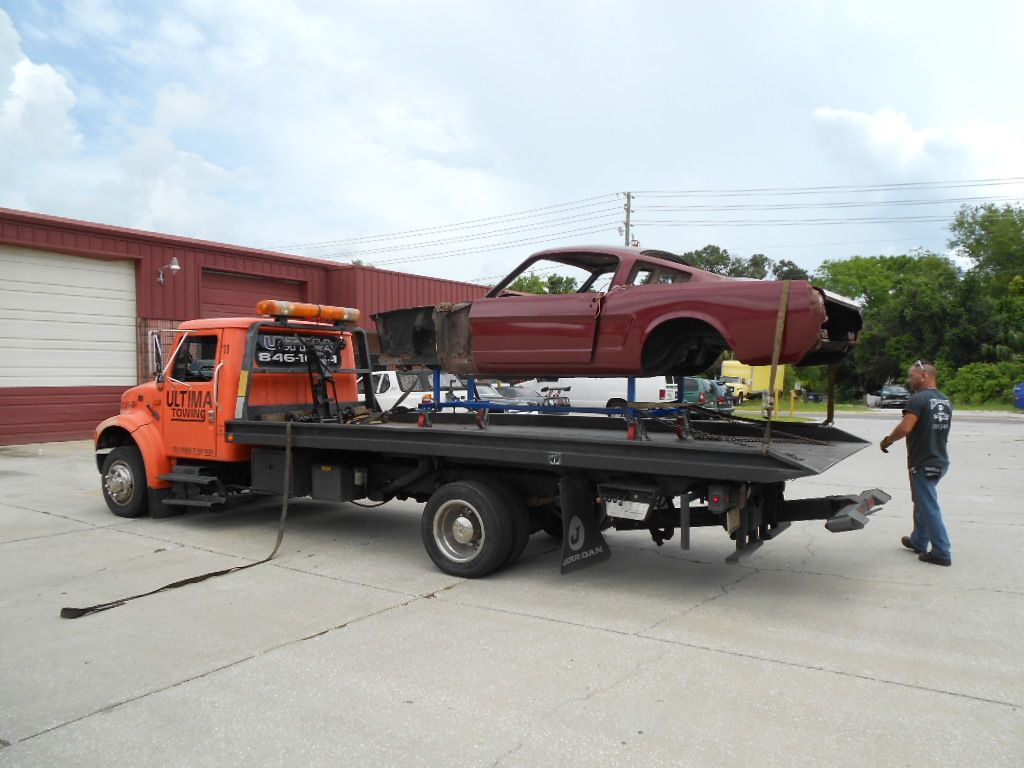

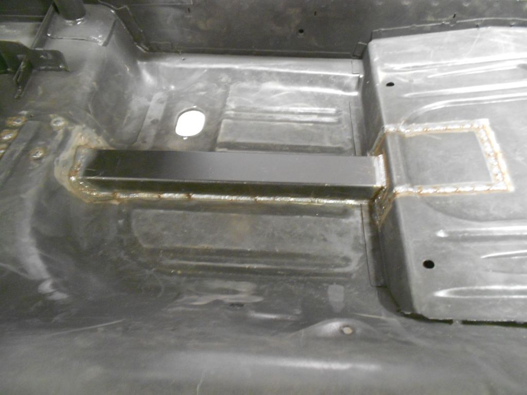

We will be installing DSE mini tubs, subframe connectors, front and rear suspension in this 1965 Fastback.
This is what we are starting with.

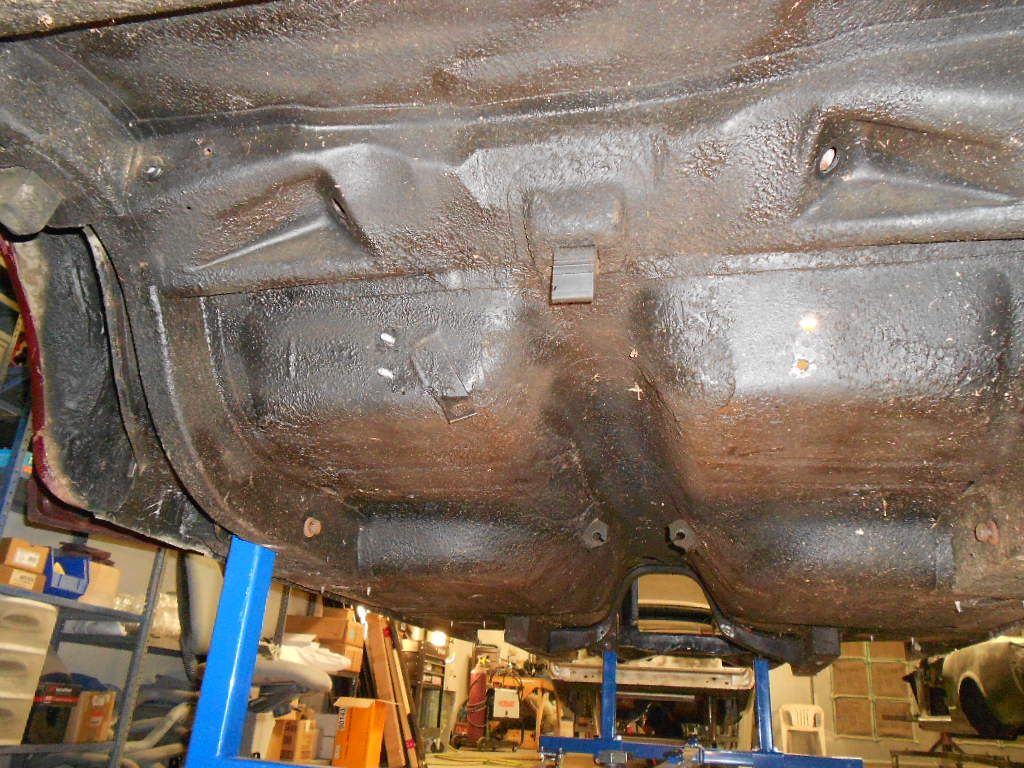

The first step is to remove the undercoating before it goes to get media blasted. I have never seen so much undercoating.
http://img.photobucket.com/albums/v3...Mustang/07.jpg

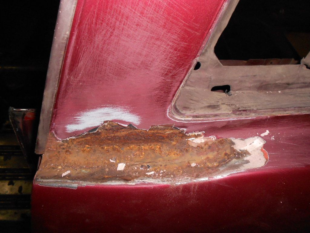

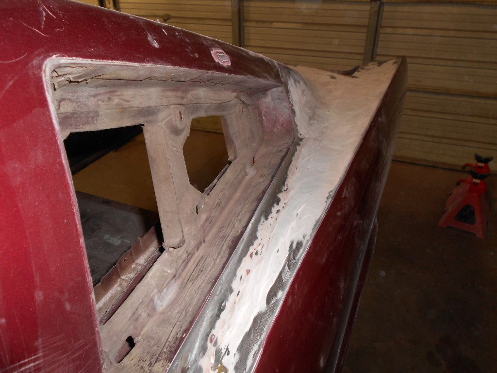

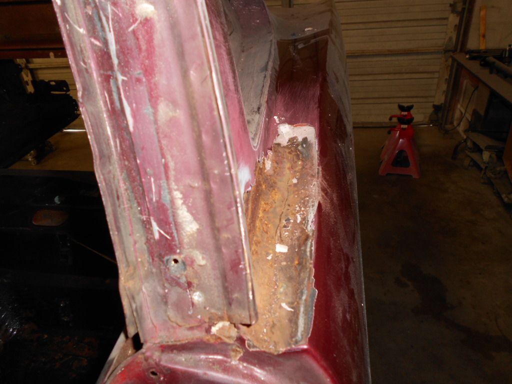

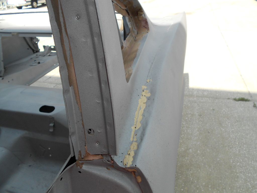

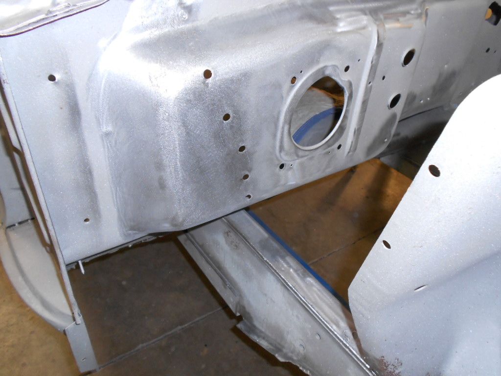

There was a lot of bubbles and paint coming off so I decided to investigate before sending it to be blasted.
http://img.photobucket.com/albums/v3...Mustang/13.jpg
http://img.photobucket.com/albums/v3...Mustang/14.jpg
http://img.photobucket.com/albums/v3...Mustang/15.jpg

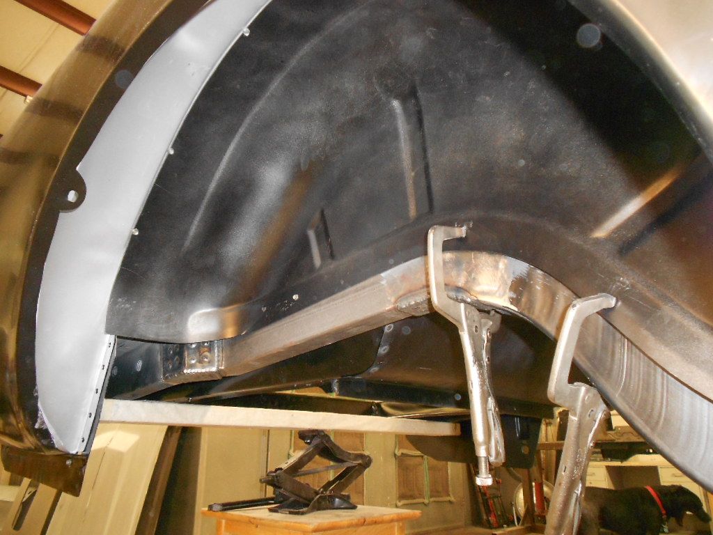

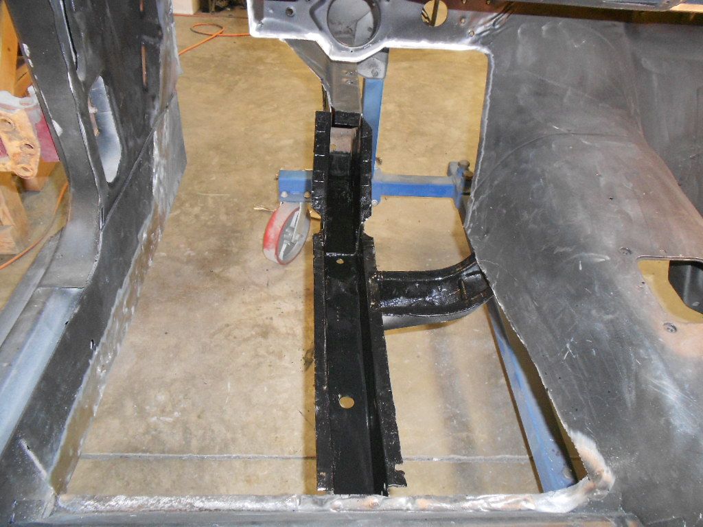

We have repairs to do before we install the DSE mini tubbs.

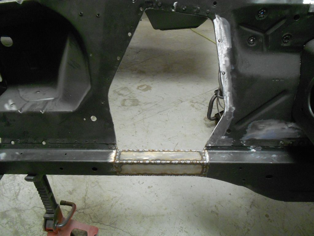

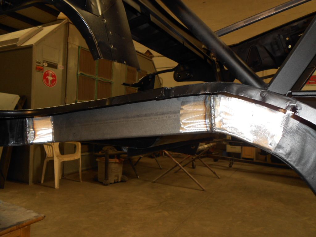

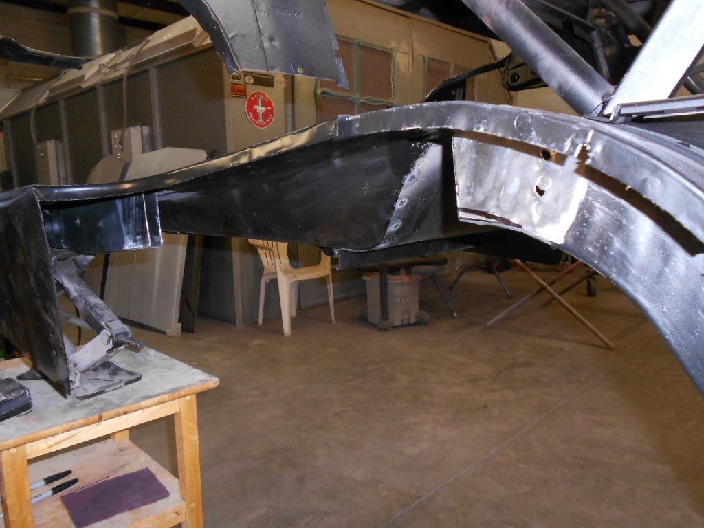

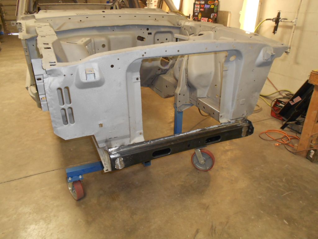

The front crossmember had been hit so we replaced it
http://img.photobucket.com/albums/v3...Mustang/31.jpg
Before we installed the new one Brian cleaned up the surface rust than brushed a coat of SPI epoxy
http://img.photobucket.com/albums/v3...Mustang/34.jpg
http://img.photobucket.com/albums/v3...Mustang/36.jpg

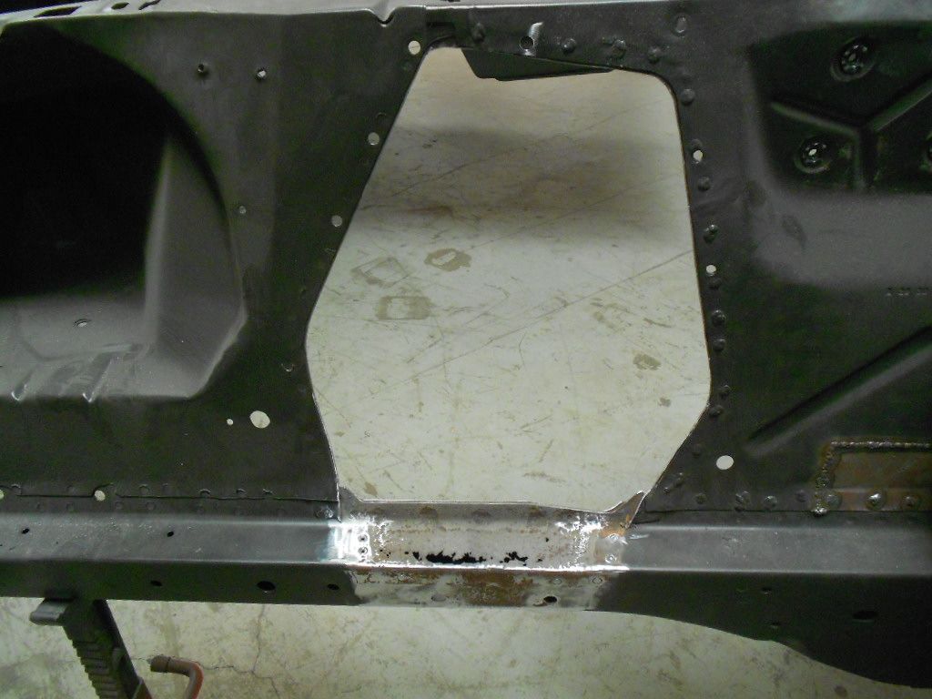

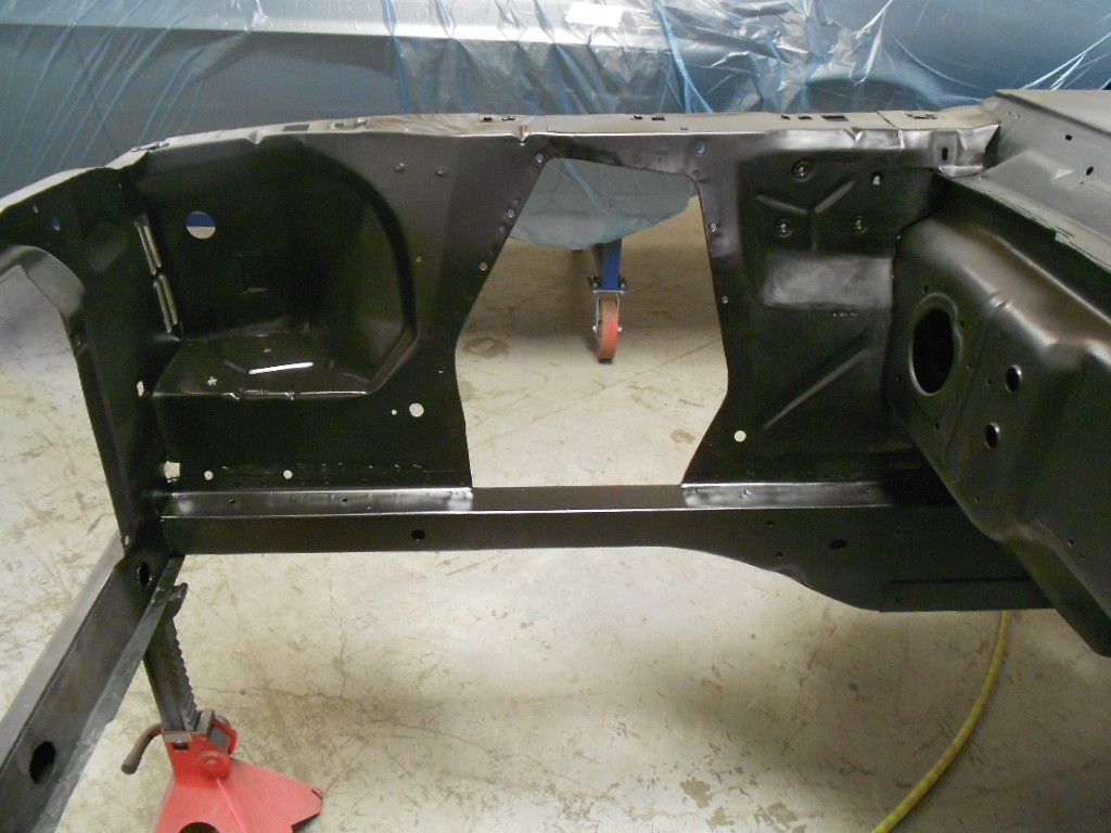

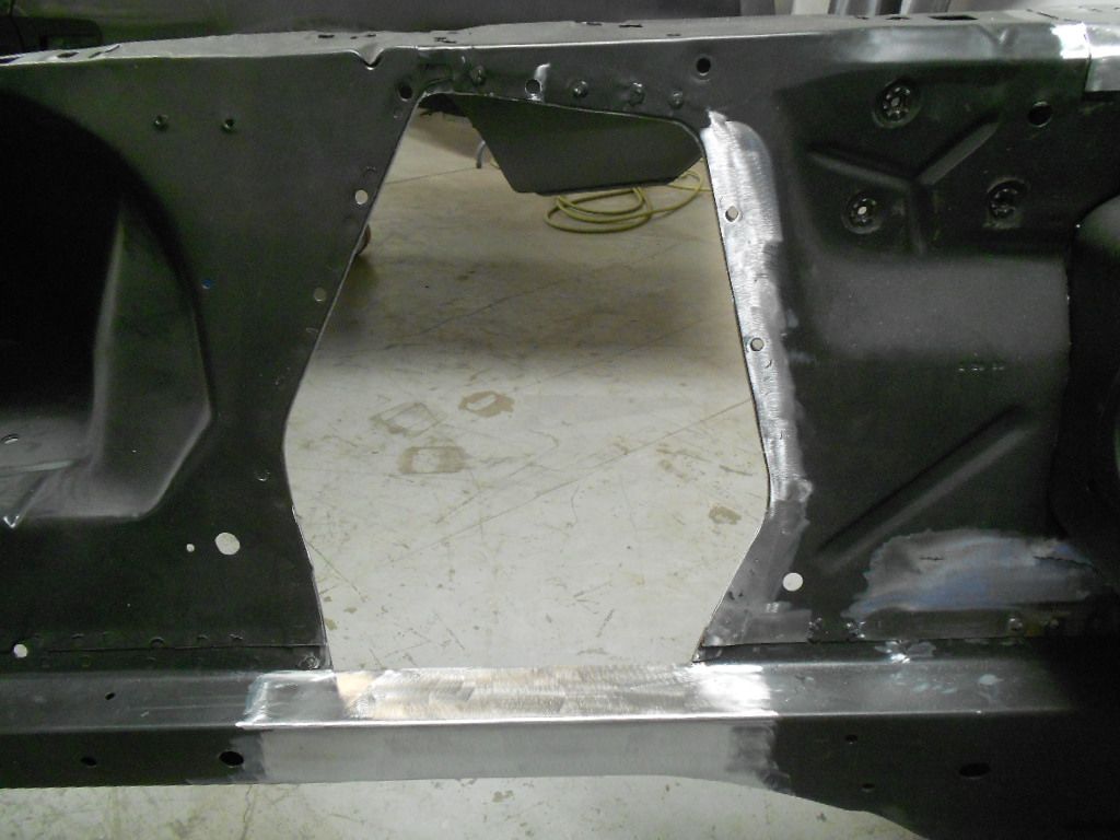

The left front apron has a little rust so Brian cut it out
http://img.photobucket.com/albums/v3...Mustang/38.jpg
http://img.photobucket.com/albums/v3...Mustang/39.jpg
http://img.photobucket.com/albums/v3...Mustang/41.jpg

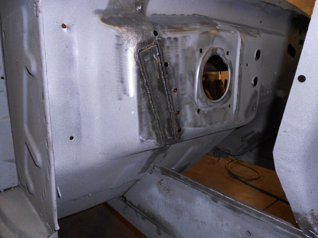

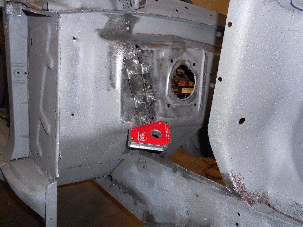

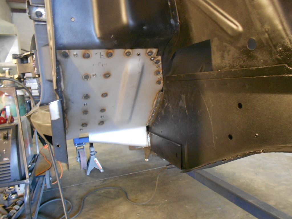

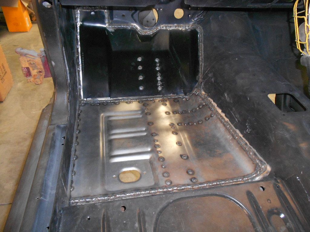

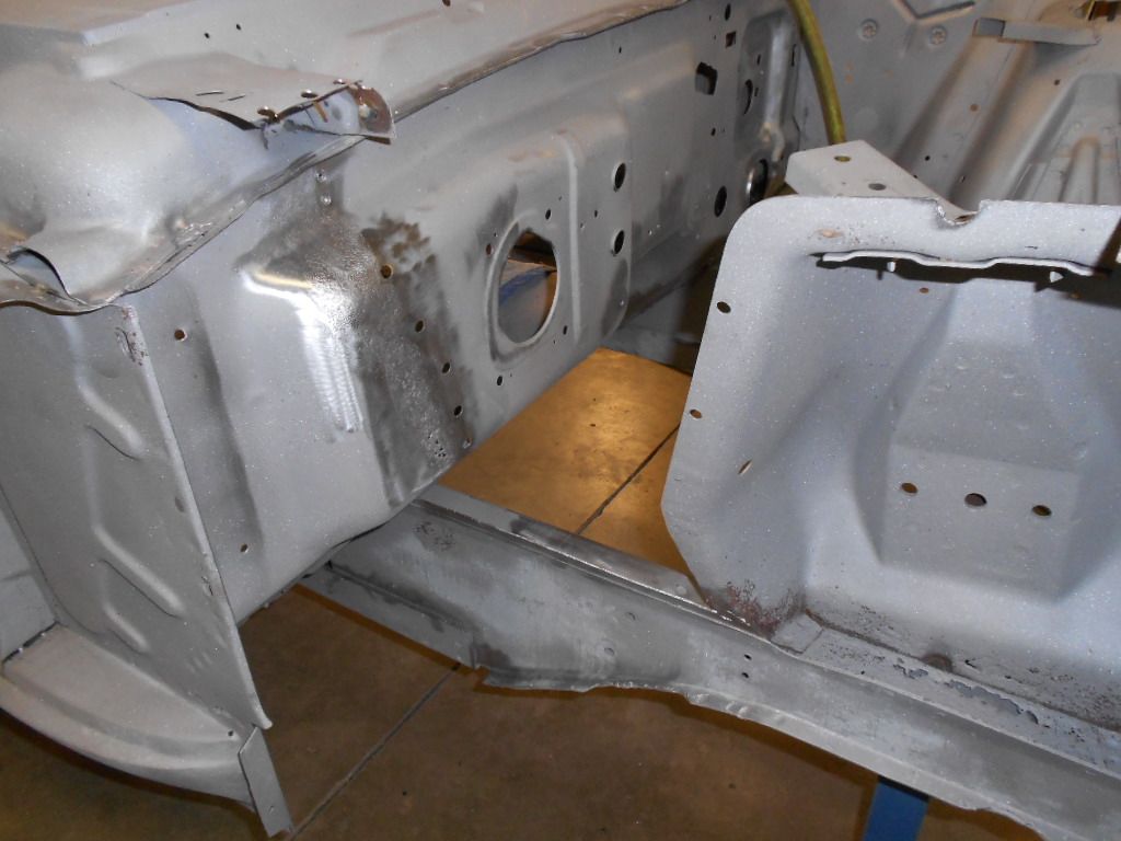

There was also a little rust on the firewall. After drilling out the spot welds on the fender apron Brian patched it.
http://img.photobucket.com/albums/v3...Mustang/42.jpg
http://img.photobucket.com/albums/v3...Mustang/43.jpg
http://img.photobucket.com/albums/v3...Mustang/44.jpg
http://img.photobucket.com/albums/v3...Mustang/45.jpg

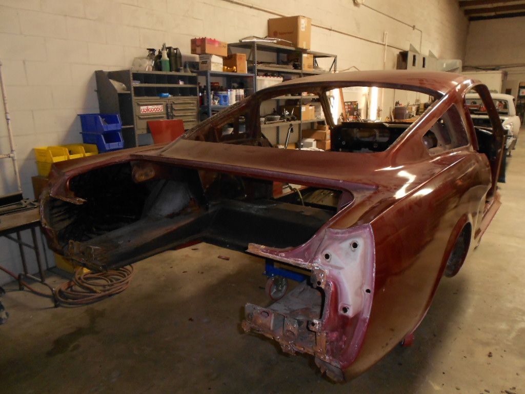

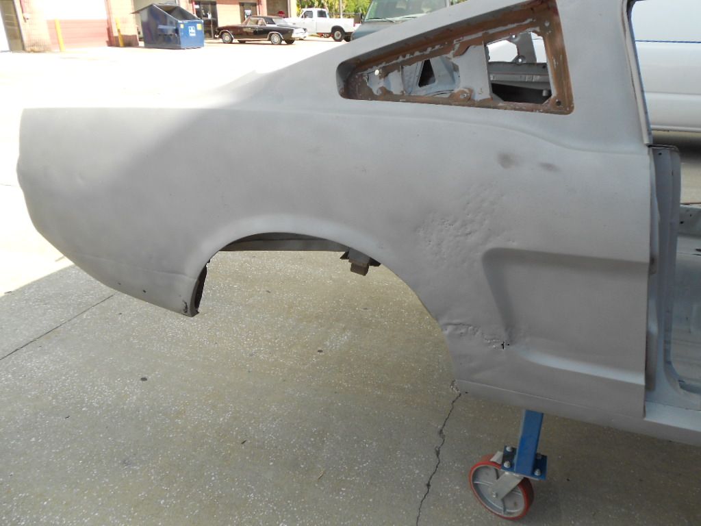

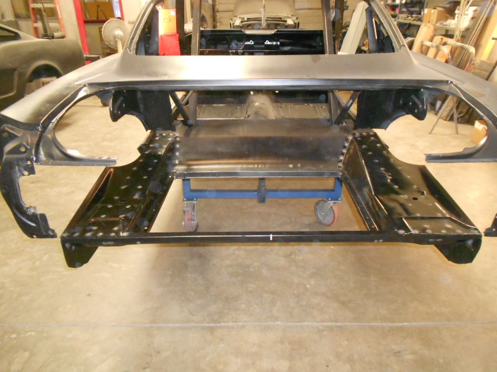

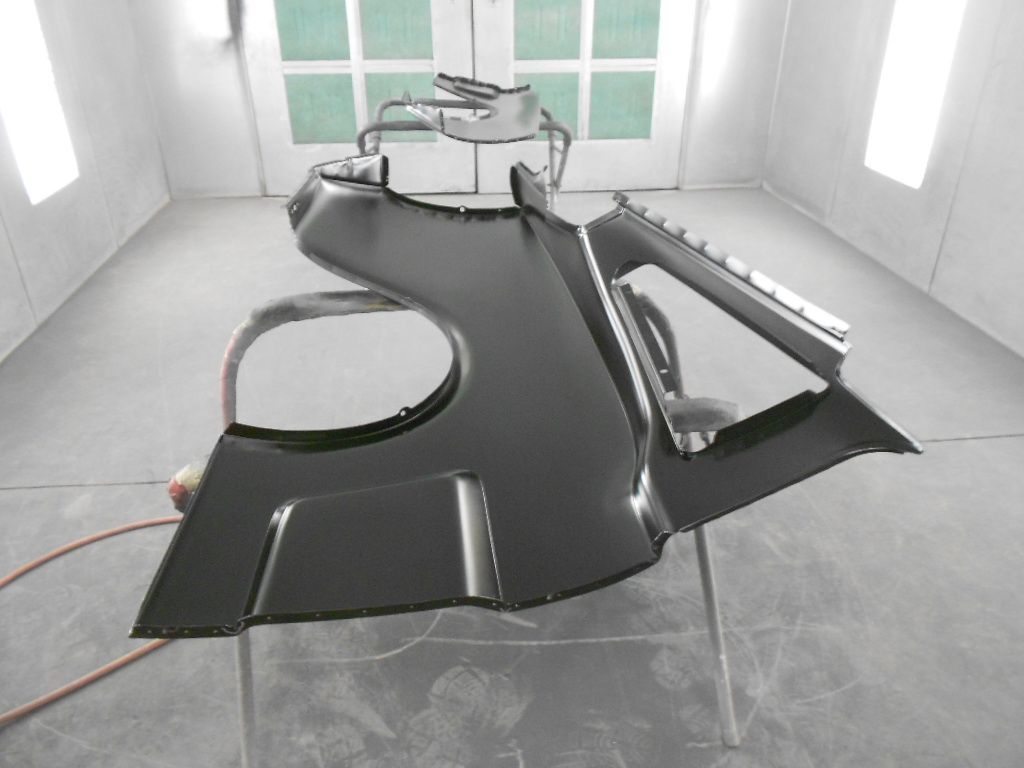

GPR 12-05-2012 06:45 AM

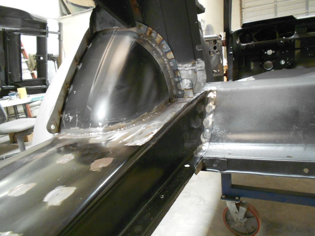

Both quarter panels need to be replaced.
http://img.photobucket.com/albums/v3...Mustang/50.jpg

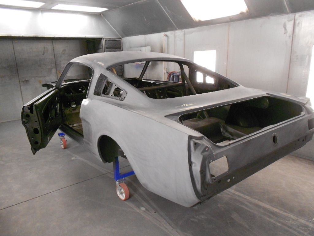

After they were removed everything was epoxy primed
http://img.photobucket.com/albums/v3...Mustang/51.jpg

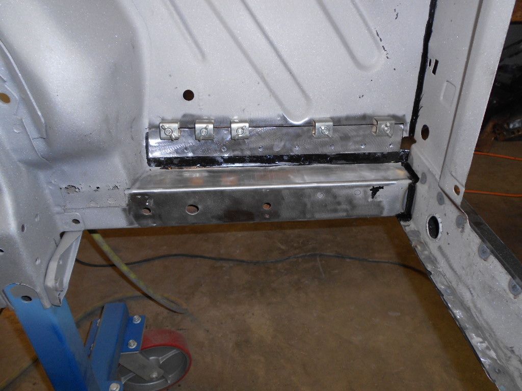

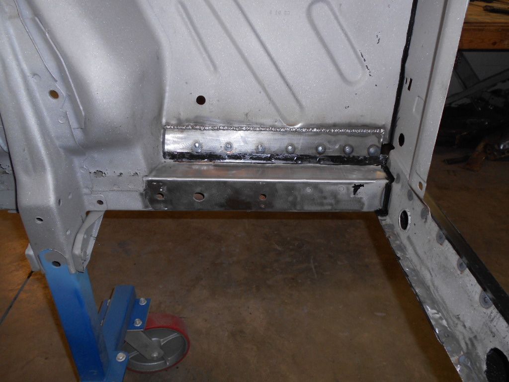

Lining up the new trunk floor
http://img.photobucket.com/albums/v3...Mustang/57.jpg
http://img.photobucket.com/albums/v3...Mustang/58.jpg
