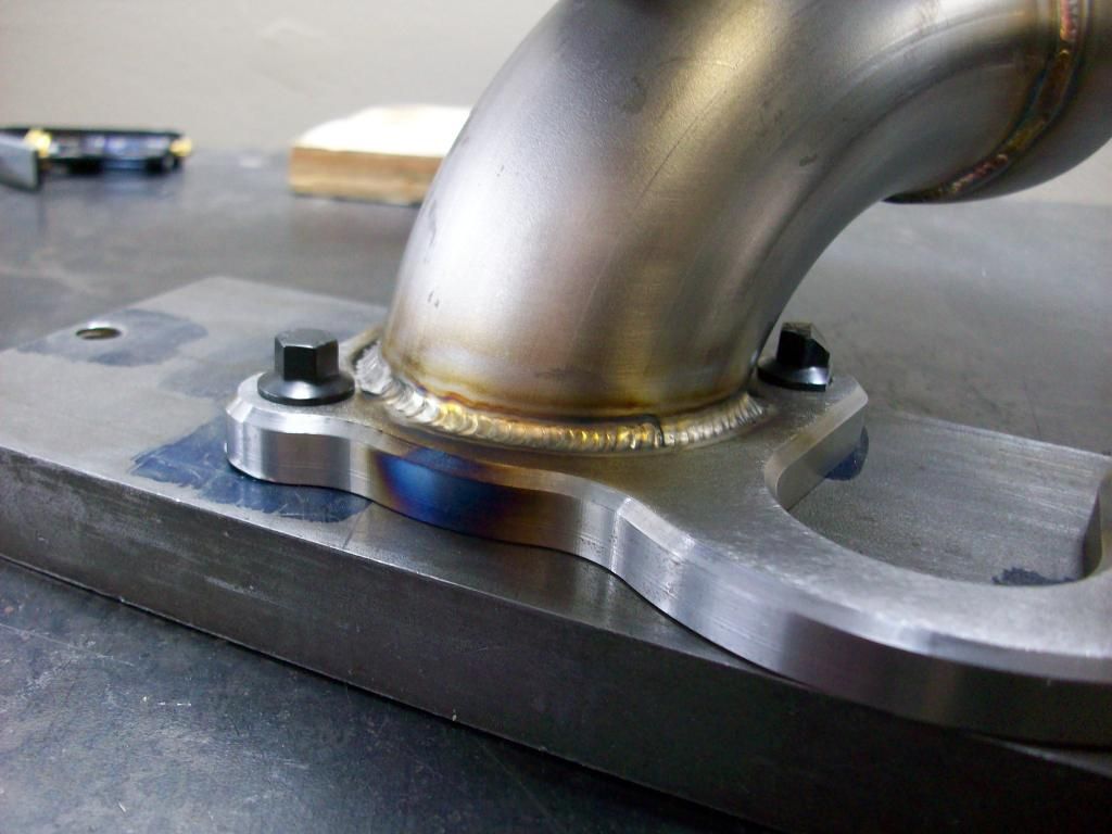

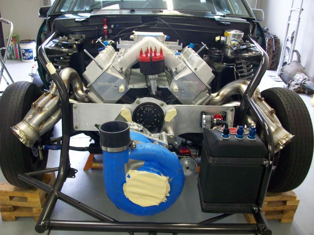

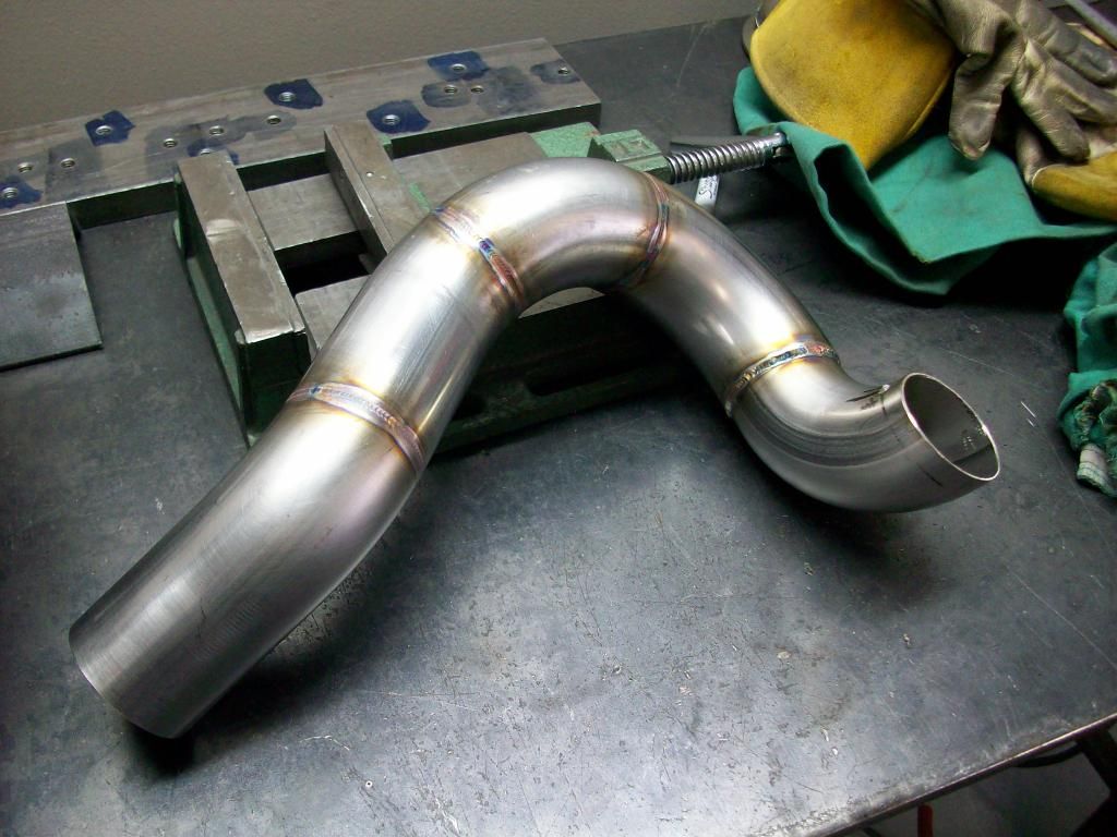

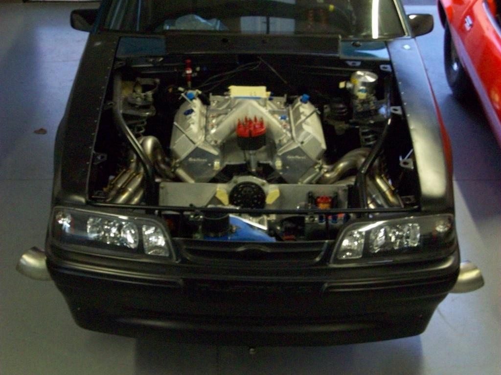

Kevin came to Big Head Motorsports for custom stainless steel header's and bullhorn exhaust. It's a SBF 438" Edelbrock SC1 Glidden head's, F3 Pro Charger and putting out an estimated 2100hp. Should be in the low seven second zone.

GregWeld 12-02-2012 03:15 PM
Yeah - That'll work!
Nice welding and workmanship as usual!

GregWeld 12-02-2012 08:15 PM
Are you purging when you're welding up the tube to the flange or is it not necessary then??

Big-Head 12-04-2012 12:04 AM
Greg, it's not necessary. With the primary tube being 16ga you won't have any problem burning through. Just make sure you use .045" filler rod. Anytime I use 18ga material I definitely back purge. Also, if I use a weld on collector I back purge because there is so much heat being placed in one area.
