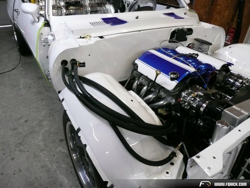

3 Attachment(s)
This is not my car but it is what I will be doing. My brother in law used black grommets and has had no issues/kinking. System works fine. Cheaper way to go, uses less fittings. If you havent ordered the kit yet just get it with longer hoses so you can keep the hoses hidden all the way up to the core support area.
RBuhr69 12-06-2012 03:53 AM
Thanks for the photos, that was very helpful. I was going to run my lines that way as well and didnt see the benefit of buying all the connections and bulkhead when it would be hidden for the most part.....thanks!

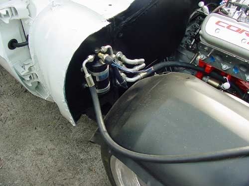

Richio1 12-08-2012 11:33 PM
I am going to do the same. Here are a few that I have gathered for ideas on how to run mine.
http://i855.photobucket.com/albums/a...7994268834.jpg
http://i855.photobucket.com/albums/a...4-yearone-.jpg
I am going to run mine like this since I still have the blower hole.
http://i855.photobucket.com/albums/a...ewallmed-1.jpg
