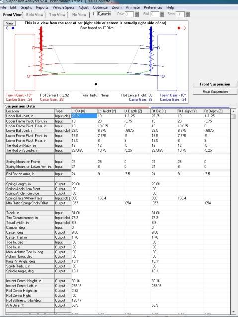

Well I've been searching the Internet for stock C6 suspension pickup points with no luck. The consensus is that they are only available to companies looking to manufacture C6 components...
Does this mean that the average Joe (aka me) cannot obtain these dimensions?

The pickup points are very easy to find. Now adjusting them to fit your vehicle is another story.

How about this
http://i304.photobucket.com/albums/n...onanalyser.jpg

I could really use the C5/C6 rear pickup points if anyone has access to them.

Download the free version of Suspension Analyzer v2.4.
Open the file for the C5/C6 corvette as seen above in post #4.
Press the button on the right middle of the screen named "Rear Suspension"
And you will see the rear suspension data listed in the same display as shown in post #4 above.

I have been told the pickup points are not accurate on the performance trends software.
