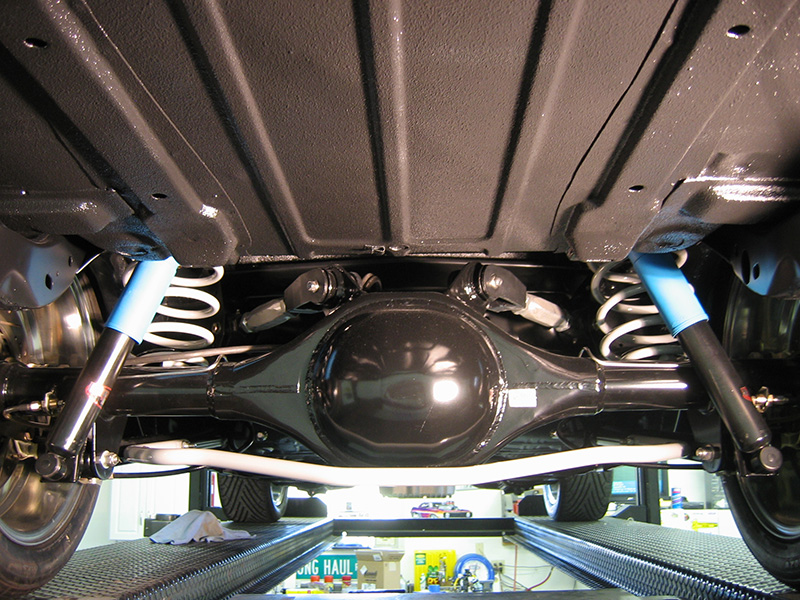

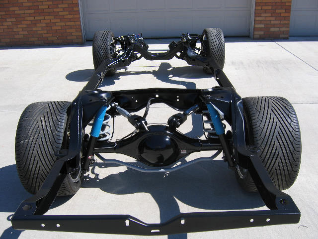

It was a 64, but I didn't hear he welded it. I thought it was a Hotchkis bar, but John may have custom bent one for him, since they're good friends.
http://camcojb.com//temp/mal188.jpg
http://www.camcojb.com/temp/malitude 258.jpg

Thanks for posting the pictures! That car got a lot of coverage in PHR. That is where they showed him narrow the sway bar. I just dont remember the details.
