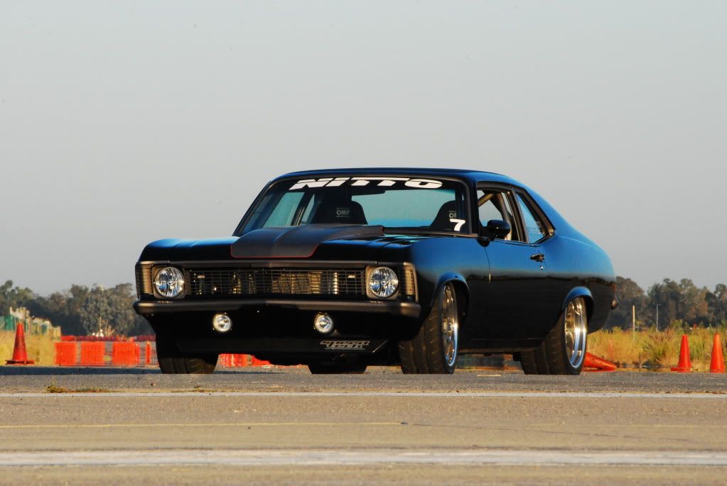

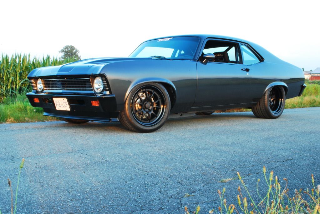

So if your going to use the AFX Spindles why wouldn't you look at the complete offering from Speedtech? it is a complete proven system that is easy to install and in the same price range as what you have mentioned

Hey Blake, First off You guys built a couple of my favorite Novas. I have looked at Speedtech and it does look like great stuff, but honestly I am a DIYer and on a budget. I can weld the little tabs on my rearend for the CA/Ridetech systems. Speedtechs torque arm looks like it is over my skill level to weld the brackets on, so I would have to farm that out (no one around here will do it) or buy a new rearend driving the cost up and up. t looks to me like your systems are quite a bit more, which is OK, but I am on a budget and this isn't going to be an all out competition vehicle. Same with DSE stuff, over my skill level and too expensive to have the one guy in town who can do it do it. I would be all for ATS spindles and Speetech arms tho...
