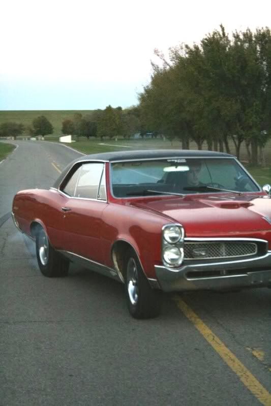

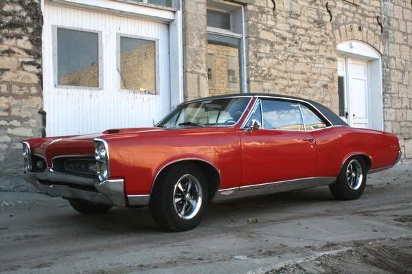

One of my favorite pics from the photoshoot day.
http://i279.photobucket.com/albums/k.../GTO/gto31.jpg

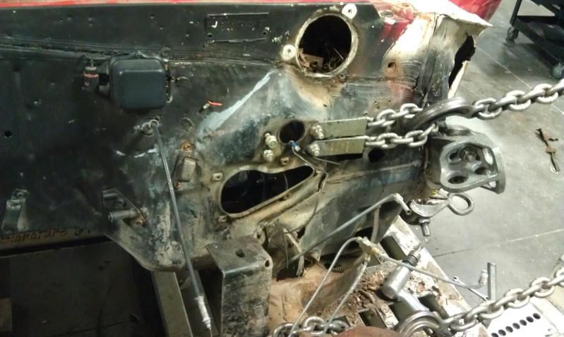

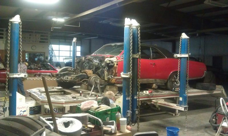

Through inspection i realized the frame was bent, BADLY. The firewall was wrinkled, The toe board was wrinkled, and the steering column was collapsed. Fast forward a couple years, and a couple of rental houses later, i finally pulled the engine, sold it and bought a new frame, and a boxing kit from a guy online.
After that it sat for another 2 years rotting away. Eventually i got a job at a body shop where the boss happened to be VERY into old muscle cars. Even though he doesn't understand why i wouldn't want to make it look like it rolled off the showroom floor in 1967, he towed it to the shop for me so i could fix it. :hail:

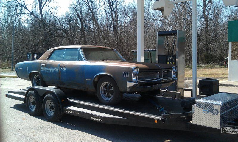

Picked up a 1966 LeMans for a donor car for the front end mainly.
http://i279.photobucket.com/albums/k...27982754_o.jpg

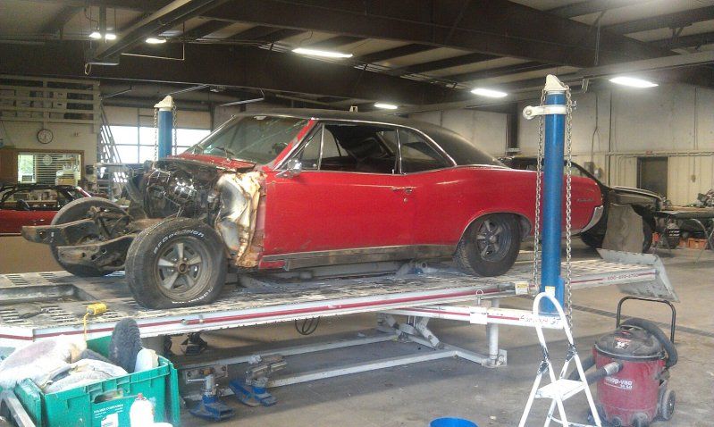

On the frame machine
http://i279.photobucket.com/albums/k...79811328_o.jpg
Set-up to pull the cowl over and forward
http://i279.photobucket.com/albums/k...20830397_o.jpg

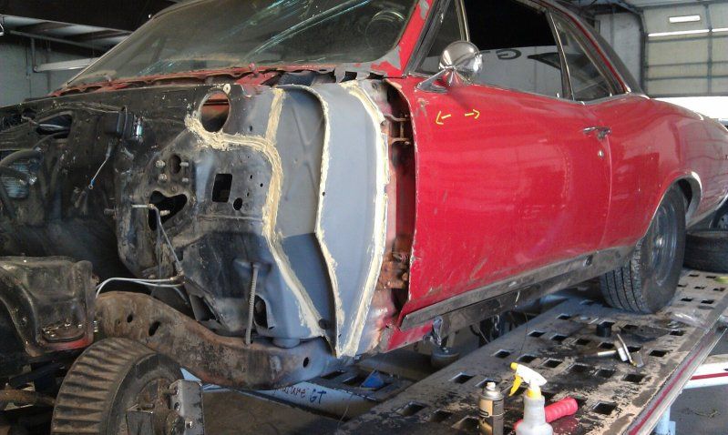

Getting everything straightened
http://i279.photobucket.com/albums/k...18147279_o.jpg

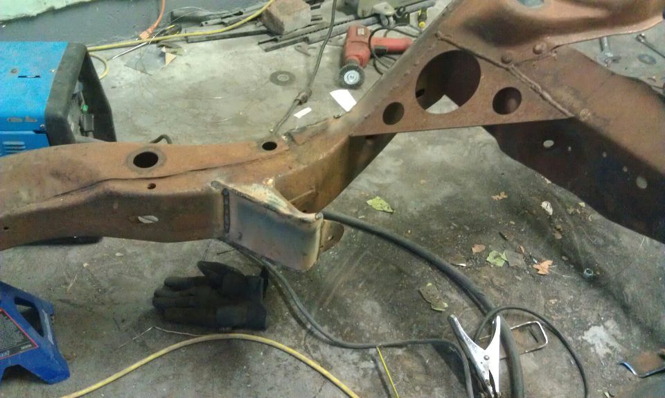

The new corner section
http://i279.photobucket.com/albums/k...35414928_o.jpg
At this point the "Damage" is mainly fixed. Its all restoration and modification at this point!
:woot:

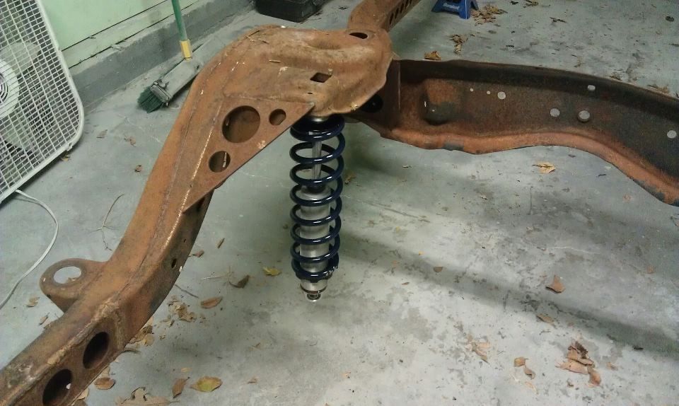

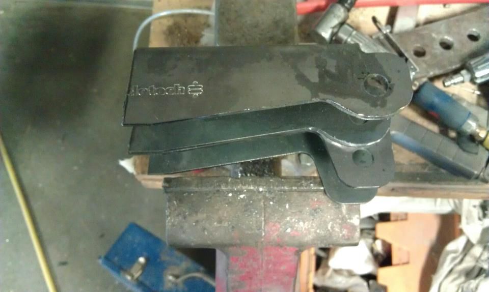

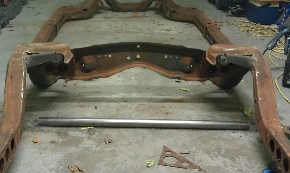

Ridetech single adjustable coil-overs mocked up. I really didnt like the factory bracing at all, and since there was no need for a spring bucket. I decided to get rid of it
http://i279.photobucket.com/albums/k...ps3982bff0.jpg

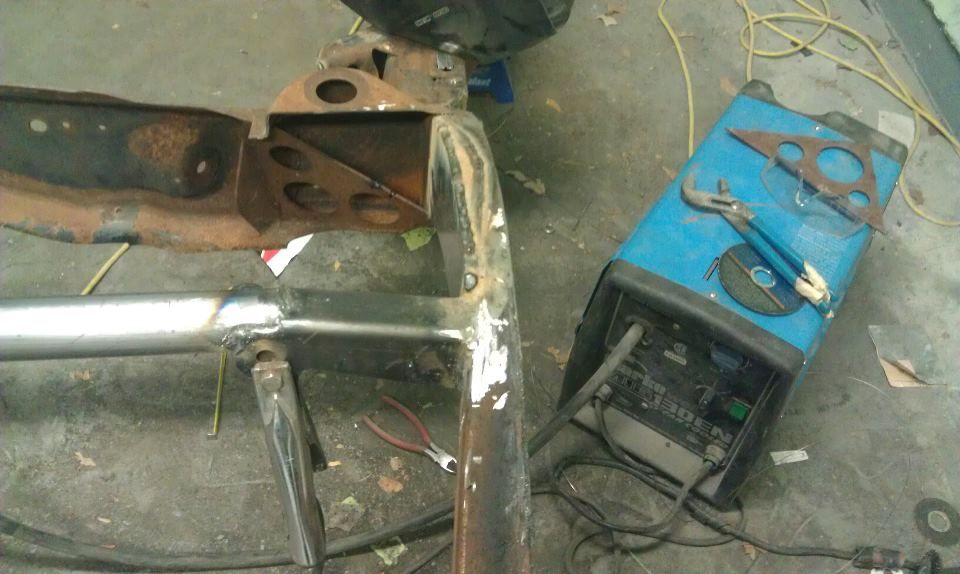

Took some universal Ridetech mounts and moved the mounting point up
http://i279.photobucket.com/albums/k...ps6ec10bc0.jpg
Mounts tacked in. I didnt change any geometry at all on the mounting point. just what they mount to.
http://i279.photobucket.com/albums/k...ps17acaa64.jpg

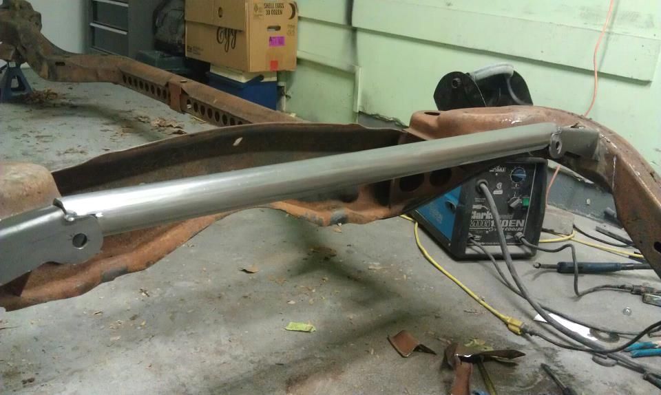

Support bar tacked in
http://i279.photobucket.com/albums/k...psbf43195e.jpg

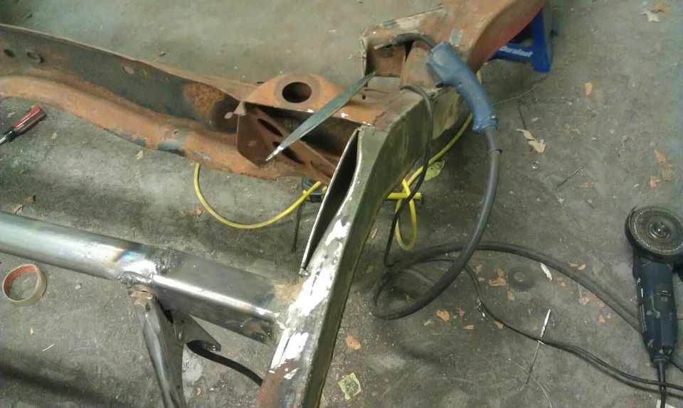

I had debated about doing this, but finally grew a pair and went for it!
http://i279.photobucket.com/albums/k...ps3128b54f.jpg

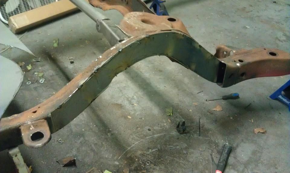

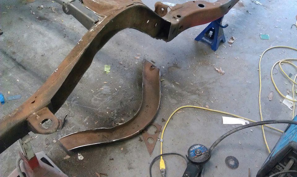

After cutting the factory spring bucket out, this chows the nothing that is in the frame, which i finished boxing in
http://i279.photobucket.com/albums/k...psf029c3f8.jpg
Basically all done, have a little bit more to do, but not picture worthy
http://i279.photobucket.com/albums/k...ps5c196cce.jpg
