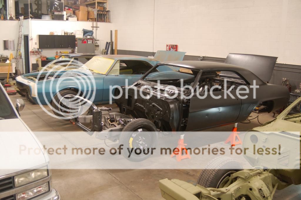

I purchased this '69 Camaro from a buddy of mine John Poggiolo. He purchased it off Ebay from California. It is a super solid car but did need a pass rear quarter due to damage. The car has been at Sled Alley since May so it is well underway. It is fun to be making parts again.

In John's Garage
http://i439.photobucket.com/albums/q...psda465053.jpg
In my driveway with my other '69 that I just sold to a GM exec. for his 19 year old son.
http://i439.photobucket.com/albums/q...psb68e7d12.jpg
The '67 behind the black Camaro is Gordon Rojewski's orginal paint '67. The black pimer Camaro is mine

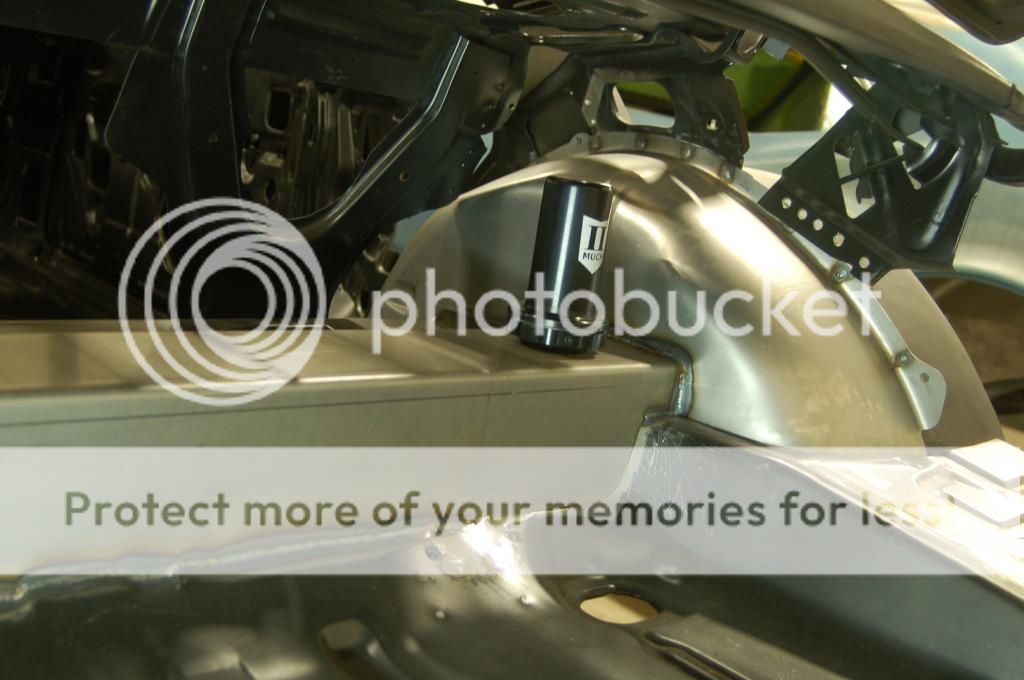

Guys I had an idea of moving the dry sump tank back in the cowl. With some measuring and a cutoff wheel it fits. It all fits inside the fender. Working on getting mass back in the car. I also mounted a C-6 brake booster and master. Matt filled the firewall. I really like the guys at Sled Alley. Top Notch.
http://i439.photobucket.com/albums/q...ps8ac1b505.jpg
http://i439.photobucket.com/albums/q...ps3b402a06.jpg
http://i439.photobucket.com/albums/q...ps74927ca3.jpg
http://i439.photobucket.com/albums/q...psb51e6fbd.jpg
http://i439.photobucket.com/albums/q...ps2c91486d.jpg
