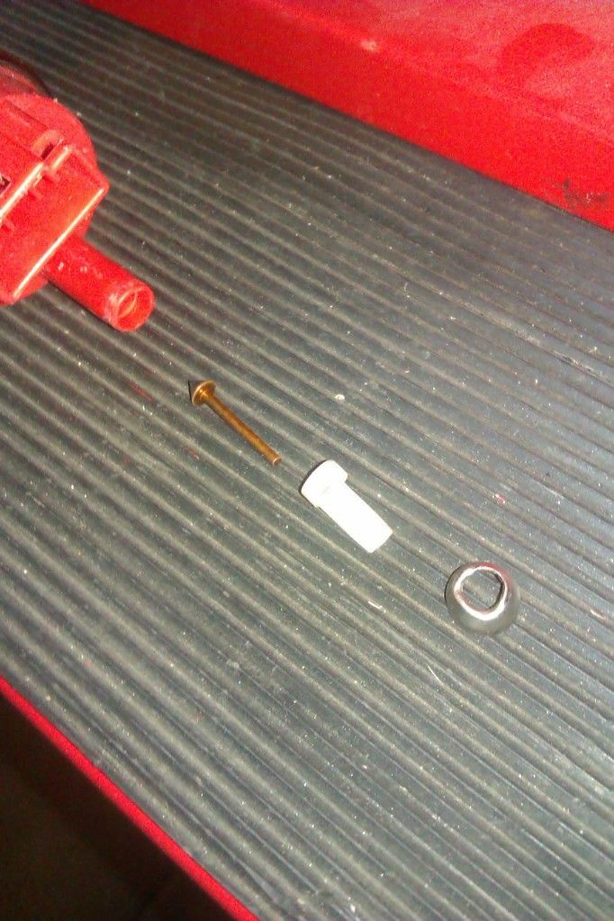

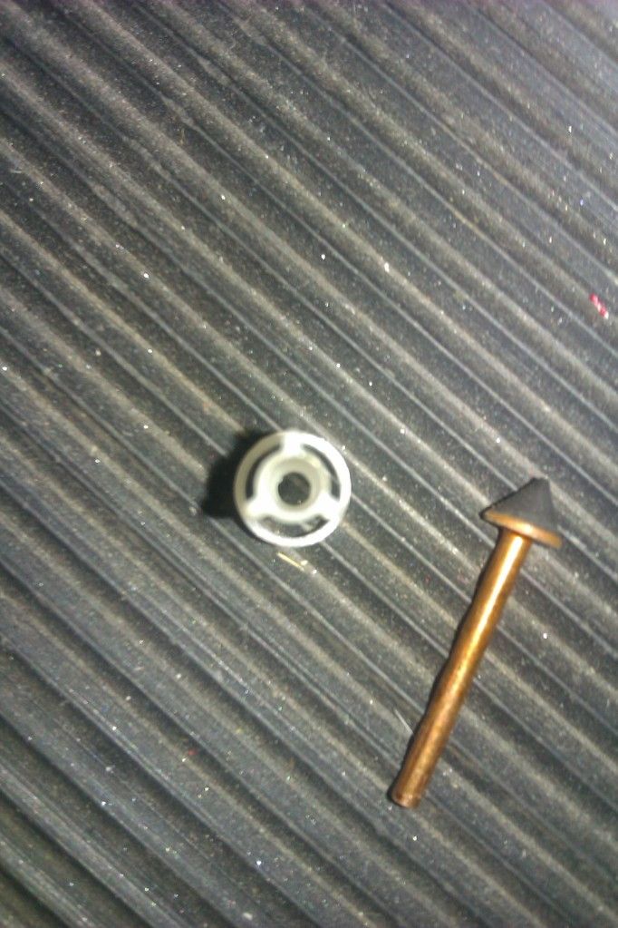

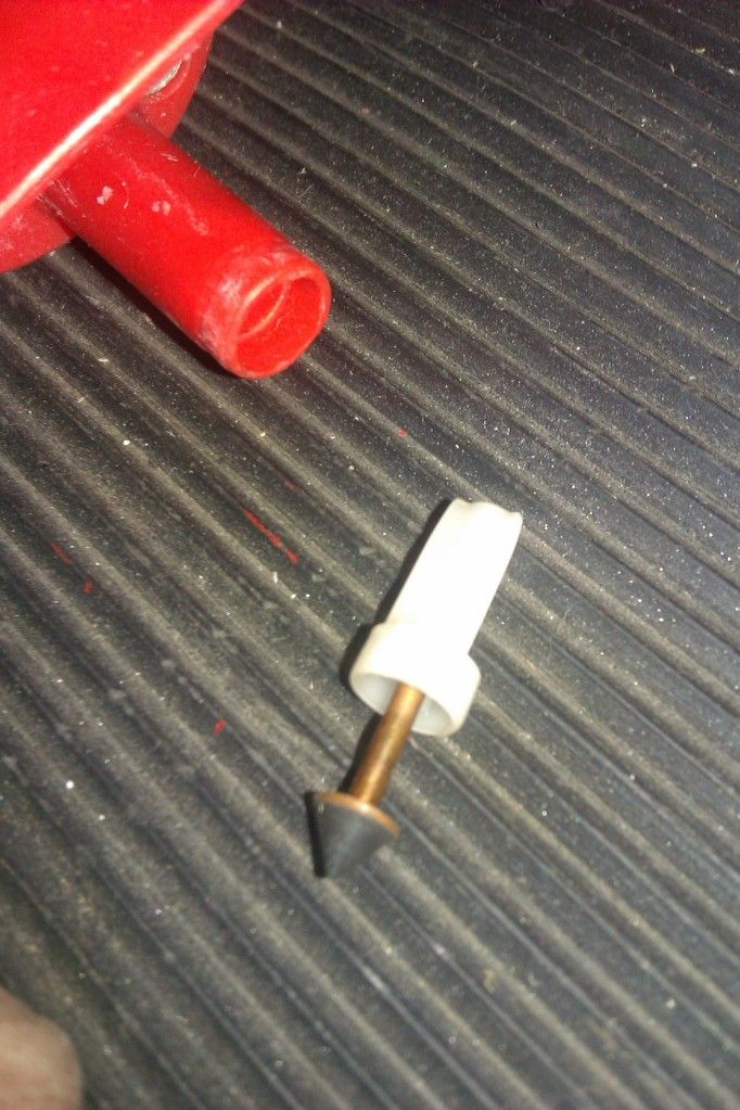

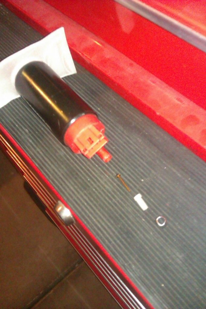

I have an Aeromotive Stealth 340 fuel pump. When I was mocking it up the silver ring popped off the outlet an a couple parts fell out. There is a little copper "plunger" and a white plastic sleeve that came out. Unfortunately Im not sure how they go back in. From what I cant tell the copper plunger thing fits into the white sleeve, but I dont know which way it goes. Any info on how this goes back together would be greatly appreciated.

SuperB70 01-06-2013 03:20 AM
Looks like the one way valve came out. I recall there should also be a spring, but it's not used on every pump model. When pump is shoted down, the pressurated fuel presses the plunger against the pump frame closing way the pressure going true the pump back to tank.
You can run with out it but it maid be little harder(longer) to start up cos you dont have already pressurased fuel in fuelrails. Or you can run pre-pressurising relay/ or if running aftermarket injection, you can chance setting from ecu to run your fuel pump.

do you know what order these parts go back in by chance?
