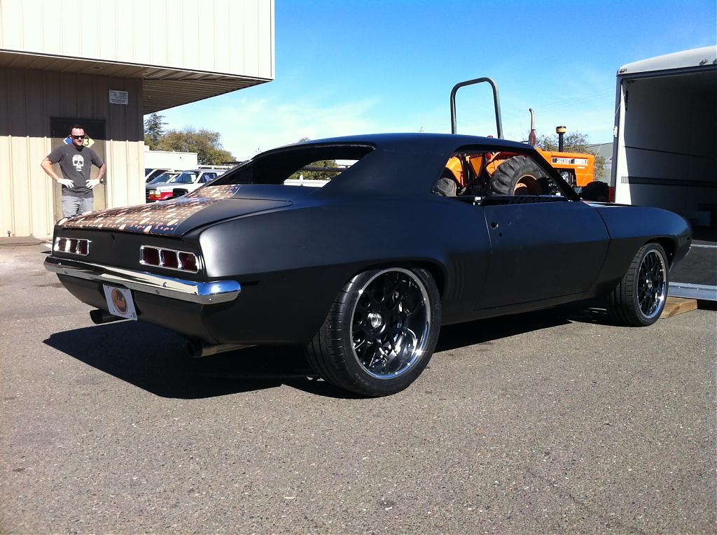

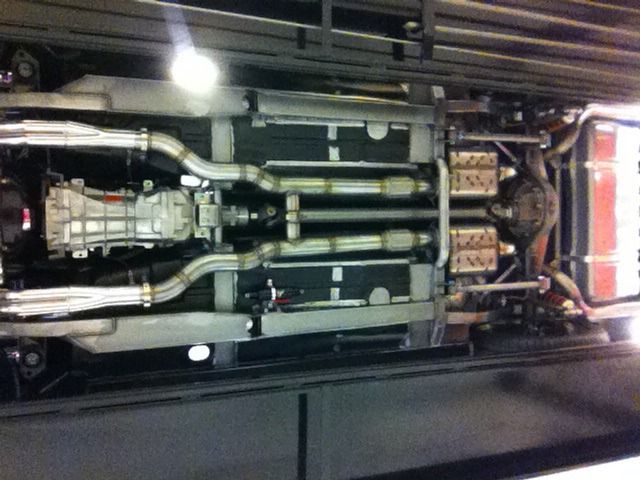

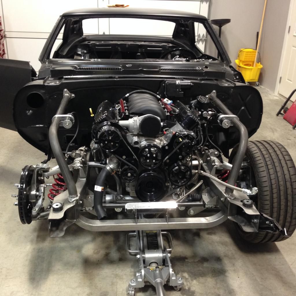

Hi guy this hands down is one of the best sites I have come to. Everyone seems very friendly and "full" of information.Lol I have been a 1gen camaro owner since 16 and never imagined doing a build like I am doing till after the kids were done with college but..... as we all know men have the patience of a 2 year old. Well here goes started off with a new dynacorn body and all sheet metal didn't want to deal with the whole rust thing. For the frame I went with the complete Art Morrison front chassis with all the c6 stuff. In the rear I went with the 4 bar and 9" set up. Started off with the Strange coil over but have already upgraded to the double adj JRI front and rear. For the brakes I went with the Wilwood 14.5 all the way around. 6 piston up front and 4 in the rear. Yes 14.5" not 14.25 funny story about that later. For power I went with a GMPP 525Hp crate Ls3 and a Tremmic 6 speed trans. I figure if I need more power later I can upgrade from there. There is a lot more done but I don't feel like writing a novel today just wanted to say hi and introduce myself. The car is being built by not only a good friend but I think one of the best builders around Zane at Cotati Speed Shop(formally Creative Concepts) in Santa Rosa Ca. He has gone over and beyond to help me with my dream car. If anyone was at SEMA it was the unfinished car in the Flowmaster both. I will put pics up as soon as I figure out how!!

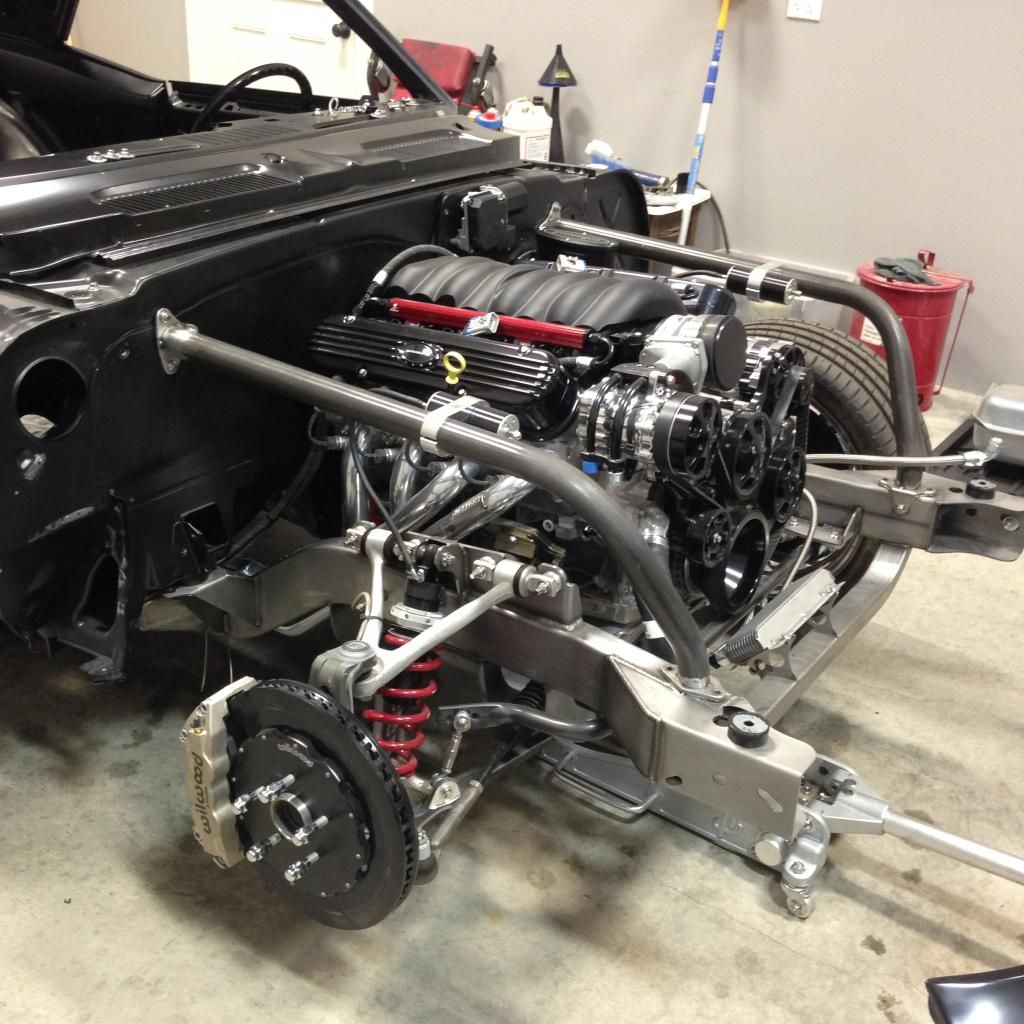

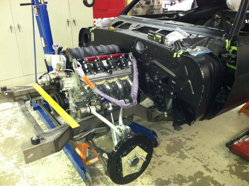

2 Attachment(s)
Attachment 38097
Attachment 38098
RdHuggr68 01-08-2013 04:45 PM
Welcome to Lat-G what headers are you using. :lateral:
Kevin

RPitts 01-08-2013 10:15 PM
Thanks guys! I have about 100 pics but can't figure out to get the sizing thing figured out! Going to have to ask my 15yr. lol. The headers are from Flowmaster they are a proto type they sent us to see if they would work with the Morrison front end.
