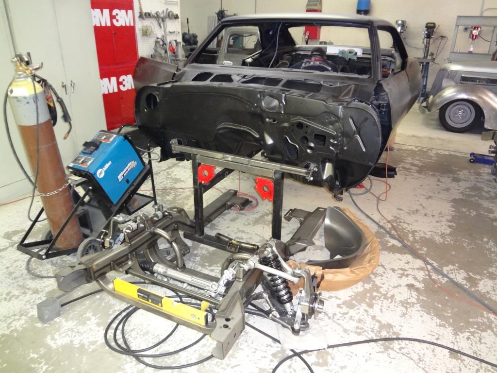

Our latest build is a Pro-touring 1969 Camaro for Rob and Jennifer Pitts (RPitts https://lateral-g.net/forums/show....php4?t=39801). We started with all brand new sheet metal from Dynacorn. Art Morrison front, and rear clip with center subframe connectors. Mini tubbed to fit the 20x11 Billet Specialties wheels with a 315/35ZR20 Michelin tire in the rear. The rear clip features a triangulated 4-bar with 9" housing. The front clip features full Corvette C6 suspension components. Using Wilwood 14.5 Rotors on all 4 corners with a 6 piston in the front and 4 in the rear. Front wheel is a 19x8.5.

Cotati Speed Shop 01-10-2013 08:19 AM
Here is how the body was delivered from Dynacorn
http://sphotos-c.ak.fbcdn.net/hphoto...56969450_n.jpg
Got the DSE Mini tubs welded in.
http://sphotos-b.ak.fbcdn.net/hphoto...90638897_n.jpg
