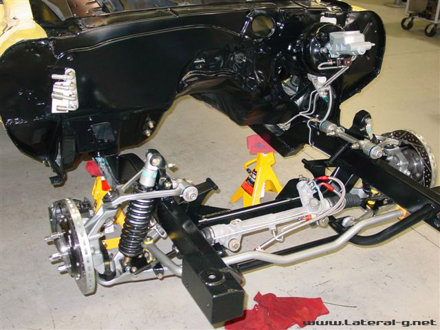

Mine was a power rack. Thought it was off a Mustang, but not positive.
http://www.camcojb.com/temp/zl11.jpg

Thanks Jodi...something looks different . cant put my finger on it.

Looks like the same rack DSE uses. I think Jody is right, off an 80's Mustang.

So I take it a DSE unit won't work? I bought the subframe new from a friend, who got it straight from Wayne. I think I had to buy the rack from Wayne, no idea where he was getting them modded, if that is indeed the case.
